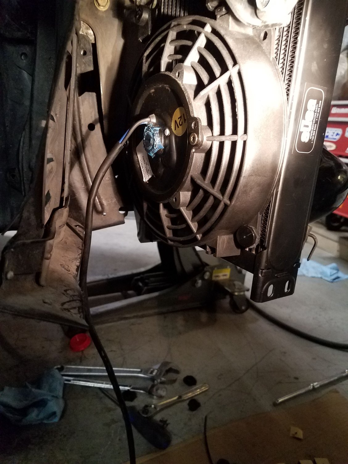

- Weather cooled down and I went to a 6.5qt wet sump pan, MAP B&M oil cooler, and 20w50 oil and the car took so long to get to operating temp, I thought the sensor was broken LOL. Once it did, temps were still going higher than I'd like.
- Swapped to 5w40 oil, a MAP Setrab cooler with an 8" fan. I ran Buttonwillow during June. I don't remember seeing temps above 250ish at all. I ran MRLS in November. Obviously cooler ambient temp, but it stayed down below 240, according to my video. The fan was added because I needed a way to cool the oil in staging (AX) and after HPDE sessions, when I'm parked. With the thinner oil, it got up to temp much sooner. It took so long before, I could let the car idle 5mins, drive to my GF's house across town, and STILL be a hair above 140*.
I will never run another cooler besides Setrab or better. The upgrade was WELL worth it. The fan works awesome. Also, the MAP kit bolted right up, no problems.

I've got an AMS kit on my car, my next cooling mod I'm looking to do is add a fan like that. Been looking at Spal and Setrab fans. I probably won't do it until I get a good idea of how it's doing with the cooler alone since I haven't gotten on track since putting the cooler on.
