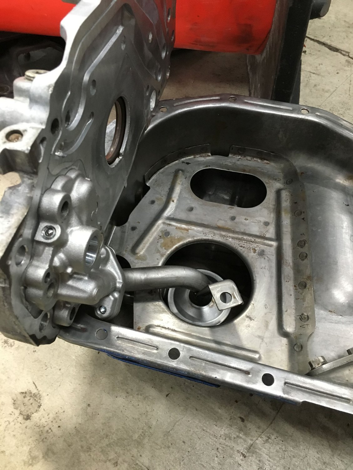

Has anyone considered dropping the pickup lower in the pan? I still need to assemble my front case and pickup to the loaner pan I got to see where it sits normally but if the sump is being altered I'd think it'd be advantageous to drop the floor of the sump and the pickup an equal amount as well.

lowering the sump flor will give you extra oil capacity but will do little for the main problem and that is oil drain back to sump in right hand corners.. of course, with extra oil capacity you have more time untill you get problerms with oil pressure..

I don't know that I'd want the pan to sit any lower. When I was test fitting ours, there wasn't a whole lot of room to drop it, especially if you run a splitter or undertray. Then there's the issues of curbs, of course.

I don't mean anything crazy but even being able to drop it 1" would add a good amount of capacity.

Maybe. I'd have to go find a stock pan or my old notes to see how far we brought ours down. To be honest, I don't really remember.

IIRC AMS pan is 1/2 inch lower... I wouldnt be comfortable with more..

So I threw together my oil front case, pickup tube and a pan. Has anyone measured how close the pickup comes to the bottom of the pan? On my mock up setup the pickup is nearly pressed against the floor of the pan.
Can't really get any great pics of it unfortunately.

The closer, the better.

Not necessarily. You need space to get the oil in there lol. I think the pan on my car that Chad built has the pick up 1/2" off the bottom.

If this is how close it is from the factory, that's kind of alarming. I would think 1/4-1/2" would be acceptable. It feels like it's under 1/8" right now.

Well, I didn't mean touching But the closer it is, the longer it picks up oil.
disclaimer: within reason.

what set up? oem?

The racefab pan moves the pickup. Dont remember if its moved down, but I think it is moved to more centered location of the modified sump.

is that the one ayoustin's got pics of?
