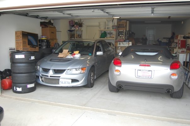

I was 2 seconds faster in the GXP right out of the box, based on relative results with the rest of my region. Then we put on the Z0K package and I gained another second.
Hmm, shall I use the sabre or the pistol today???
I've only had my Z0K GXP for about 3 weeks now, but I like it...

Are those the 275 Hoosiers in the picture, or are they the Evo tires?
