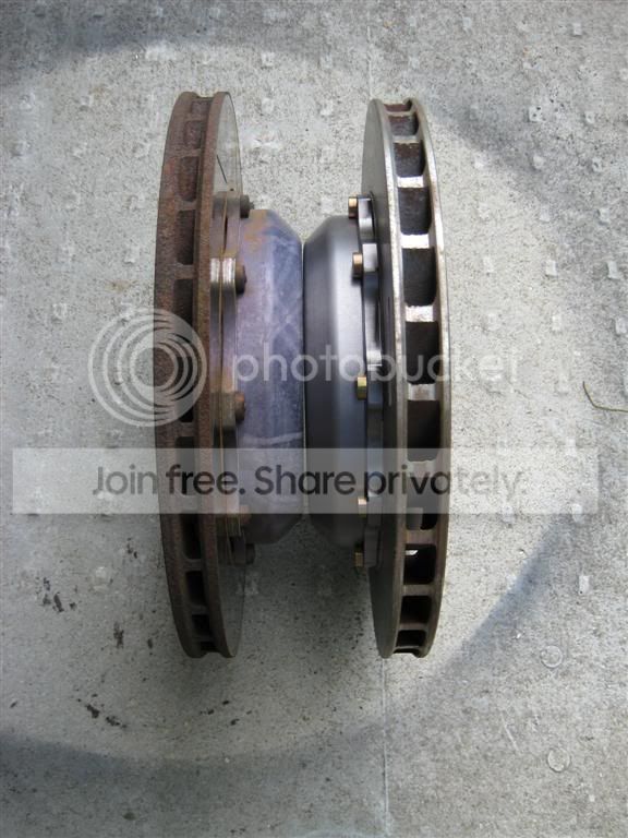

OHHHh I think I get it now.
https://www.evolutionm.net/forums/ev...or-review.html
So I guess the key here is
Thickness includes the individual plates of a vented rotor, as well as the overall dimension.
And in the case of those particular Girodiscs, the plates themselves are thinner... meh. Let me break out my electron microscope so I can round to the closest thousandth of a millimeter...

As much as I wish, I doubt the ultra lites would pass that test. Looking at how thin they are, the min thickness of the stockers would never get down to the thickness of the ultra lites. >19 year mechanic.
The pic in post 33 is of the rears, the fronts are much thinner.
