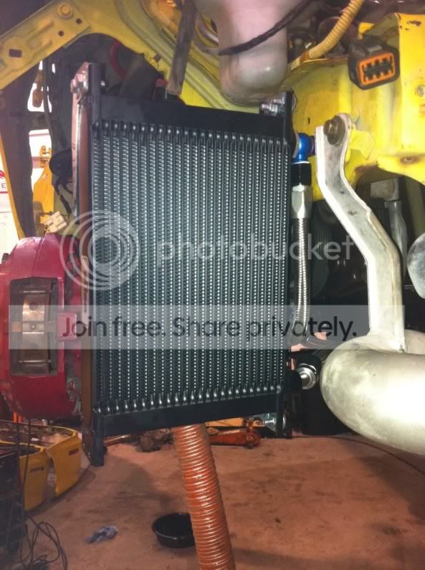

(steeling a picture here...sorry. all credit to Kidloco51)
im starting to think something like this is the best bet/easiest to set up (its his trans cooler, but you get the idea) without measuring im betting i can fit a 25 row (8 inches tall, 16 inches long), and mount it using a basic mount to the front edge of the radiator support.
-anyone have any thoughts on how much air gets slowed by the intercooler?
-what type of role does line length play? if any

Started working on the new oil cooler tonight, I'll have it mounted tomorrow.
