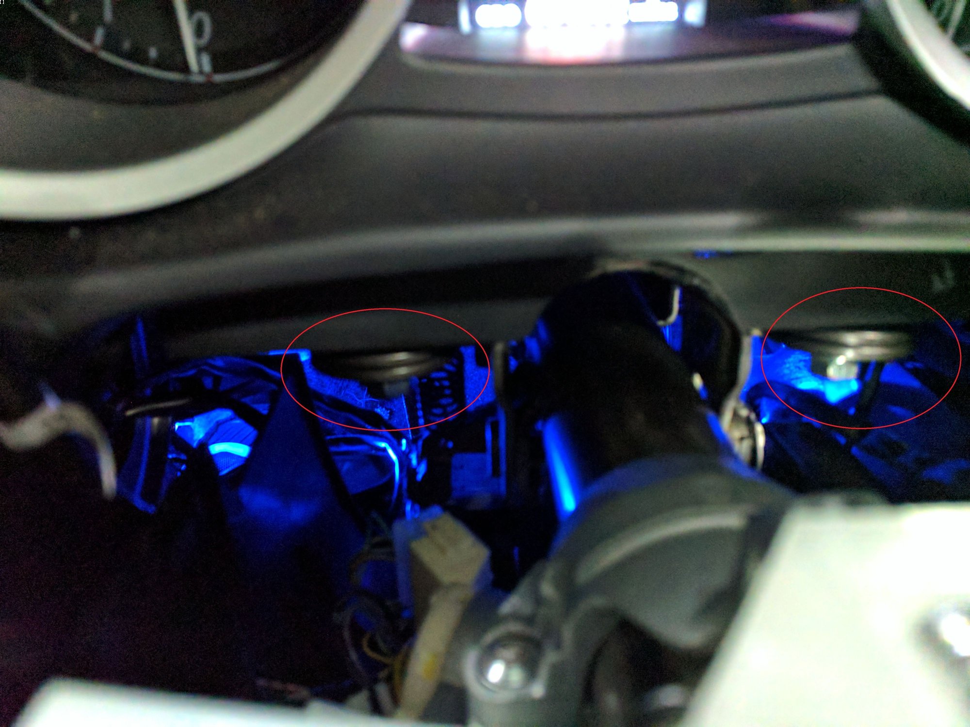

Also I'd like to share one strange thing that happened sometime during the PRO. Somewhere in the middle or towards the end of it I could have sworn I noticed lateral side to side play in the steering wheel. Thought it was in my head until the event was over. I parked my car with the wheels turned and when I got back to it to drive home I turned the wheel to straighten the front wheels out and I felt play in the steering wheel itself. Gave it a couple tugs laterally and there was roughly 3/4 of an inch of play WTF. I finally had time to take it apart yesterday as I'm going to Pocono raceway tomorrow and the two vertical bolts that hold the column in place were both very loose. They are 12mm bolts with double washer and I believe a lock washer as well. Gave them a couple turns each and all the play was gone. How the hell these things got loose is beyond me. Hopefully this helps someone out cause if it happened to me, it's bound to happen to others.

How hard is to get to those bolts? Did you take lot of thing apart or extension can reach them from under the dash?

2 min job. Unlock the height adjustment and drop the wheel as low as it goes and lock it. Lift off the plastic top column cover, its held by tabs and you can see the two bolts.
