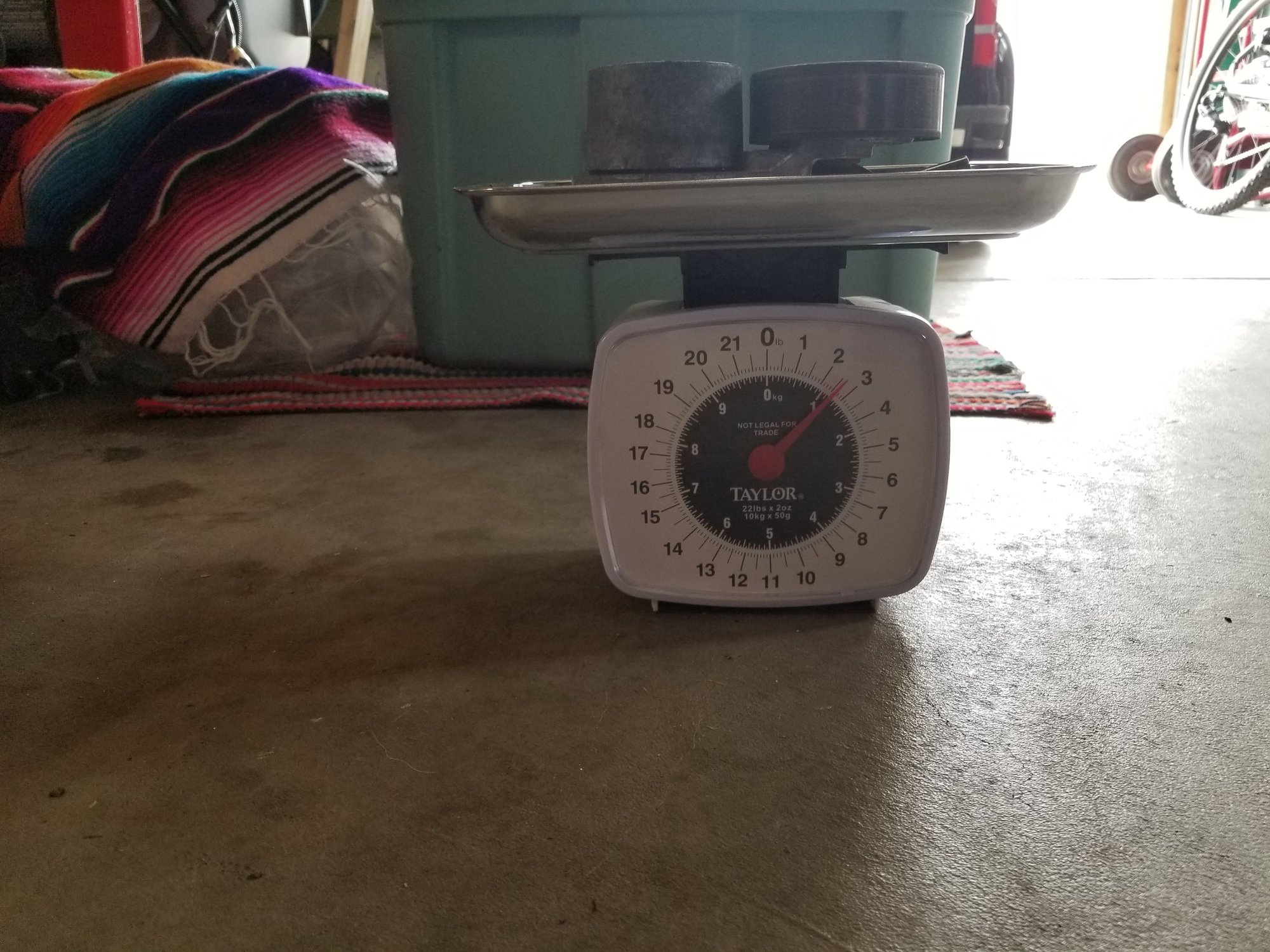

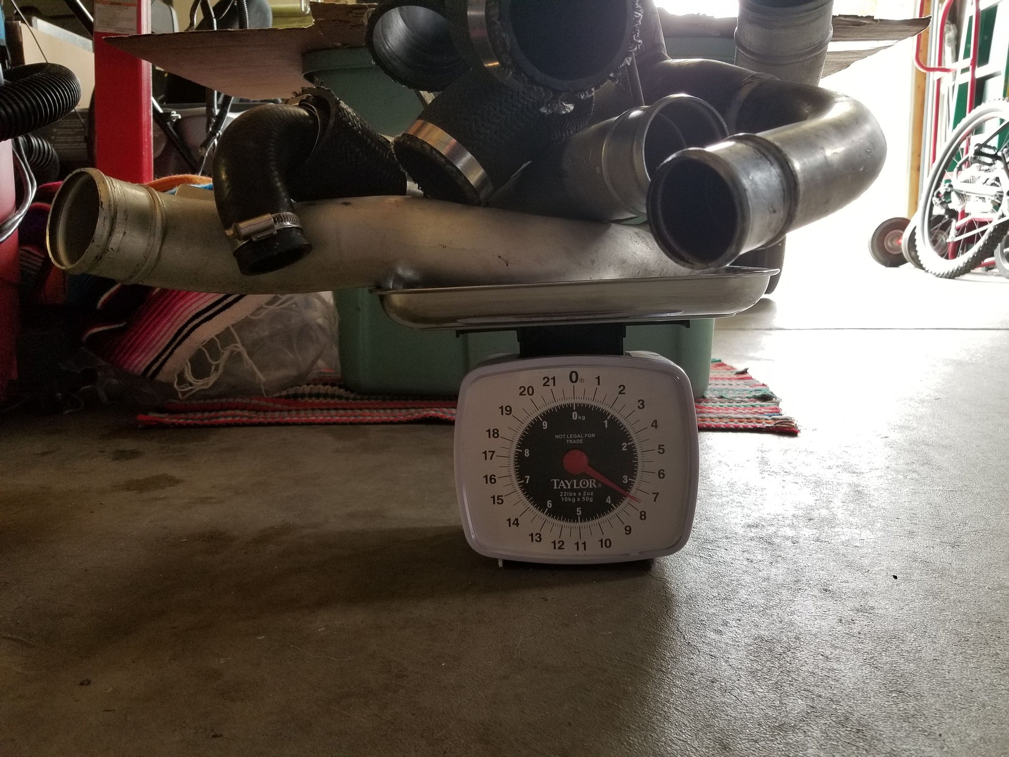

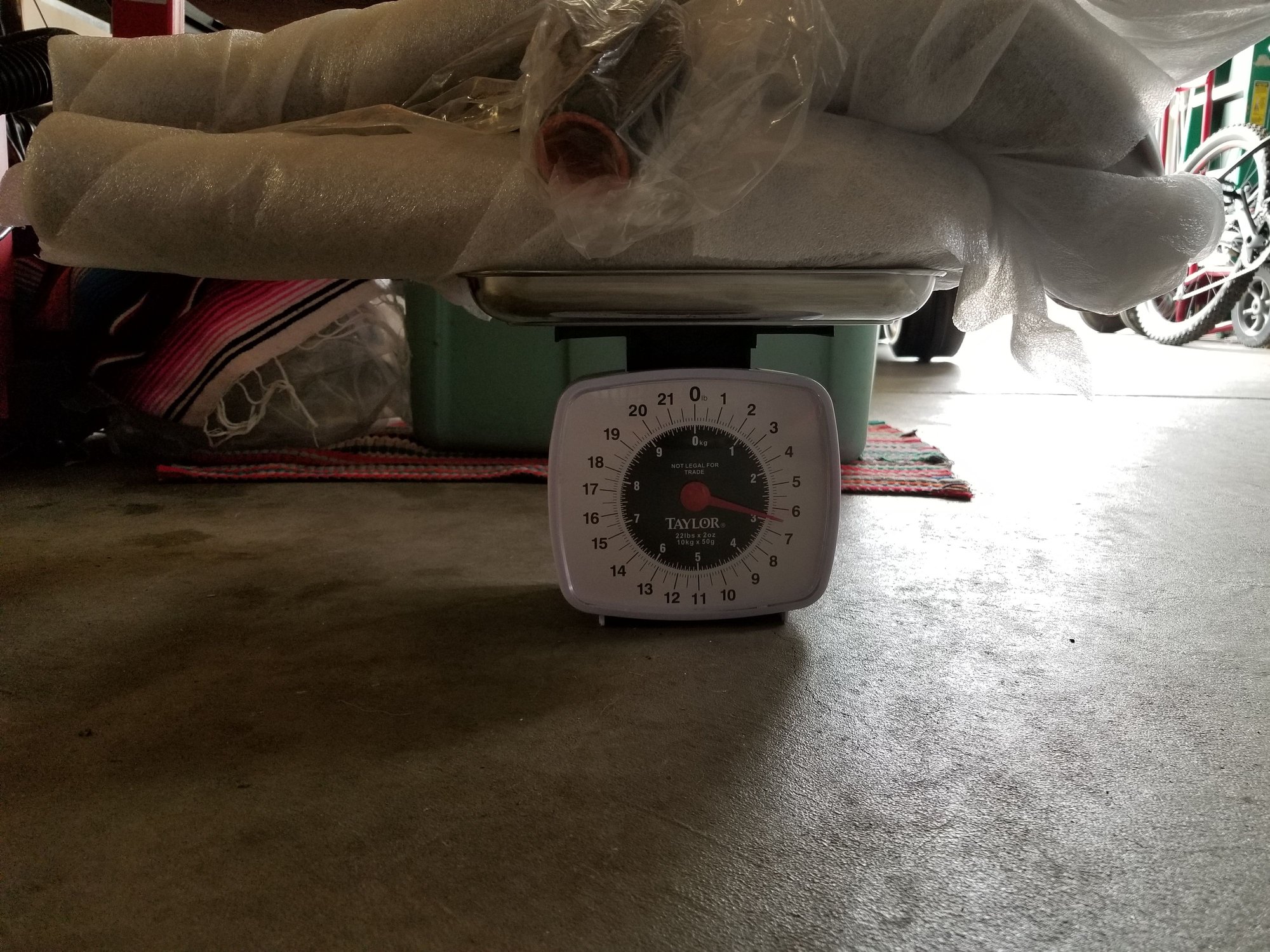

Some interesting observations. The ETS Ti short route kit including recirculation pipe and clamps/hoses is about 1lb lighter than stock.
Also the Evospec alt tensioner rod + light weight idler pulley shaves about 3lbs.
The FP cast manifold is about 1lb heavier than stock, and the FP 71HTA is also about 1lb heaver than stock.
So its a bit of a wash, maybe 1lb or 2 saved in my case comparing all these parts in particular.
OE tensioner and alt bracket
OE intercooler piping (hard and soft bits plus clamps)
ETS Short route Ti with recurc pipe, clamps, hoses
