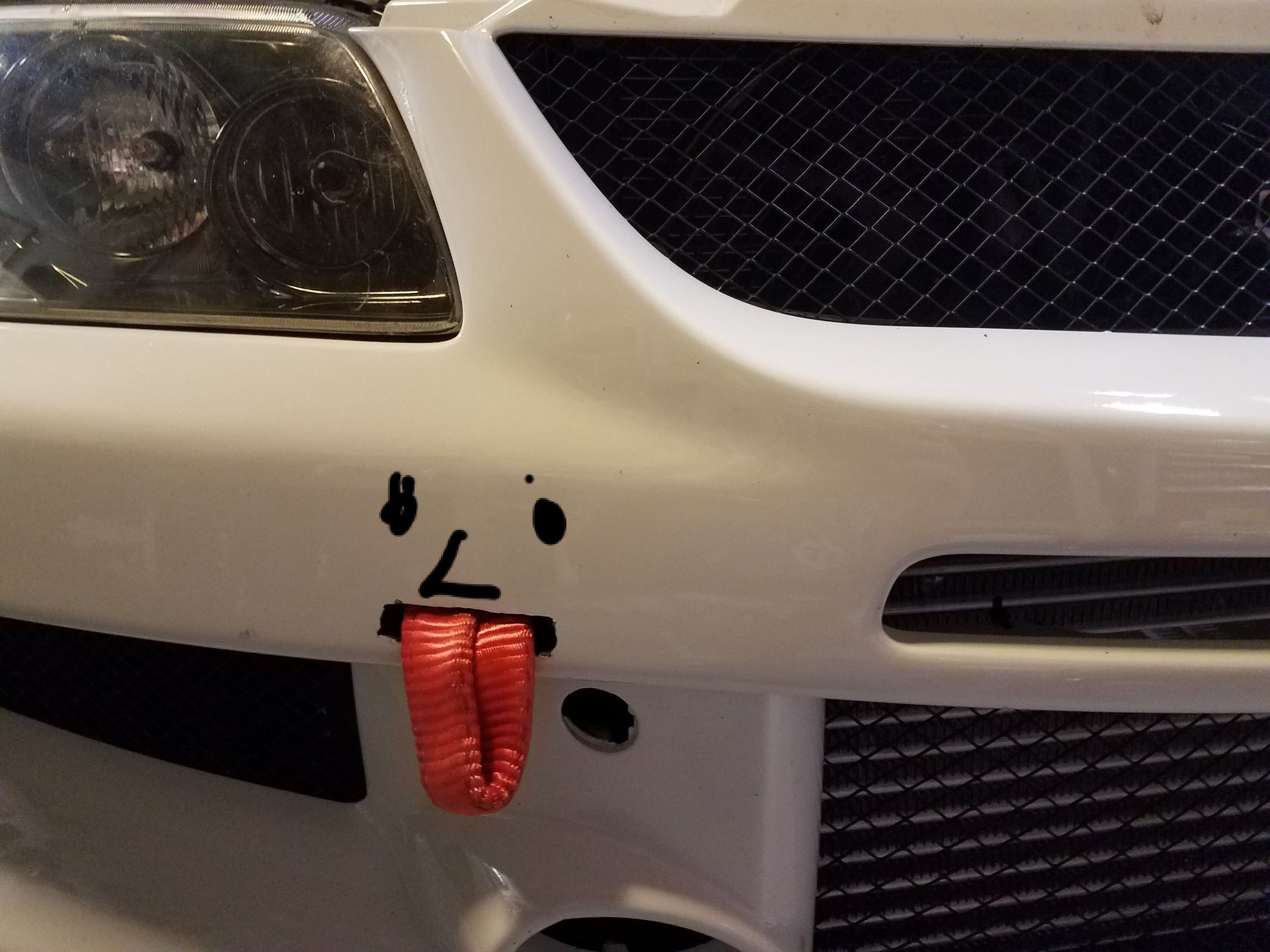

Cut my bumper. Looks crappy but no care lol.
