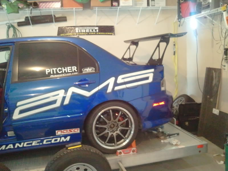

Originally Posted by boomn29
The +34 will rub the inside rear control arm - if you've got BIG rubber.
The +28 will rub the outside rear fenders - if you've got medium/BIG rubber.
Both clear the brembos up front. The +28 might rub with BIG rubber if you're really low and hit a bit compression (ie curbing on the track under G load).
Both CAN rub the inside of certain front suspensions if you want to run a LOT of negative camber.
Trust me.....
Attachment 287227
