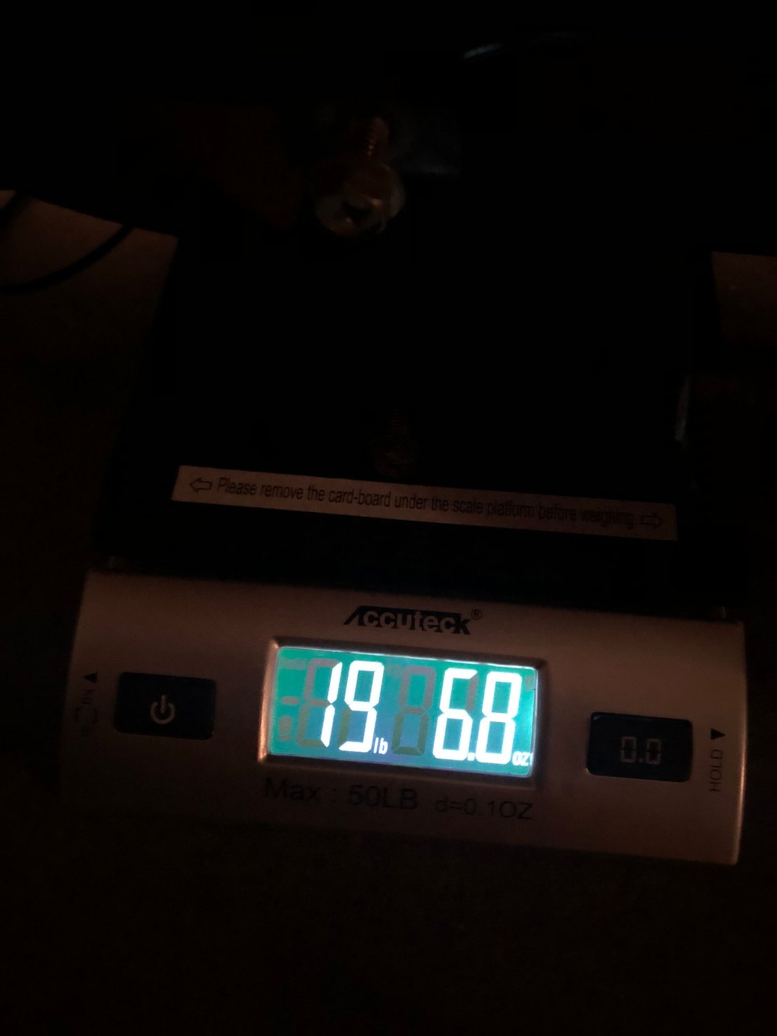

Well I got the CSF and put it in at 1am this past saturday and I'm fairly happy with it, the only issue was are the bolts they supplied to bolt up the fan are like 1mm too short. But it is a quality piece with some real nice features. I got out on track this past weekend and heat index was over 100F. Coolant temps never went over 215F.
I did remember to get weights.
Those are weights of fan and rad assembly. So saves about 5.5lbs but I'm sure most of it is in the fan.

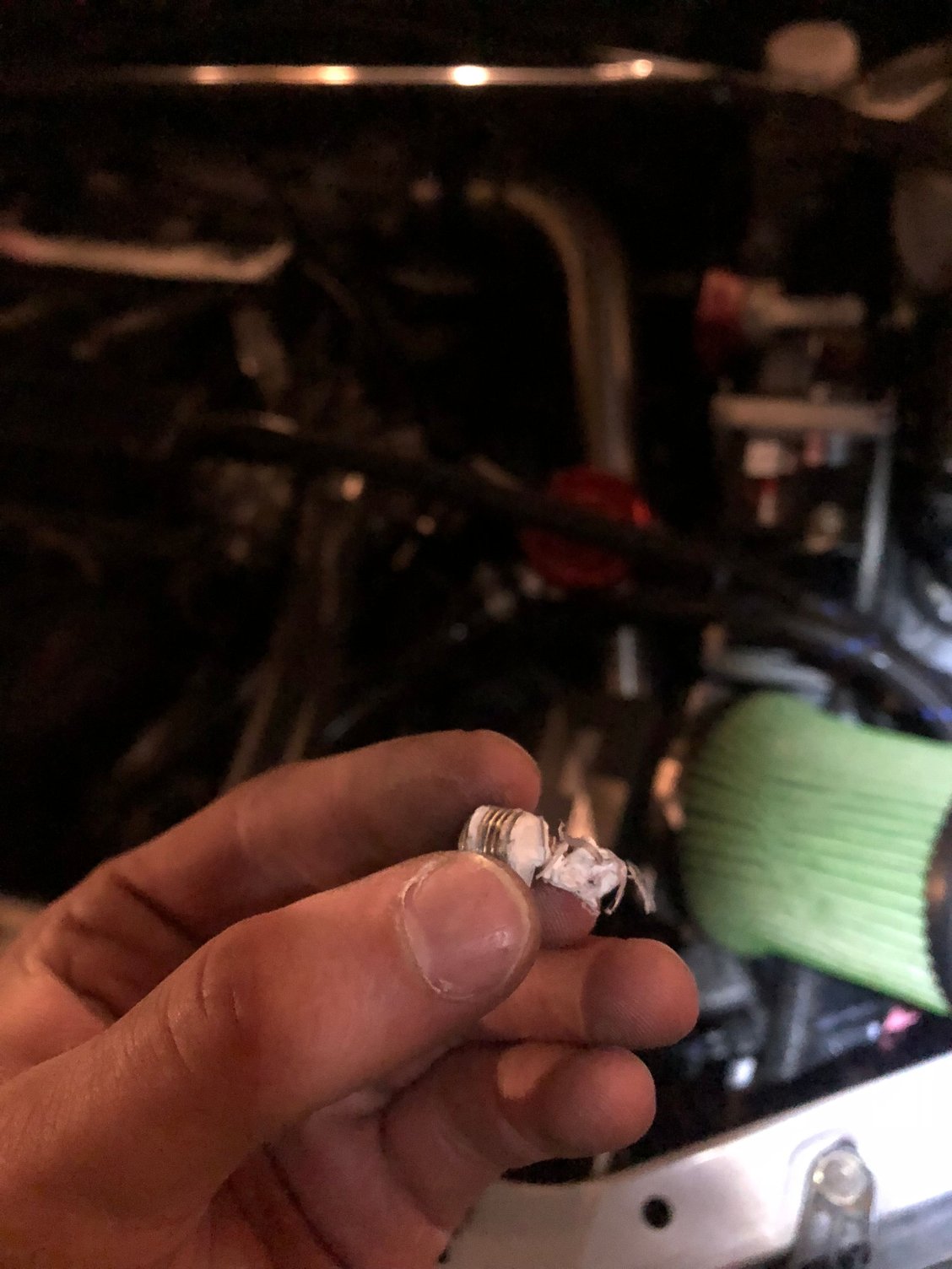

Also, for anyone who also buys this rad, check the 1/8 NPT plug on the upper tank. I removed it because I put my water temp sensor there for my Defi gauge but the plug it comes with had a ball of teflon tape on the end of it that I'm sure would get sucked into the engine at some point if I never pulled the plug.

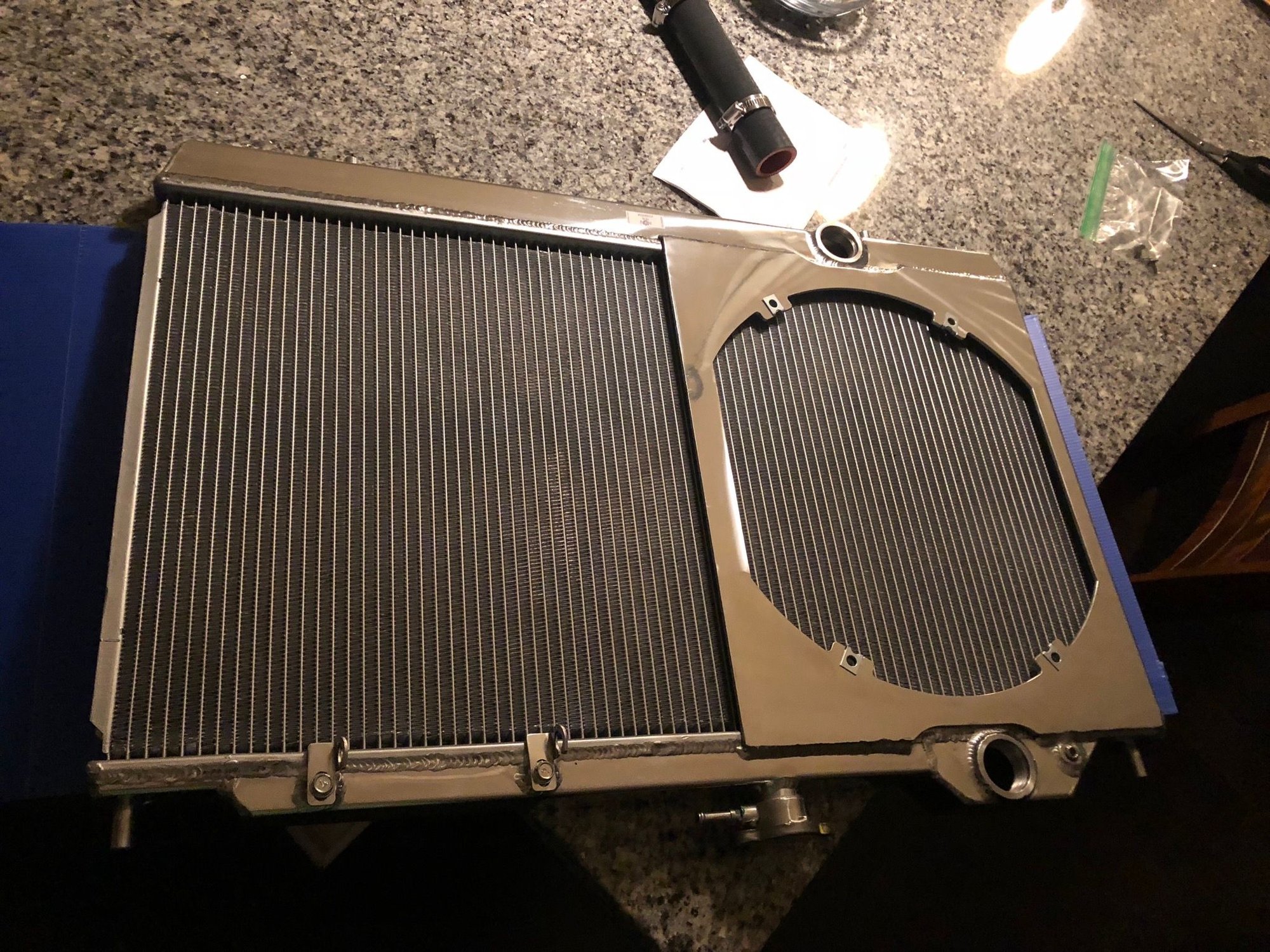

And here's some installed pics. For space reference, my intake used to rub on the fan.

so it's not a total pnp? looks like it needs different hose fittings etc, unless it comes with them?

The only non plug and play parts about it are you need to wire the stock fan connector onto the Spal fan and you need to use an evo 6 upper rad hose.

I bought it from STM, it's the one they market as being used with half rads.
