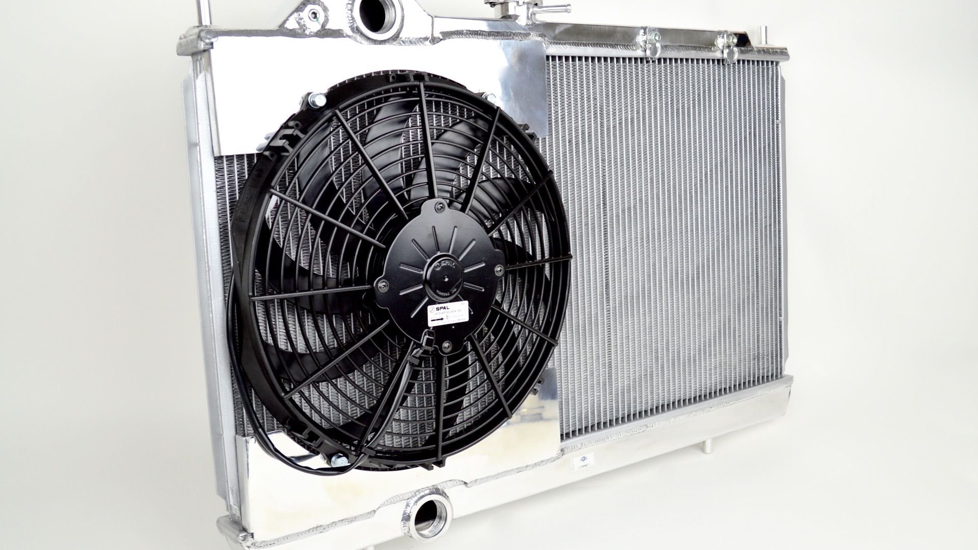

I'm still eyeballing the CSF 7075 unit. Very efficient core, evo 6 upper hose location, built in shroud and comes with a Spal fan and it's only $550.
It works beautifully. My car stays cool on track. And in the yellow car at 860whp, coolant temp consistently only had a 6-7* increase after a full power 1/2 mile pass.

I wouldn't really call the "tabs" welded onto the 7075 a "shroud" per say but it sure does look nice. I personally like having the fan on the outside left to help combat the turbo radiation and shift the oil/ps coolers some of ya'll are making to the right (looking at the front). By having both the turbo and the secondary coolers on the left, and no fan "there", it's creating quite the hot spot.

FWIW I don't have any coolers sitting in front of my turbo other than what's there from the factory. The rad fan pulls air through my rad and oil cooler.
The stock fan is definitely heavy and it'll be nice to gain some space there as well.
And I'd call it a shroud on the 7075, it covers 90% of the area on the left side that the fan isn't. Putting shrouding where there isn't a fan would just block airflow.
And there are some photos of a full shroud, not sure which is the currently sold version though.
