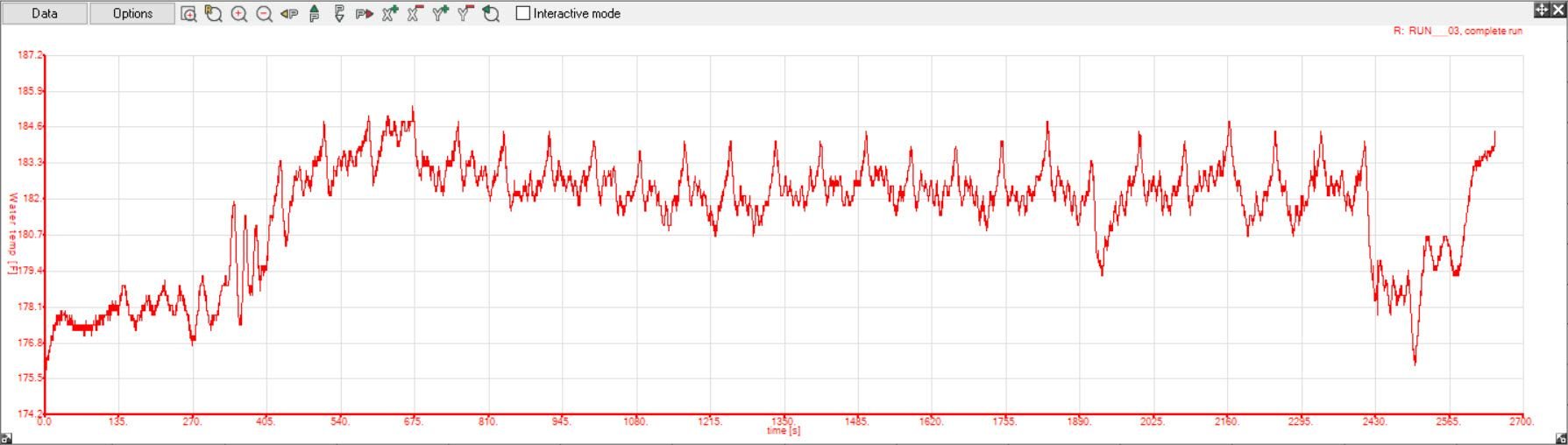

Unsure why there's so many variations out there, leaves me scratching my head. I've never pushed coolant unless I forgot to turn the fans ON and left it running in the pits. There's little evidence in Evans ability above and beyond the pressure benefit, so it's not a "need", just my opinion. Plain jane Koyo radiator, stock lines, stock location, ONE fan in FRONT left, TWO bottles of purple ice, ALWAYS use distilled water. That's really all you need. Same combo in south Florida tracks for years and years. I'll just leave this here from that same 85deg session ya'll saw in the oil thread:
