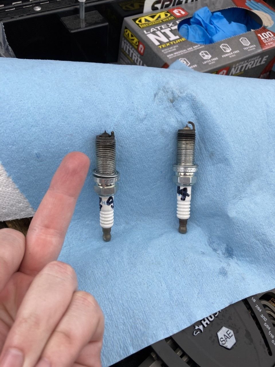

Where's the mood button.....Cyl 3 on left, cyl 4 on right. No I haven't looked past this yet. Crushing it on Friday's practice (Daytona btw), go into Qual laps Saturday morning, bounce through the bus-stop, mph wouldn't increase, power decrease, noise, oil spray on windshield from front catch can suddenly getting tons of oil and pressure. Bag of peanuts to the correct guess after teardown lol........AGAIN.....F**#*#(*$@#&($*#@&$(@*#$&@(#* &. The drysump was flawless except for the catch can location and it's smog effect, oil pressures were best I've ever seen. Me thinks mechanical failure. MAP SPEC 2.0 so I beams and 1400hd's......hard to think I actually stretched a rod at 300 whp.

Bye bye piston^^^^^

Tuner thinks it could have "melted" instead of "crushed" since the diode is still there just based on the pic.
Maybe it leaned out for some reason and you melted the plug and lifted the head from detonation. Block might be okay.

Things like this make me want to order one of those snake camera things to see where you cant fit. Hope its just a plug and not the rest

that sucks man. from only 300whp?
