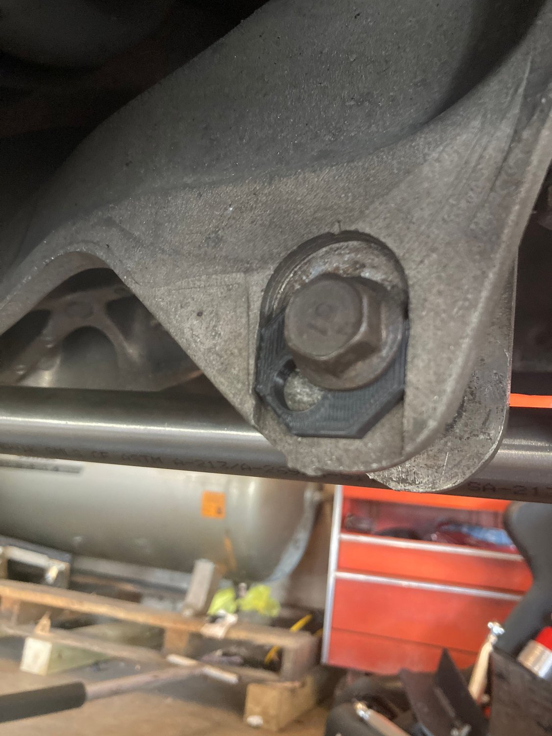

Designed some rear camber locks that give more than a few camber settings. Going to be measuring adjustment range and then should be getting a few sets machined soon.
def keep us posted on that

Ya I have adjustable arms on both cars so locking this at 0 with a standard bolt is MUCH preferred over the easy-to-strip oem one. Same goes for the front struts like PA did.
