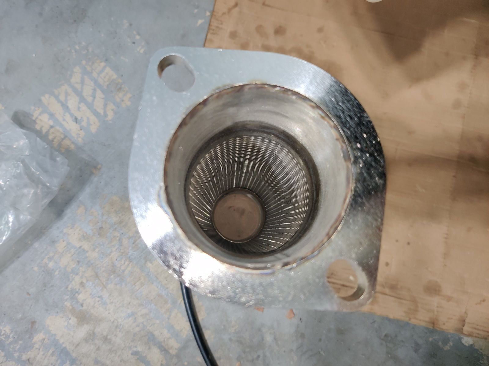

resonated test pipe is in the car! holding on to the cat in case I ever go back to a state that requires a cat. hopefully the difference in backflow won't require a retune
Old Mar 30, 2021 | 07:12 PM
  #2955
kaj's Avatar
kaj
iTrader: (60)
Posts: 13,634
Likes: 824
From: Fresno, CA
Going from a catalytic converter to no catalytic converter? Definitely want a retune
