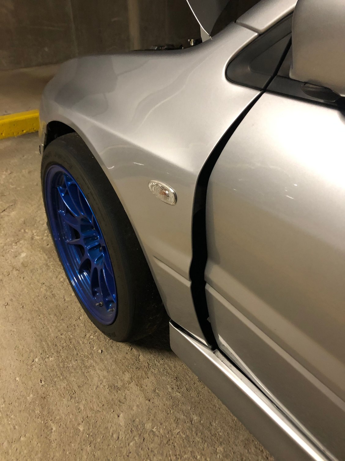

I'm at 18x10.5 +10 in the front on my car. My fenders are yoinked. Super spaced out at multiple places and the backsides are trimmed to help evacuate air from the wheel wells.
I'm debating putting together a small fender spacer kit to sell if people are interested. Able to make a mild version that just pushes out the center or a wild version that pushes out the fender at 3 spots (front, back and bottom).

Nice. Have you measured the additional clearance at the top of the tire? I'm curious how much you can get from a proper yoinking like yours.
I made a 1.25" fender spacer for the rear mount and it only move the area at wheel center 0.25". I needed that much space at the time so I used it but after I cut fenders I put them back normal mount. Youd really have to space out the front mount at the headlight to get any real width change which would then of course leave a funky fit with the headlight.
