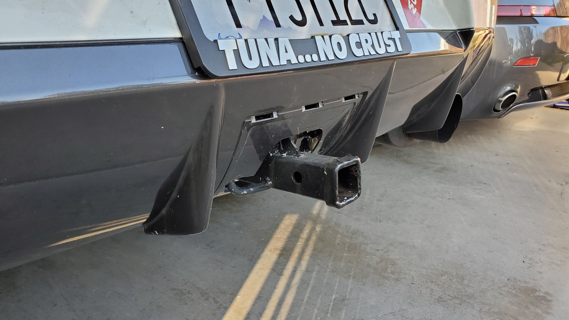

I have no problem cutting up my "super rare blah blah" Evo 9, it's JDM bumper (I just cut a tow hitch hole in it), and I drive an older exotic every chance I get.
Can I get a photo of that?
Also, which hitch did you use?

I got it from a member here. I *think* I can put the tow hook cover back on...but not 100% sure.
