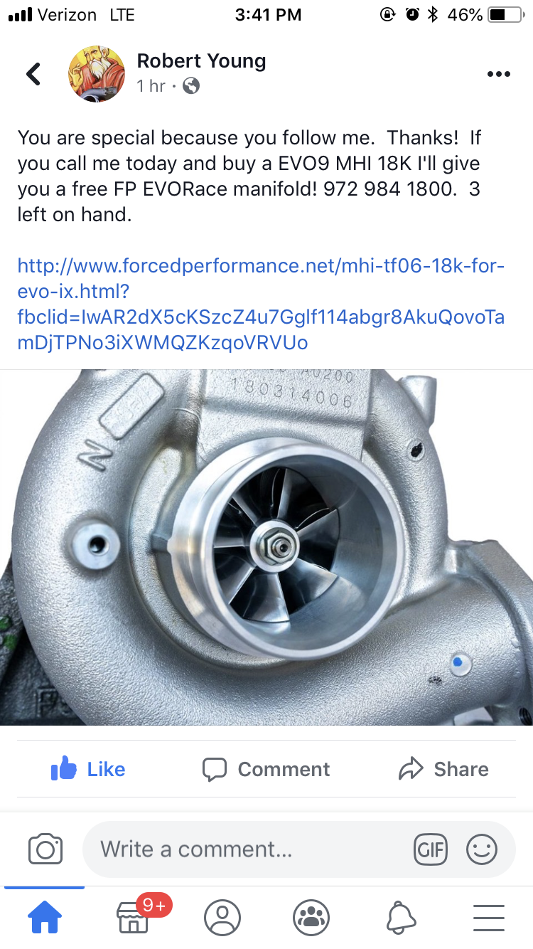

Interesting release from FP, but oem?
http://www.forcedperformance.net/mhi...or-evo-ix.html
Looks to be between 71 and 54 but with an oem housing. (Cough Kaj Cough).

I assume this turbo's been machined for bigger turbine and compressor wheels. I wonder what other design improvements Mitsubishi made to this turbo.

BTW
