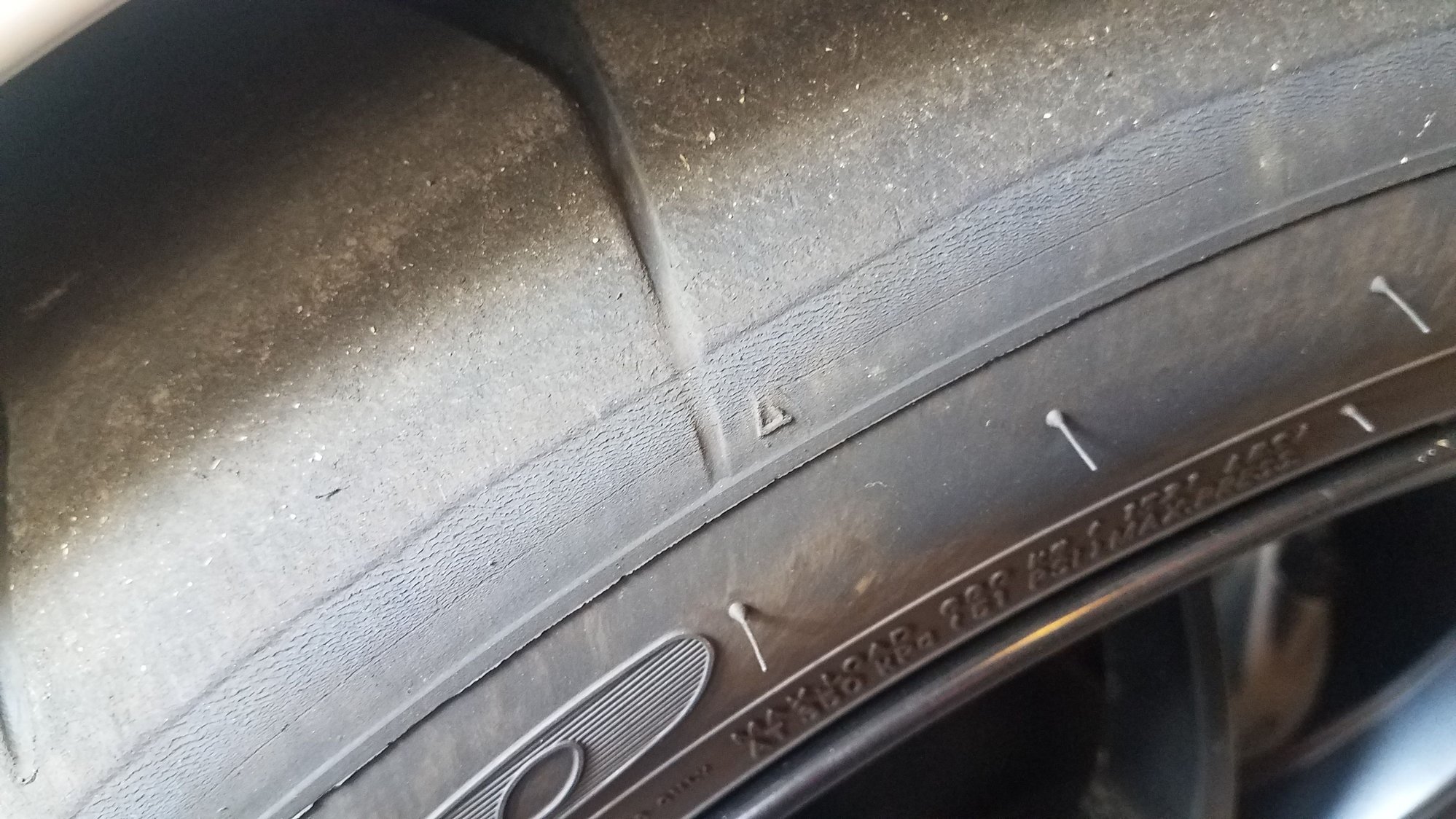

I get bluing on the outter edges of my tires (they roll over perfectly to the triangle mark thingies). That means heat, due to not enough air in the tires? So I should increase pressure and reduce camber? Currently at 3.0 front and 2.0 rear.

Post a pic of the tire. My guess is not enough camber. You shouldn't really be touching the arrow. You should be wearing the tire to the edge of the tread that the arrow is pointing at.
No, that means you dont have enough camber and are heating primarily the outer edge. More camber and probably more pressure. But if youre bluing the outside edge, then mid corner the inside edges is going to be nice and frosty in comparison. Make that tire work more, get it happy in a corner.
That's where it rolls to. I assumed I'd want it going to where the arrow is actually pointing. Made the most sense to me.
As I'm typing this, I just went out to take pics... looks like the blue from Sonoma looks to be mostly gone, after this AX day. So weird. There is some wear on the arrows from this last event, from starting with too little air pressure. My chalk lines were spot on, after adding a couple PSI after.
I start pressures at 30psi front and 28 rear. Once warmed up, I chalk them and adjust accordingly. I don't have my notes as to what pressures were hot, but I usually end up bleeding about 2psi from each corner. For the last event, I started with the pressure I ran at Sonoma..not realizing the tires wouldn't get as hot at AX, which I assume is the reason the were rolling over too much during the first few laps.
For fun, here's a vid I made from the AX(ish) event at Buttonwillow. You can see my mystery smoke puffs are now coming through the exhaust, as well as from under the hood. I'm still trying to find time to get into/under the car to look around. Work has been kicking my ***. These shots were during fun/experimentation runs, so not my fastest or best driving. Ended up with a 55.07x which was good for FTD, about 2sec ahead of the 2nd place Atom.
wear on arrow from AM session start with too little pressure. Maybe still a hint of blue.
also a hint of blue.. kinda.

Not enough camber.

Yup, not enough camber for sure. -3 is just getting started
