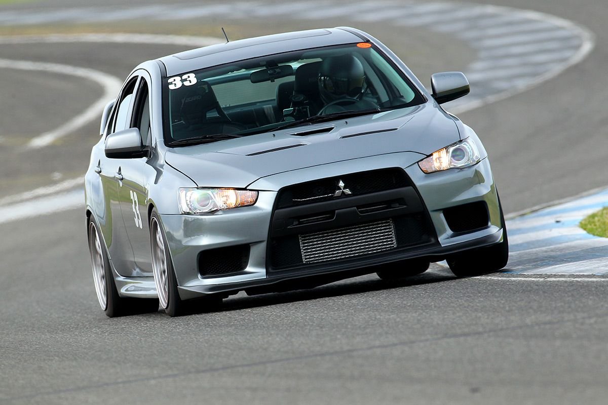

You said the tire rolls over to where the arrow points, so its good. That is not what the arrows indicate. The arrows are way off the tread, if the tire is rolling over that far you do not have enough camber.
Gotcha. I was misunderstanding. I've set my camber to *recommended* then adjust tire pressure up or down to get the tire to roll where I want, using the arrows (what was recommended to me years ago). Then, depending on tire wear, adjust camber. Knowing what I know now, I've been running too little pressure, all the way around, and that would probably explain why they are turning blue on the shoulders

Yea if the outside shoulders are bluing at the edge you're overheating them which most of the time means you don't have enough camber. The lower pressure may feel faster (or maybe even is) but that's because it's bandaiding another issue in your suspension setup.

Once you get more camber you can run less pressure. The NT01’s are way better with less pressure. They feel like *** at higher pressures.
i usually start the day at 24-25 cold and aim for 35-37 hot off the track.
They also feel wayyyyyyy better response wise when slightly undersized on the wheel, Japanese tuning style
Keep in mind I carry a little bit more weight around the track than you CT9A guys...

Already have an alignment scheduled
I'm sure if I'd remember to check pressures once they cool down, I'm in the 28f/26r+- area, so pretty similar. Car is 3150 and tires are 275s, if that makes a difference. As for sizing, I'm on a 10.5 wheel, so not sure how that compares side-wall-wise... I went with 10.5 instead of 10 so I could get a bit of the fitment you are talking about. I like how the cars transition with a teeny, tiny bit of stretch the sidewall.

I know this is a completely different type of turn and I have a lot less lateral load on the tire... but the difference in sidewalls and camber made me chuckle. I'd go faster.. but this turn doesn't like that, very much
