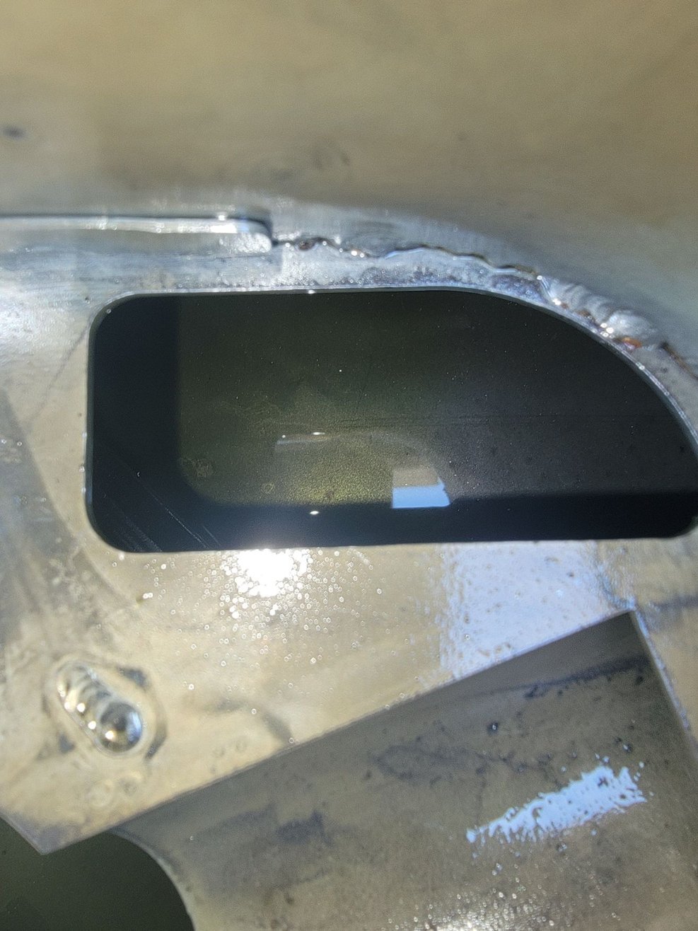

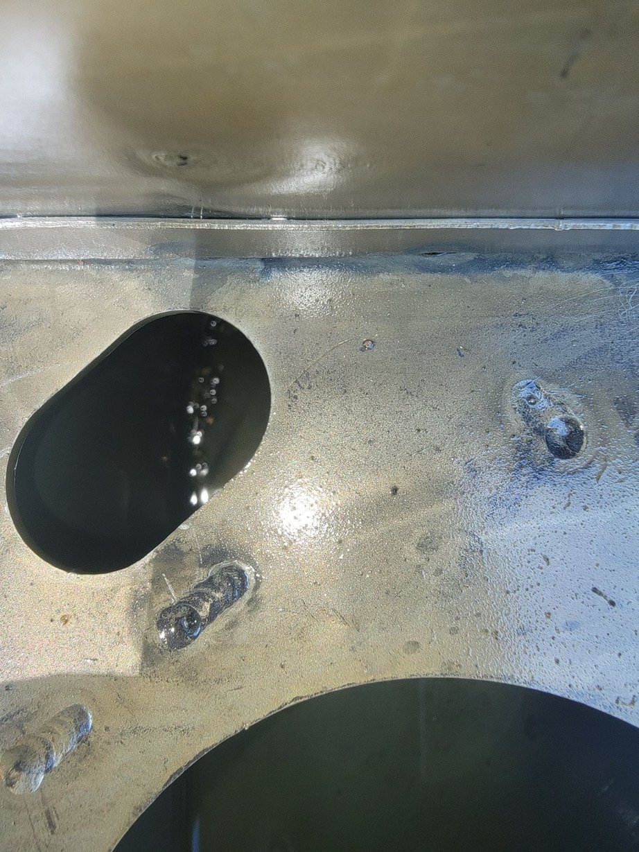

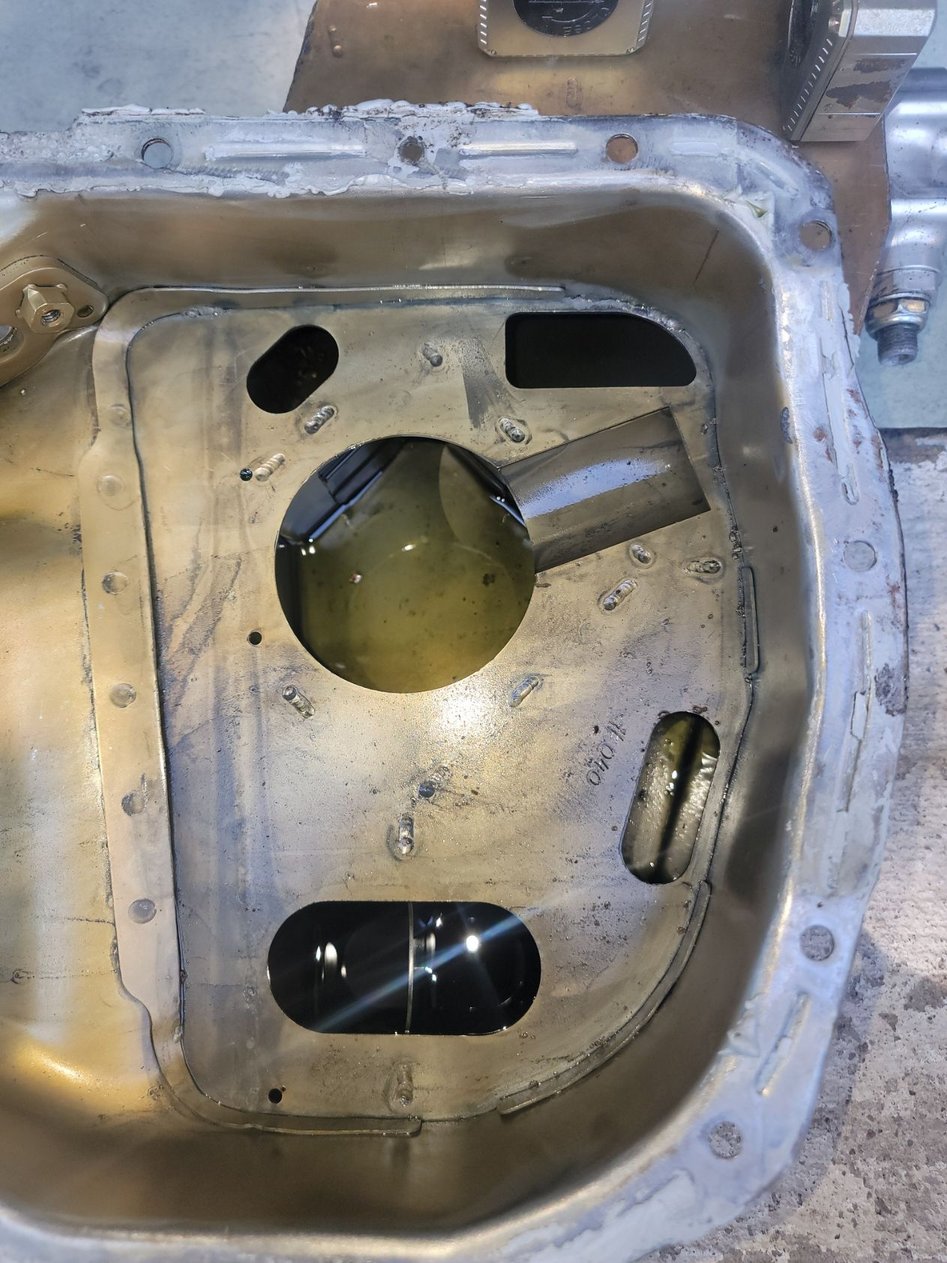

just something to consider when doing oil changes. if you look at the lower right hole, oil drains fine in there. all the other surfaces are still submerged in oil. assuming with lots more time all the oil will be at the drain plug quadrant, you might want to consider draining from the temp sensor plug as well
This was drained while on a lift, and yes I have debris in there but I've brushed away whatever i can from the tiny gaps I expected the oil to slip under
the oil grade is 20w50 if it matters
