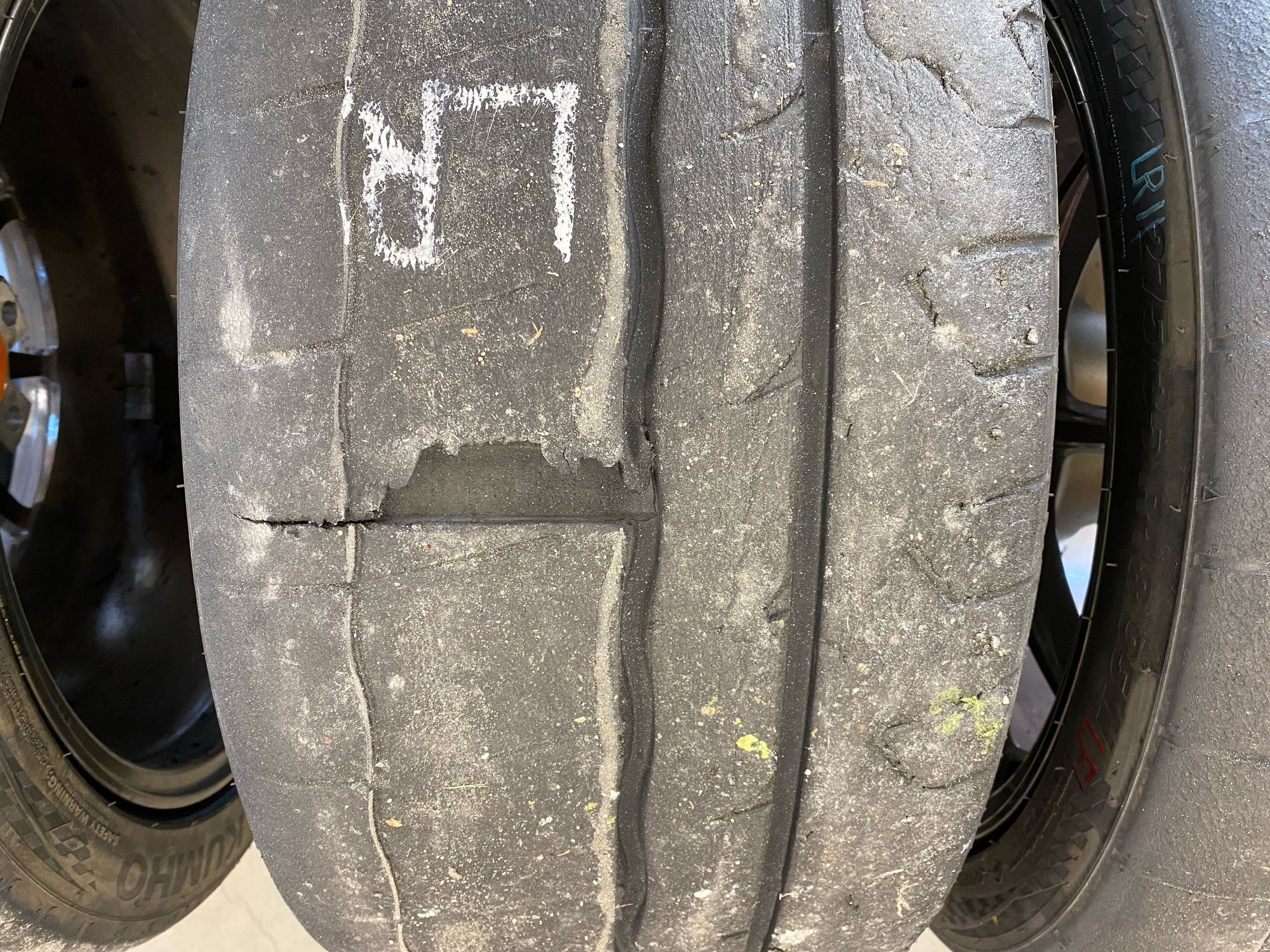

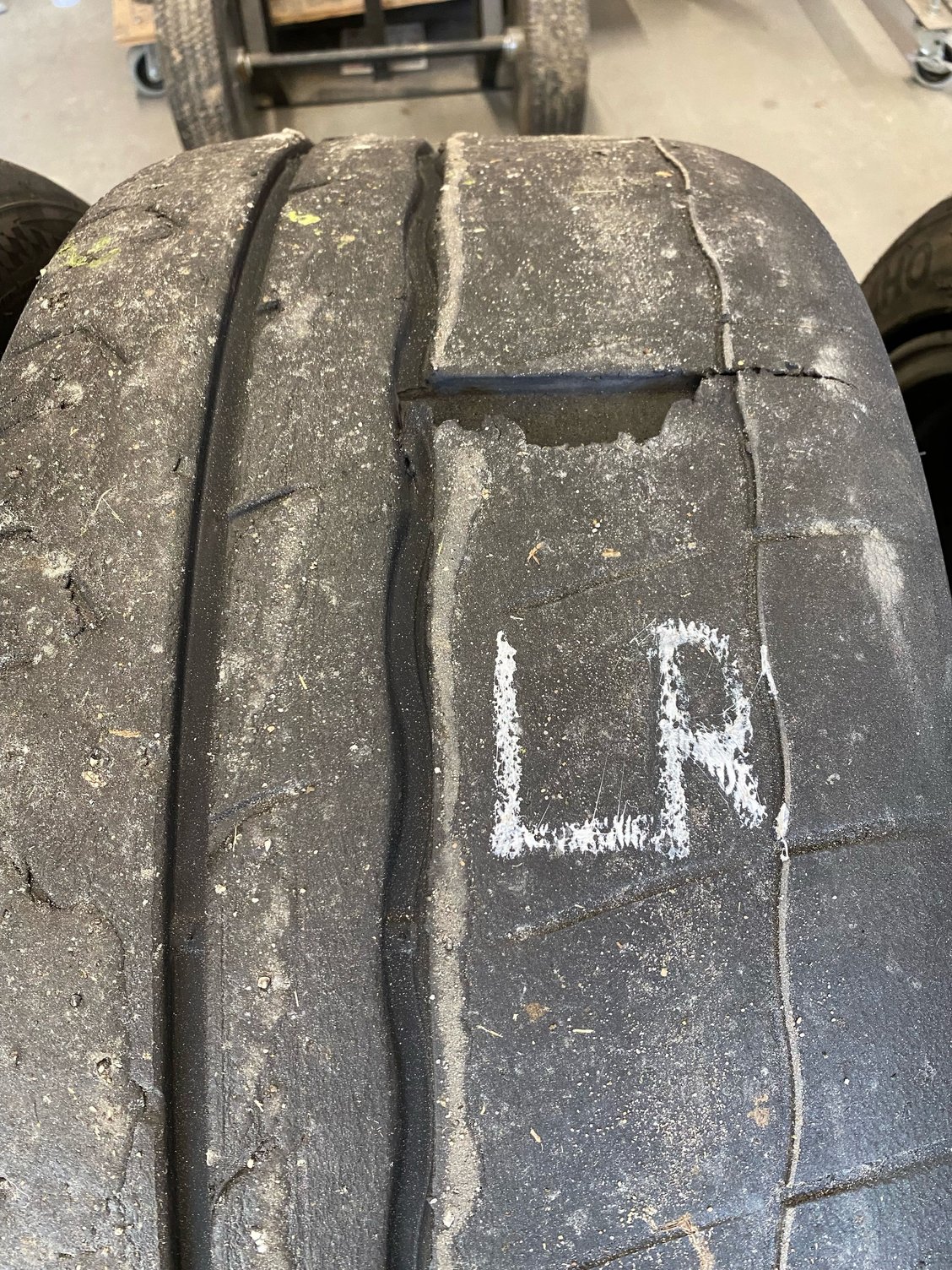

I ran the Kumho Ecsta V730s this past weekend at Palmer Motorsports Park. Temps were 30s to 70s throughout the weekend. Supposedly the new cheap hotness.. After 5 30 minute sessions on Friday we rotated them. Saturday morning was a 20 minute qualifying session, and then a 20 minute race on Saturday afternoon. Sunday morning we put the car up and discovered the tire on the front passenger had delaminated at the manufacturer seam on the tread. It was a straight across line on one side, and lifted up for a few inches. We moved it back to the least stressed corner and ran it Sunday for two races with hesitation. It held up. I haven't looked at the tires since getting home but will tomorrow.
I am currently in contact with Kumho, as well as Tire Rack. If Kumho is trying to swing up at the more expensive tires, while maintaining a cheap price point I applaud them. However, if there is a flaw in the process I hope they are going to take notice. I would run another set. This could have been a fluke. They were sticky, and didn't get terribly greasy. They were super predictable with good stability to the limit of the tire.

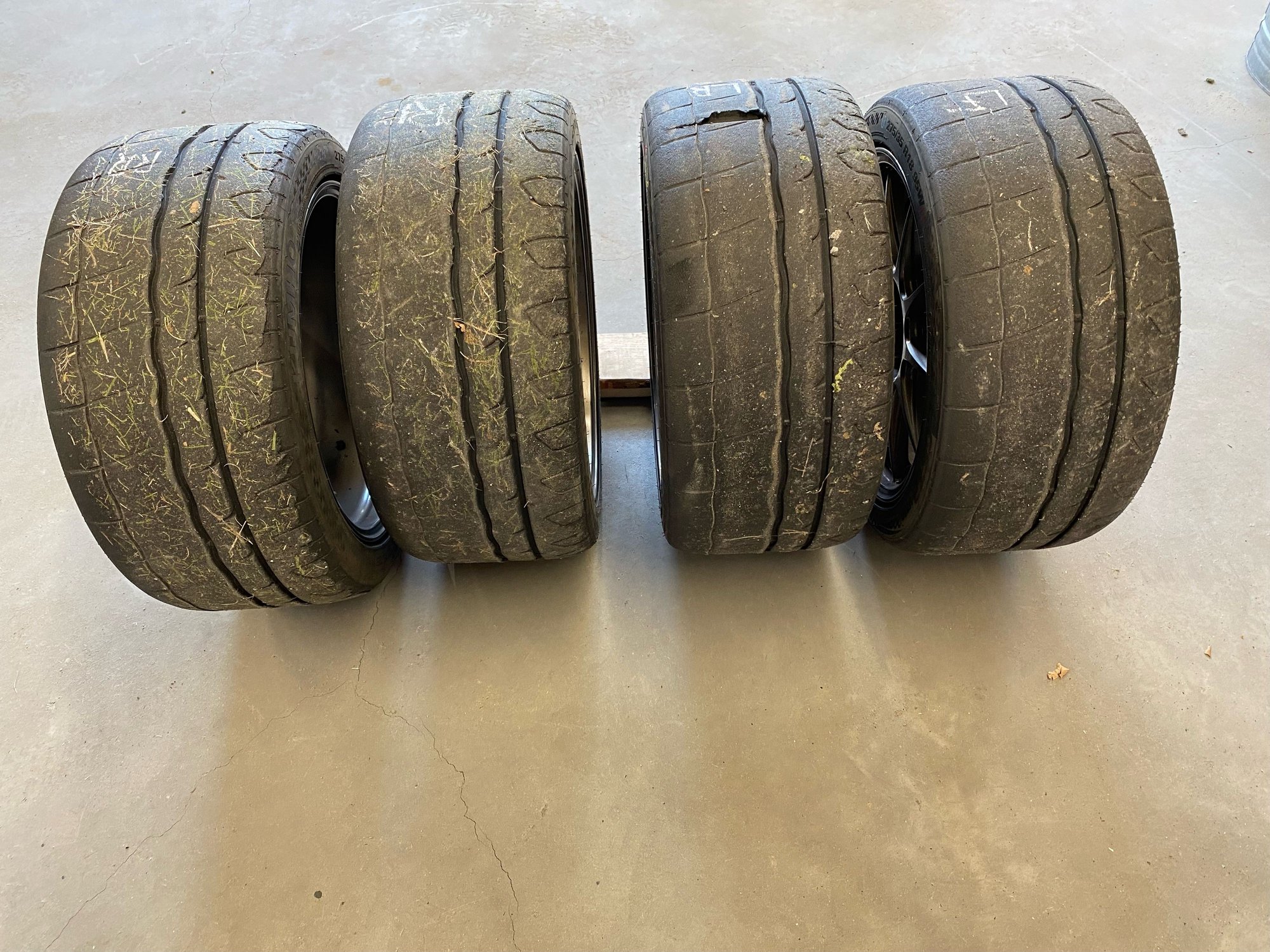

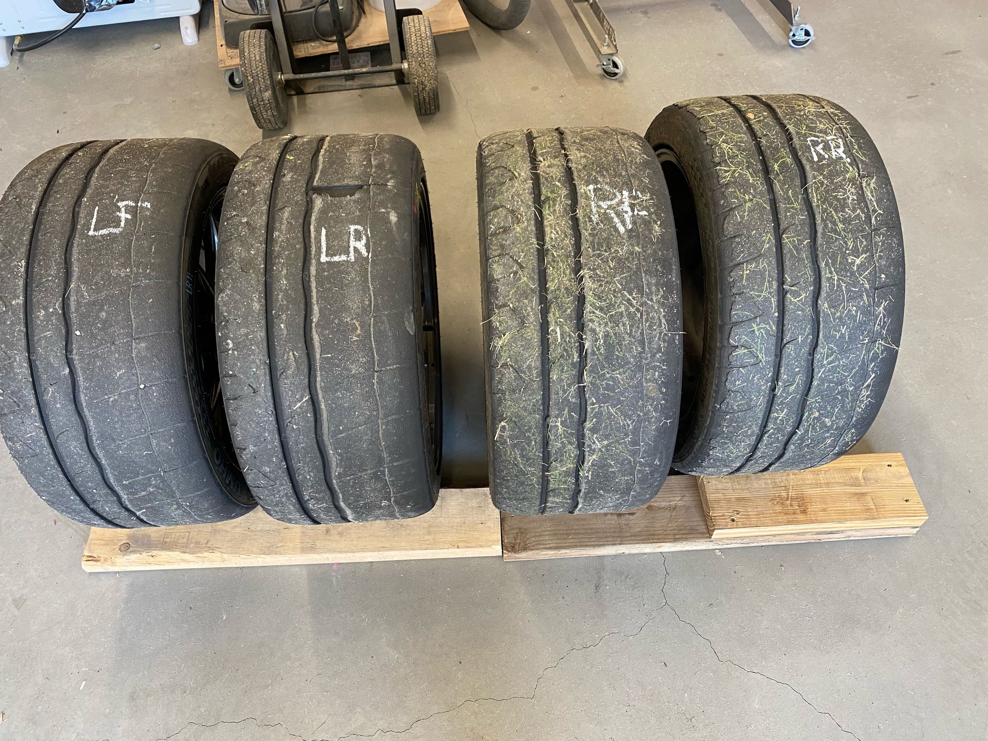

Pictures are attached showing the delamitation of that one tire at the manufacturers seam. See what Kumho and Tire Rack says of it. Honestly they dont look bad, except for needing more negative camber...
