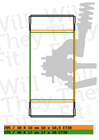

I just want to confirm, is the search for 275/40/17 200TW tires hopeless? 35 doesn't even exist besides Hoosiers.
Sometimes I think about getting 17x10 wheels, but the only tire options seem to be RT615K+ and RT660. If those disappear then that's it. I might as well stick with 18x10.5s right? I like the look of 17s, but I'm in too deep and already have rear trailing arms for wide tires. I shouldn't go narrower than 275 merely because I think sidewall looks cool.

It's been proven multiple times that 18s are faster on track than 17s. If you're already on 18s then stick with them, like you said there's way more tire options and there are more wheel options when you're looking to go 10"+.

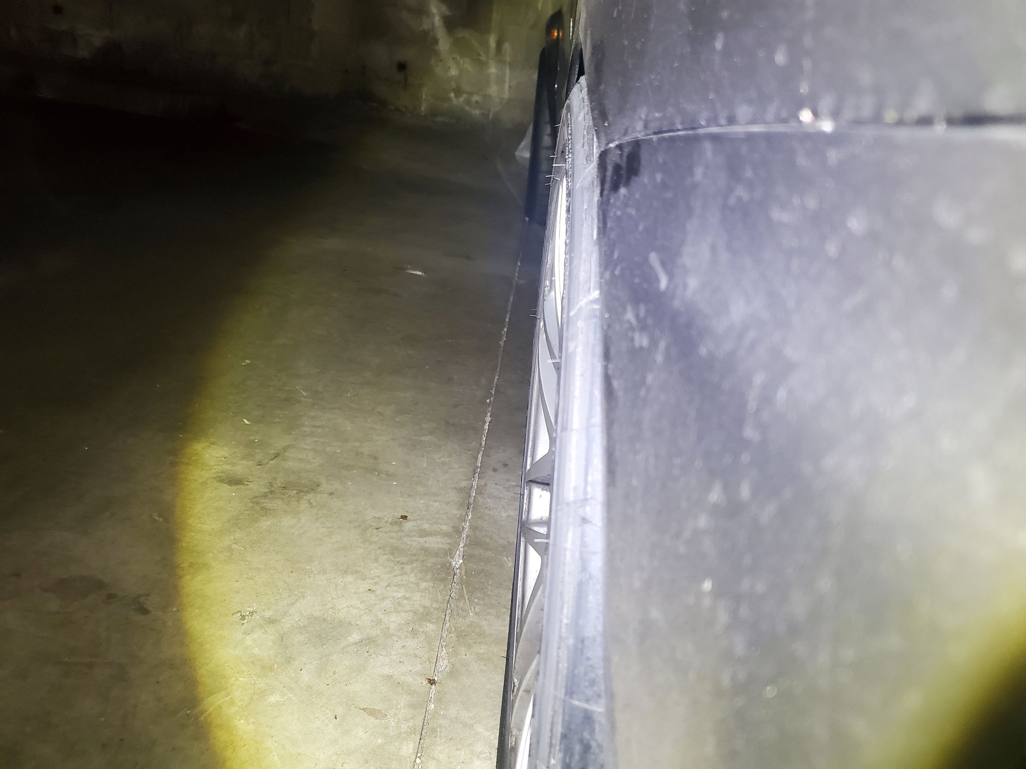

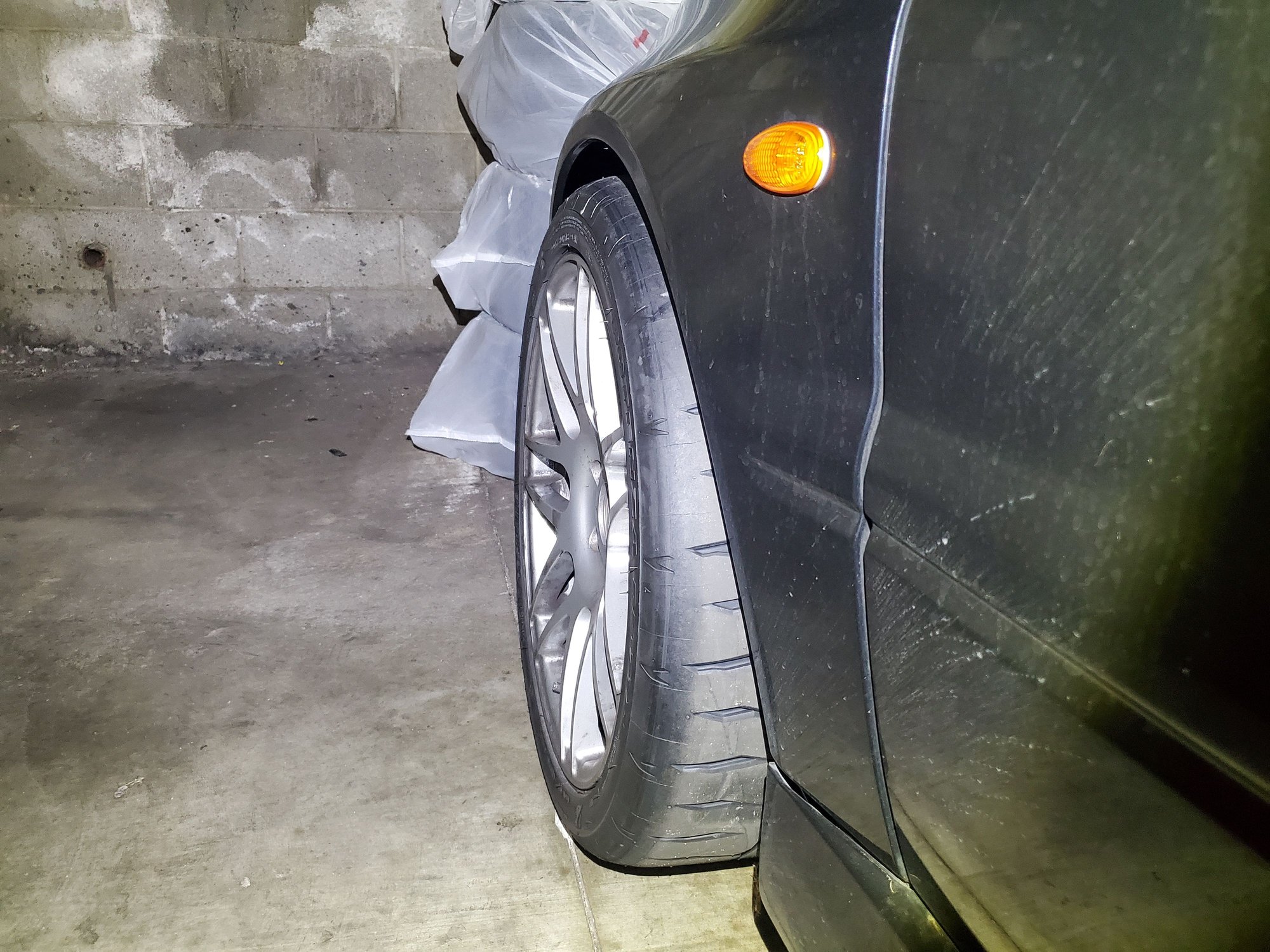

Alright, went from 285/30/18 RE71R to 295/30/18 RE71RS.
Front seems fine on a 18x10.5 +38 wheel with a 12mm spacer. Maybe a 15mm spacer would give the spring perch a little more breathing room.
The rear however is catching. The car already had a roll and pull, but the remains of the bumper tab relocation are shaving pieces of tire off. It's at -2.5 camber in the front, -1.5 camber in the rear. You think I should keep fighting the fenders, or add another half a degree of camber?
If I go for the fender then a little more pull, and some cutting of the bumper tab area where the fender meets the bumper. Seems like the folded metal there is the problem.
Old Apr 26, 2025 | 04:31 AM
  #165
Meathooker's Avatar
Joined: May 2011
Posts: 826
Likes: 149
From: Idaho
I think we’re running 2 or 2.4 in the rear - I’d try that then mess with the fender and tabs as needed.
