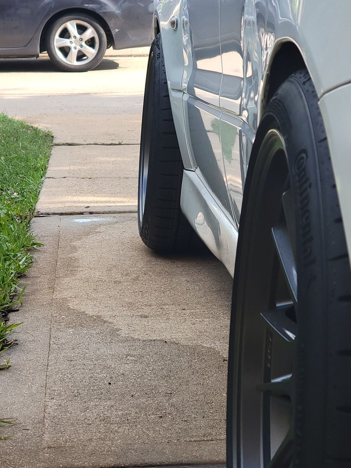

Jun 1, 2025 | 08:26 PM
  #208
check out the ridiculous stretch on these 295/30 Conti Extreme Contact 02 on an 18x11
It might work for folks struggling to fit 295 RE71RS'
too bad its not available in 315s

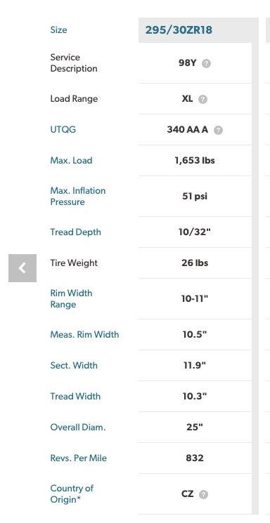

Jun 2, 2025 | 11:15 AM
  #209
Tire Rack does a good job of measuring section width and tread width for each tire.
That different between section width and tread width is massive.
For comparison, the A052 section width is about the same (11.8") but the tread width is 0.7" larger at 11" (295/30R18 for both)
Reply 0
Jun 2, 2025 | 12:54 PM
  #210
I dont think those are Tirerack's measurements i have 295/30 RE71RS which is almost square with the 18x11 wheels. according to the numbers its only 0.3" wider thread width. these 295 ECS02s has atleast 1" less thread width
