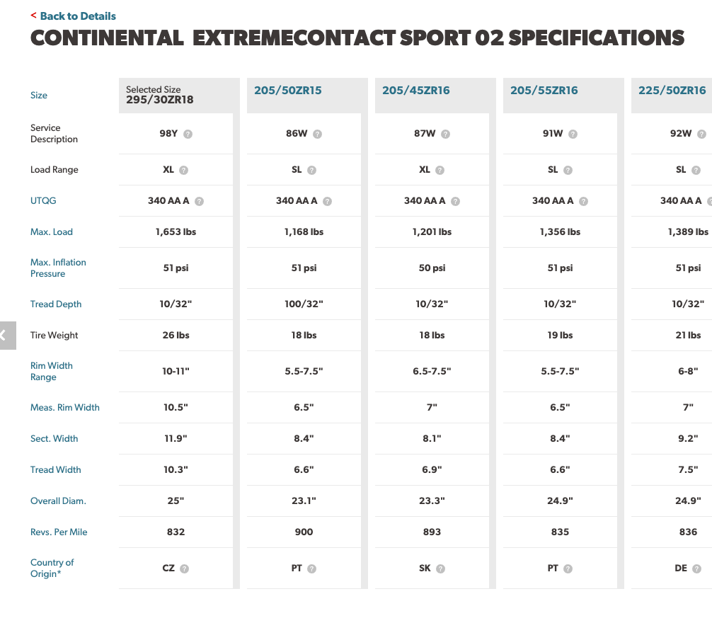

I dont think those are Tirerack's measurements i have 295/30 RE71RS which is almost square with the 18x11 wheels. according to the numbers its only 0.3" wider thread width. these 295 ECS02s has atleast 1" less thread width
I'm just copying and pasting from Tire Rack's website. Their measurements show the 295/30R18 having 10.3" tread width, which is consistent with what you're seeing.

I know but I'm disagreeing that Tirerack actually measures them. Assuming Continental's numbers are accurate, 200TW tires tend to be wider than what is on the spec sheet

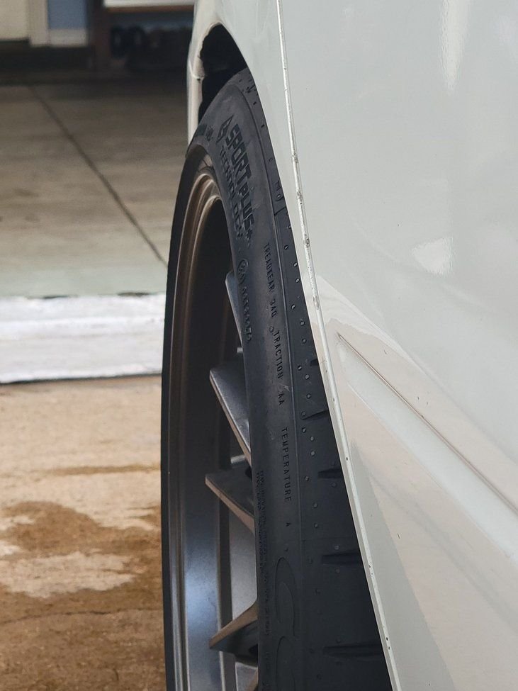

I can fit 315 ECS02 if it was available. I'm not too happy with the stretch with these 295s
They actually do. There's a Tire Rack employee on another forum who talked more about the process. He's even gone back and re-mounted and re-measured a couple tire/wheel combos when people complained that the numbers didn't look right.

I guess what youre saying is TR cant do anything to change whats printed on the sidewall, but they provide "more info" ?
I was just not expecting the huge diff having the same "tire size"
I was just not expecting the huge diff having the same "tire size".
Tire size on the sidewall is nominal. You can have large variations even in the same tire from manufacturer if they make a different bespoke tire for a few different OEM's. Certain size michelin pilotnsports vary as much as an inch (even though theyre the same "size") depending if its for Merc, BMW, Ferrari, etc..

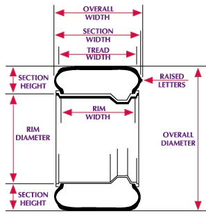

The sidewall number is Section Width, but most of us care about Tread Width.
Tread width is a hard number to pin down because the shoulders of tires are rounded. That's why Tire Rack has their angled measuring jig to get a reasonable estimate.
