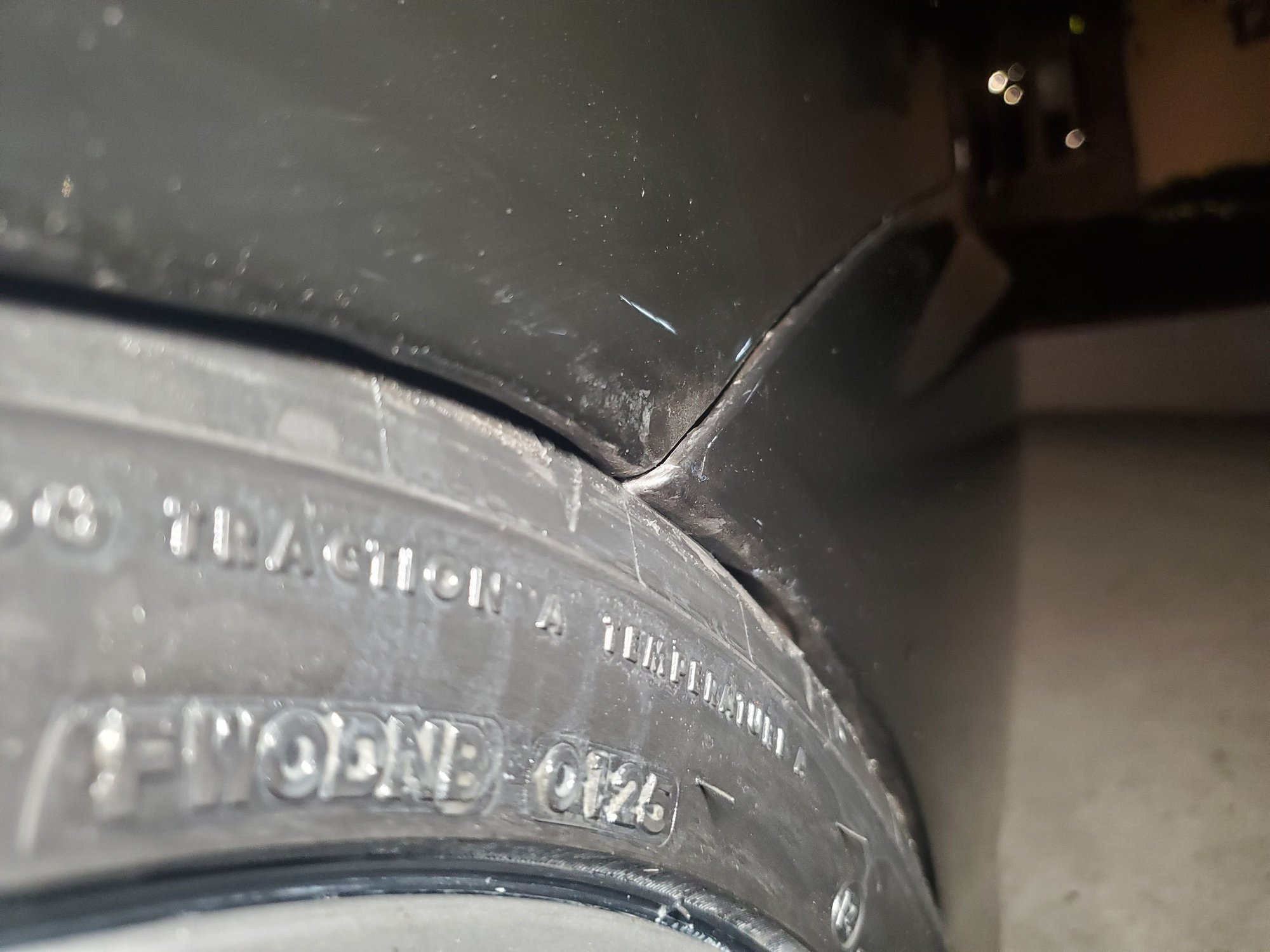

Well damn, it's close, but not done yet. This is either -2.2 or -2.7 camber in the rear, maxed out. It's just that bumper tab area that's the problem. Maybe it needs to be cut and folded flat back there. I'll speak with a surgeon.
Also, maybe I should try lowering it instead of raising it? I added 7.5mm to my corner balance height before the previous set of photos. (In these pictures it's pushed up on a driveway.)

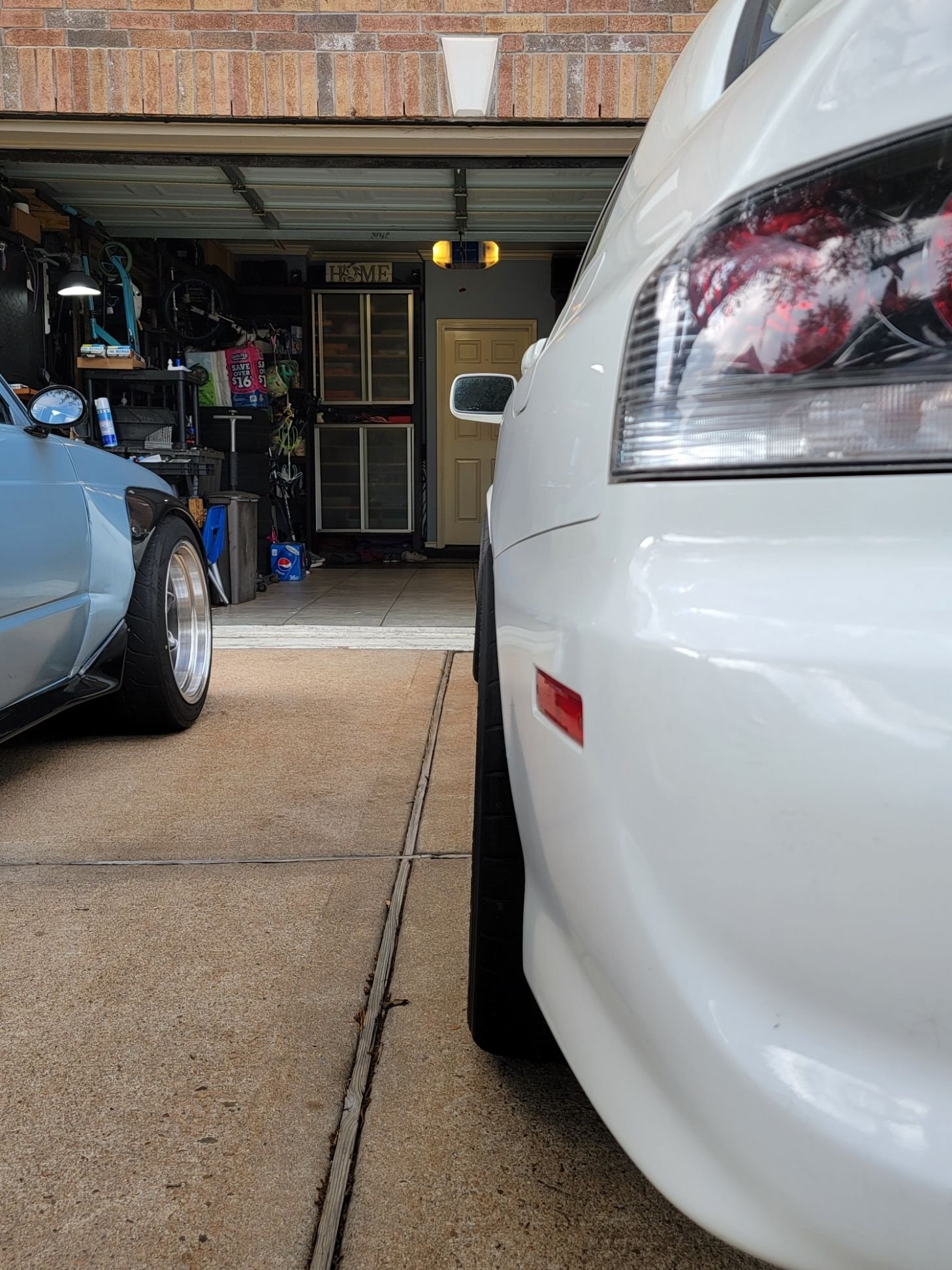

I still get some rubbing running over kerbs or some extreme dip on the highway with tools in the back
2.5 rear camber. I cut my fender lip more after this pic
Is there any room on the inside if you had higher offset wheels? Or do you think you're at the limit of how far inboard the wheel could go?
Old Apr 29, 2025 | 09:47 AM
  #175
ViciousLSD's Avatar
Joined: Oct 2011
Posts: 3,858
Likes: 600
From: Houston
There is suspension flex to account for. so if that was my outer wheel the top edge of the tire moves outward a bit AND the forward edge moves inward ... in autox high g turns (with bumps) it may rub the inner fender(frame?) very slightly, especially with brand new tires. I might try to hammer it in a bit and paint over rub marks, but I think my wheel offset is just right for this setup up.
