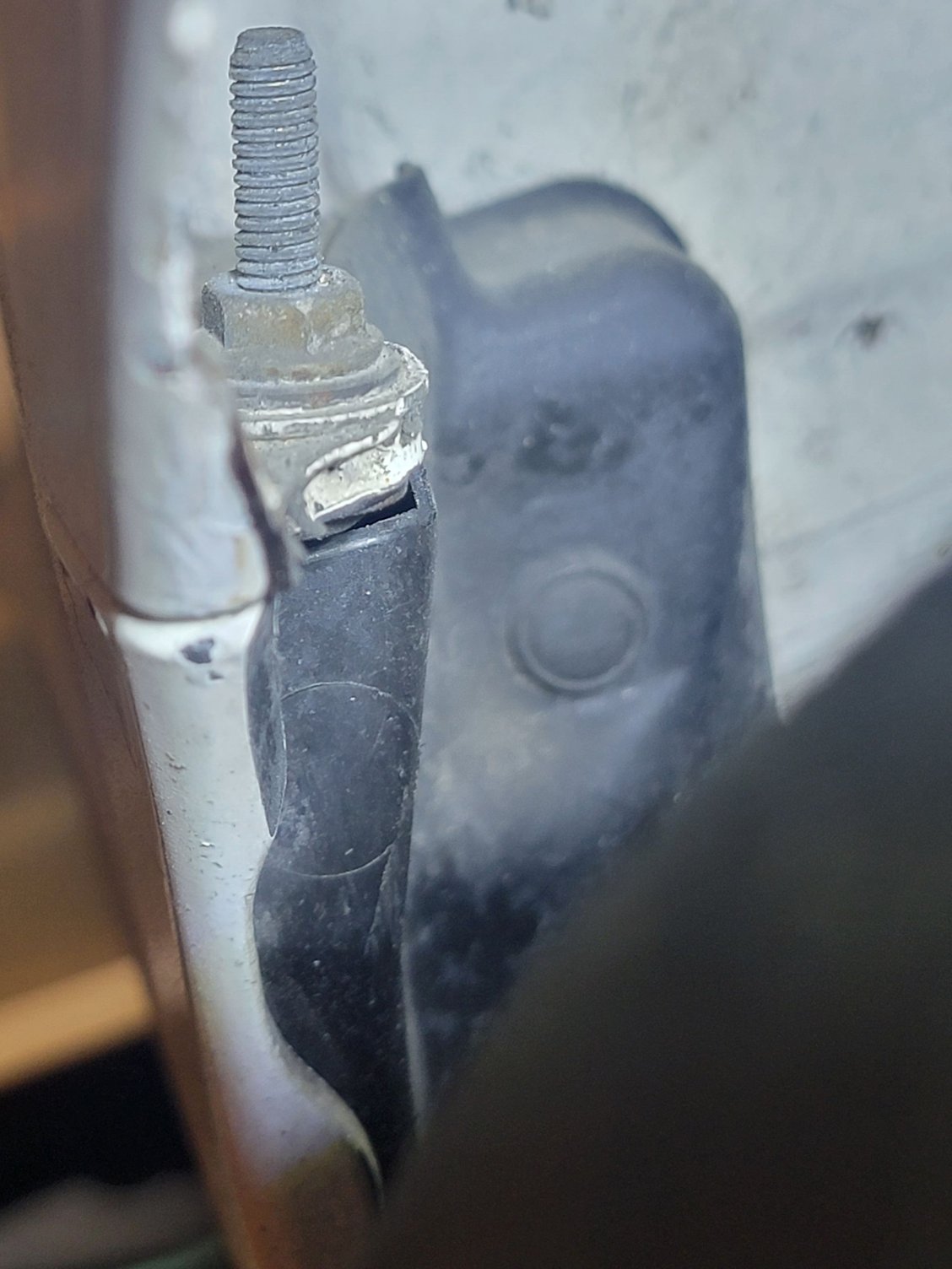

Hey. I believe I moved the bolt hole
talking about the rears, my car actually rides quite high now. previously I can fit 1 finger-bone, now I can fit my whole finger between tire and fender This is mainly because of autox.
1. some days I get enough confidence not to lift and/or be aggressive but might catch a dip mid turn and that could compress the rear (see rub pic i posted earlier). I actually turn more confidently going left thats why the right rear has the rubbing issue
2. i need my car driveable to events, with an extra full set of wheels, lots of tools, 25gal extra e85 and more. need some suspension travel for big dips on the highway
3. just enough height to clear my driveway, getting on the AAA tow bed and uhaul rental auto transport trailers
It can be lowered for hardparking/looks
when I started fitting 295s, I was on 15k springs, then 18k. now i'm on 22k. Zero toe. I also have adjustable rear control arms, eventually upgraded to SSB's. I have 18x11 wheels so the tire is not-pinched / less square which helps.
fender rolling can go really bad. I started rolling mine but I stopped when I saw the paint crack and chip off, which might have stopped me from cracking the fender.
the most convenient way to cut is with no suspension and you sit inside the fender well with a ninja headgear (i didnt do it this way first time so it wasnt as clean as I want) . maybe tape the inside fender or use the screw on the mandrel as your guide. cut one time downwards and see if you got enough lip
