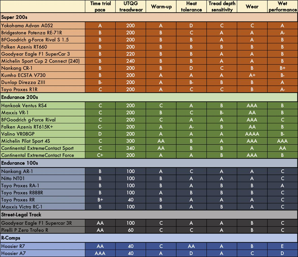

I keep hearing that the non R Supercar 3's are good for 200TW. Obviously not like the 3R's.
They are excellent. I actually have them on my car for street tires
Goodyear lists them as 220tw but they definitely fall into the "super 200" Category on that above spreadsheet. I recall reading somewhere that in a time attack format (1-2 flying laps) they're faster than an NT01.
