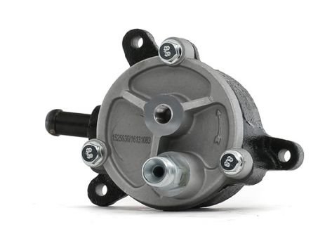

You don’t have to run Moroso. Any suitably sized brake booster vacuum pump of a Diesel engine could potentially work, only issues I can think of would be are they able to handle the extra few thousand RPMs of a petrol engine and would the seals hold up to ethanol mixed oily vapour.
https://m.autodoc.co.uk/ridex/161310...BoCXLwQAvD_BwE

why not test the theory with an electric vacuum pump? I'm not sure how vacuuming would help seeing the air wants to come out with some oil on its own

You really dont need a vacuum pump. Unless you got big drag cams we have plenty of idle vacuum and can create vacuum in the intake manifold on boost to an effect of a pretty large potential volume.
