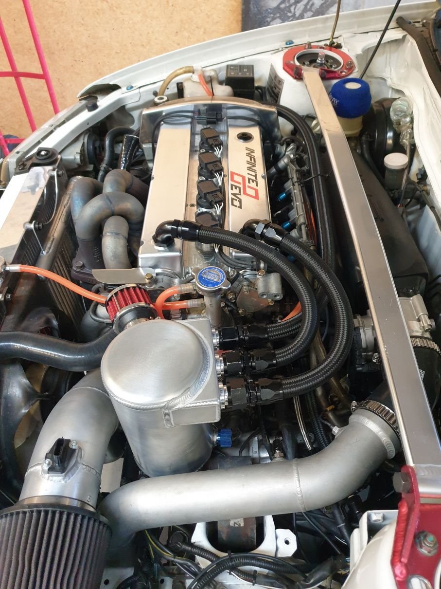

Originally Posted by RSMike
5" diameter catch can. Around 2.5L capacity. Internal baffling to pull oil vapour from the air.
10AN on the back of the can for draining and pumping (if required).
Note the 12AN line off the front of the block.
Testing tomorrow!
Mike do you sell these catch cans?
No sir.
It was a custom setup for proof of concept.
I had another customer do a breather off the block and they went from 700ml in the catch can after 5 laps to 100ml after 5 laps.
Breathing off the block (FRONT OR BLOCK!) is the way to go!
would you still recommend this with a dry sump?
Now you have tested that, are you still manually draining between sessions or draining back to sump? If draining back to sump, does your sump come with this option?
I've got a drain at the bottom of my catch can, it's passive and will drain between sessions
It depends on the dry sump system.
Norris Designs says to vent their system, because it doesn't generate proper vacuum in the block. So on the front of the block is probably a good idea.
A Dailey System you could probably run a breather off the head, but it's got a valve in it. So it only opens when there is too much vacuum.
