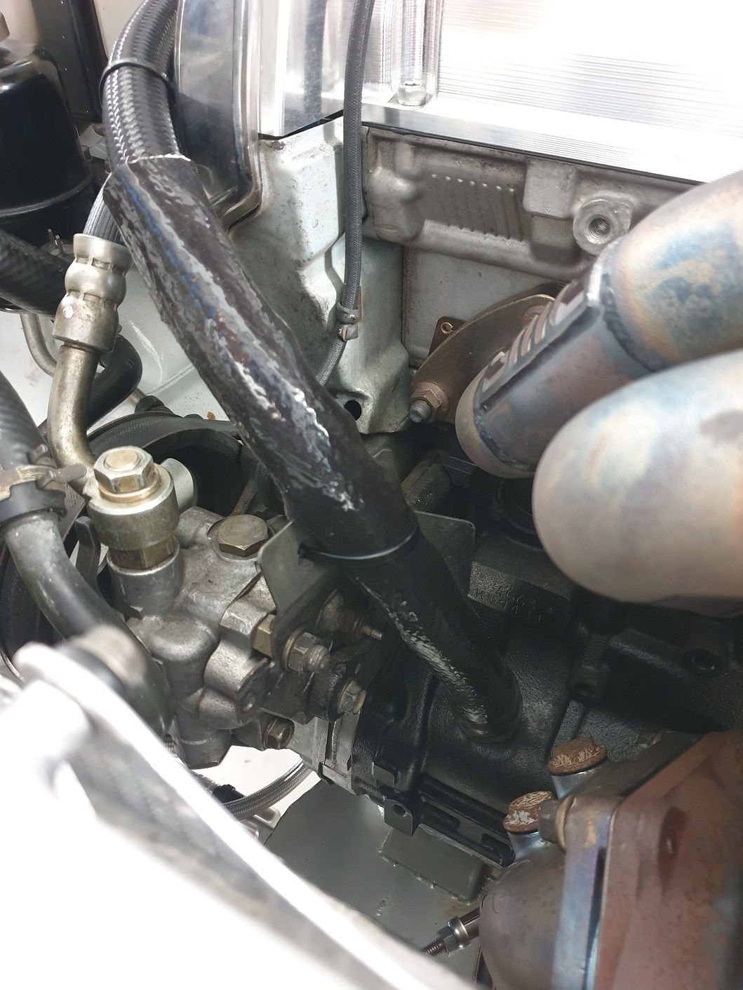

Hose fitted to the block with fireproof sleeving. I might do a head shield and bolt it onto the block. will probably get hot there.
Going to get the new catch can fitted this week, will update with pics and info soon.

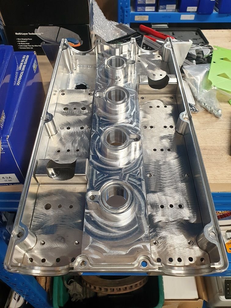

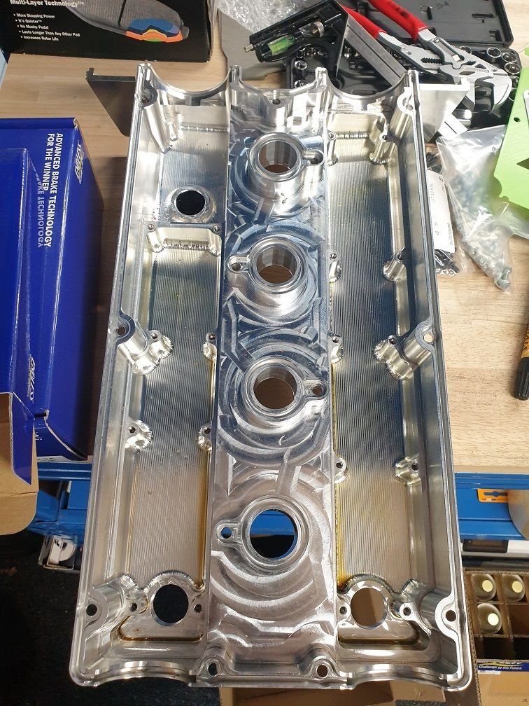

Pics of the Hypertune Rocker cover and baffles.
Hypertune cover with no baffles installed
fuel tank foam installed to help with oil being pushed out the breather lines
extra holes drilled into the baffle plates to help with draining oil that gets above them
