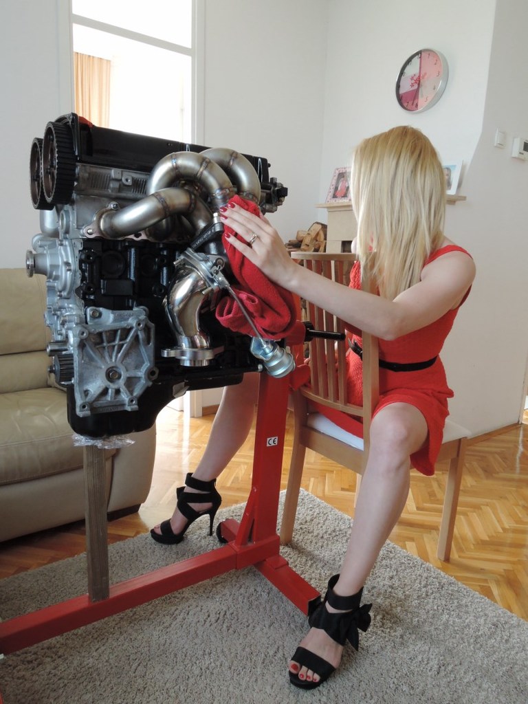

Wife was very busy yesterday with cleaning

Beautiful build, though my Mrs happened to look over the shoulder as I scrolled past the pic of your wife and wanted to know what I was up to :P
Noticed you have the manifold/turbo temp fitted to head, guessing without gasket.
Might be an idea not to have it live like that for an extended period, lot of weight resting pretty much on two studs, against a nicely polished flat soft alloy surface.

I have put several layers of oiled paper in between so it's not metal on metal
But I dont think it will bent over time. might add another washer
