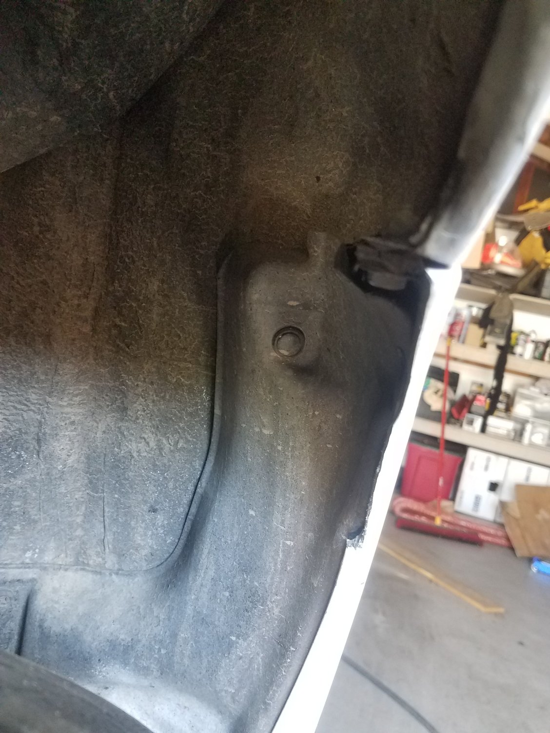

I sold off the 17x9.5 +38 RPFs with 255 NT01s and picked up 18x10.5 +38 PF01s with 275 NT01s. The wheels originally came with 315 NT01s, which I did a test fit for the hell of it. Bad idea. While trying to drive the car to the tire shop, I started burning the paint on the rear quarter panel, where it was resting on the tire (I hadn't finished rolling/pulling the quarter panels).
So, I had to roll the rears completely flat, then keep bring out the roller until the quarter panels "popped" and came out. The paint was thrashed, since I didn't care enough to use a heat gun. so, I touched up the paint with with primer/paint. That made it really easy to tell if anything was still rubbing. All clear.
I did take a heat gun to the rear fender liners and had to trim the bumper a bit. My friend cried because I cut up a JDM bumper. Oh noes! LOL.
This did require @Dallas J SSB rear trailing arms (see pics) and a 20mm spacer up front. I didn't need the full 20mm to clear the brakes, but I think I needed it to clear everything from lock to lock. I plan to experiment, though, since I'm still rubbing plastic somewhere; I think it's the inside fender line, next to the frame. One pic shows clearance with the 315 tire, so you can imagine how much there is with a 275.
SSB vs Stock. Worthwhile investment.
Clearance with a 315 tire. Plenty o' room.
275s before I finished rolling/pulling the rears.
Testing lock-to-lock clearance. All good.
I had to heat up the liner under the bumper bolt. It was a convex area that rubbed, and it now concave. I also had to trim the bumper cover to avoid self-clearancing LOL
