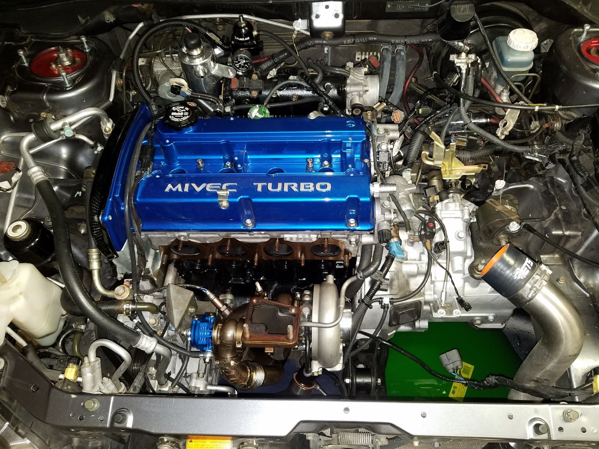

Stripping the engine bay again.

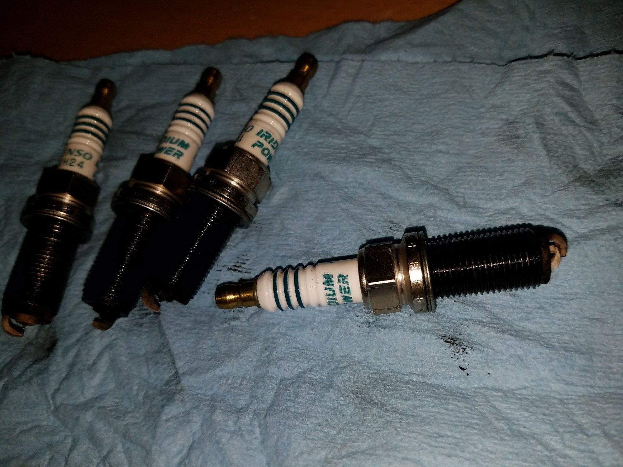

3/4 plugs covered in oil and 1 insulator broken. Good thing I stopped driving the car after we moved.

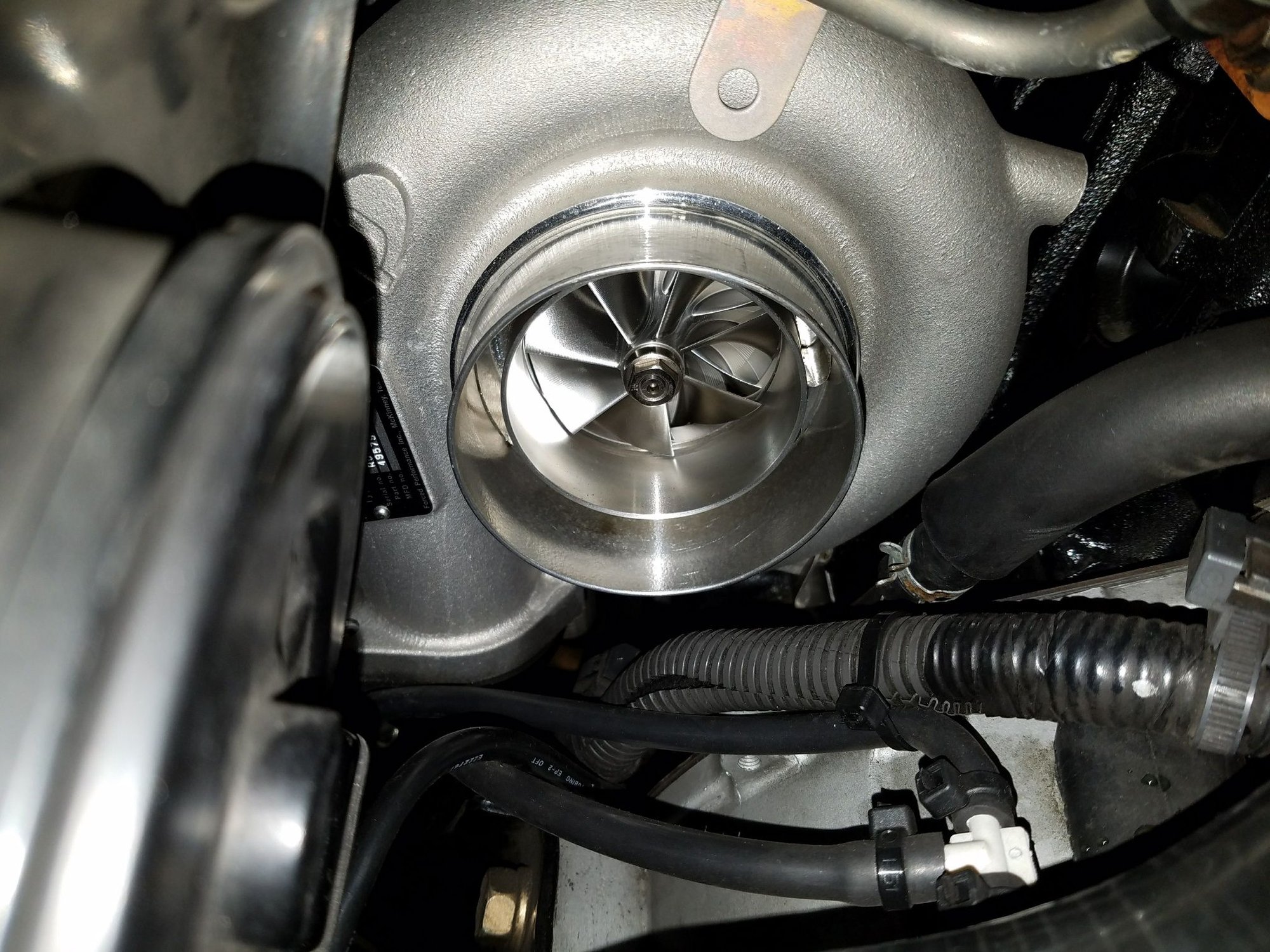

FP Black looks like day one, although I bet there is burnt oil caked up inside the turbine housing. Compressor housing looks clean as a dinner plate.
Stay tuned for more. Once I pull the block, i'm going to blueprint it completely and compare my results to those of MAP.
