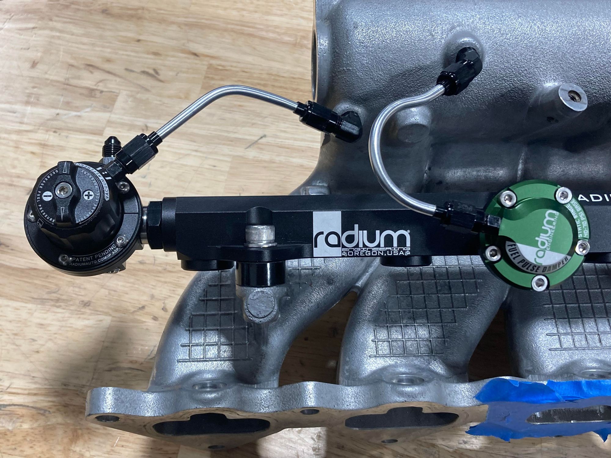

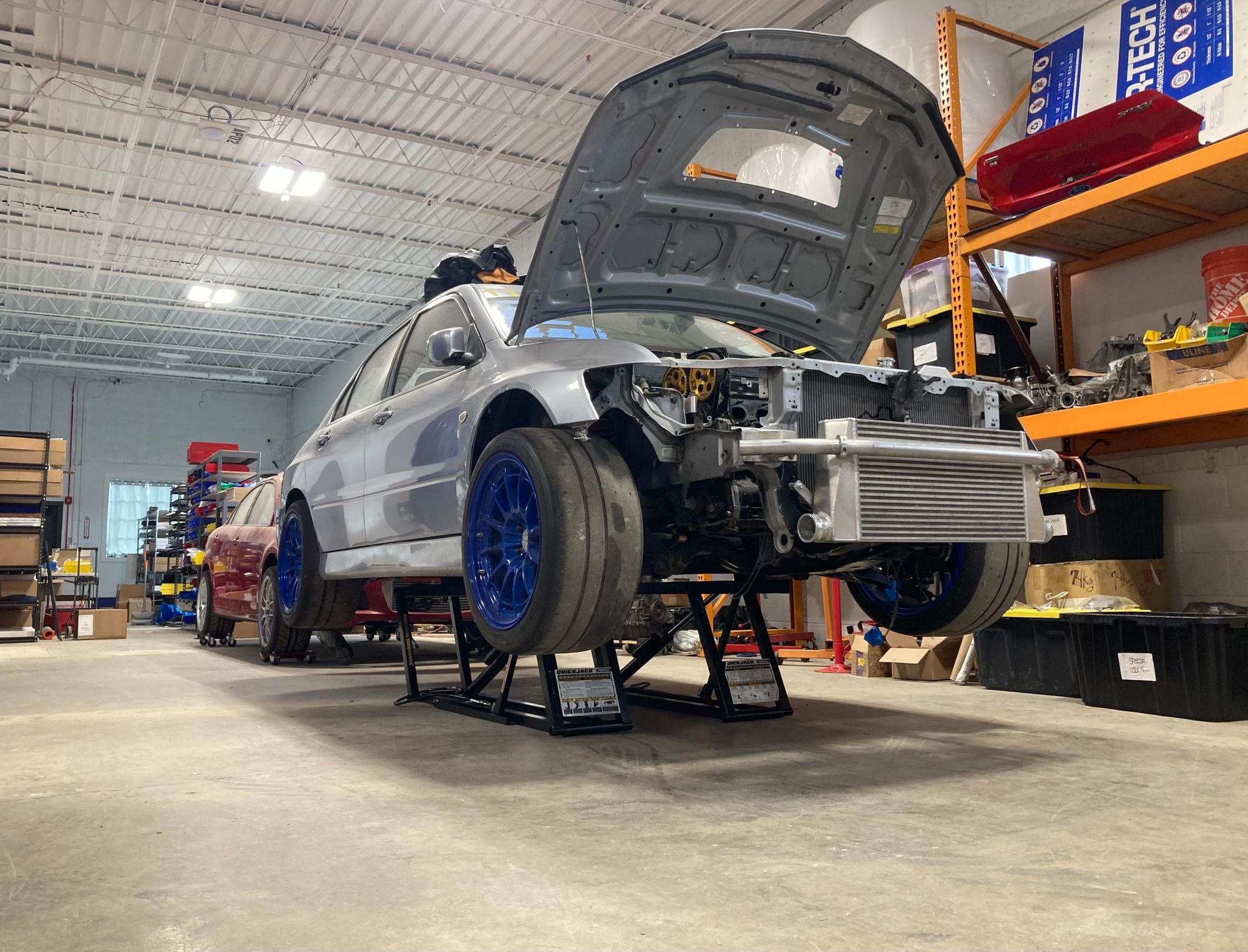

Well it's been over a year so I suppose I should start posting about this thing again. It's in our shop now and I'm starting to chip away at my to-do list. Lots of parts to scan and design but they're starting to come along now that we're settled into the new shop space.
New intake setup is nearing completion, just need to finish porting it. I wanted to get some experience with making AN hardline so I made some for the fuel pressure regulator and fuel pulse damper. Definitely took longer than I would've liked but I also probably should've done a better job at measuring lol. These lines are so short there isn't really much room for error and I had to bend everything by hand since the angles are so weird, took a few tries and I might redo the regulator line again but I don't think it's worth spending more time on it than I already have.

Don’t you love the radium stuff? Not having to find a place to mount the fpr is so nice.
Old Oct 29, 2024 | 07:02 AM
  #582
Ayoustin's Avatar
Joined: Jul 2014
Posts: 2,989
Likes: 648
From: SC

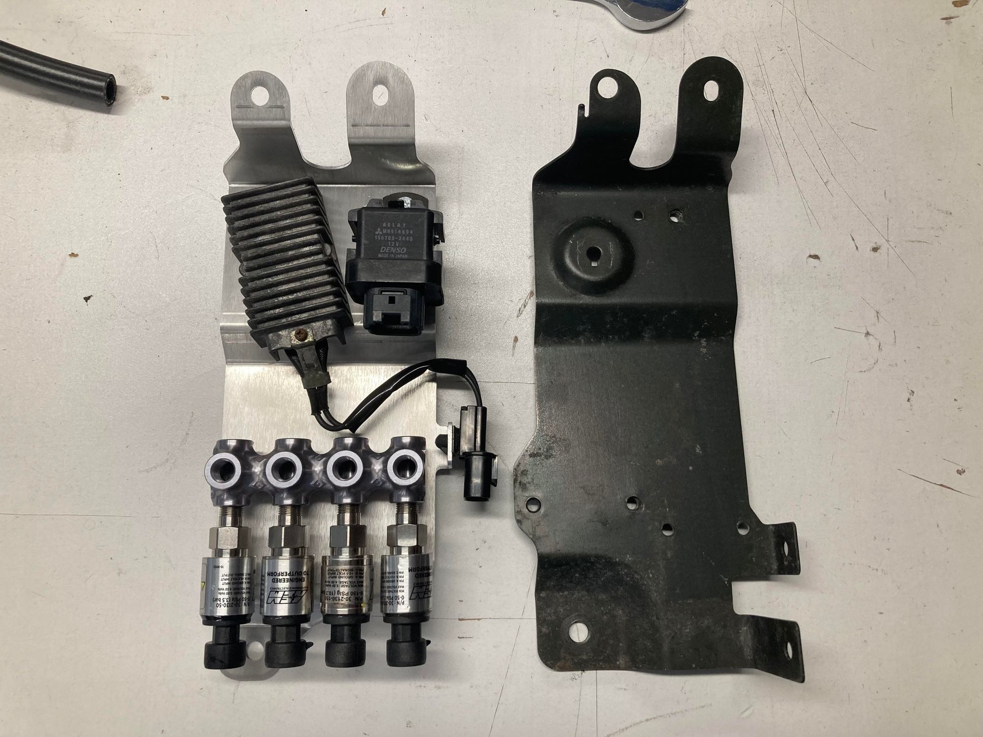

Yea the direct mount stuff is very convenient. I also like their new regulator design, just have to turn the knob to adjust pressure, no more messing around with a jam nut and needing a gauge to set fuel pressure. The knob has a detent in it so each click is a pound of pressure. The 3AN coming off it pointing backwards will go to a pressure transducer mounted on the firewall so I'll be able to log fuel pressure and set safeties for it.

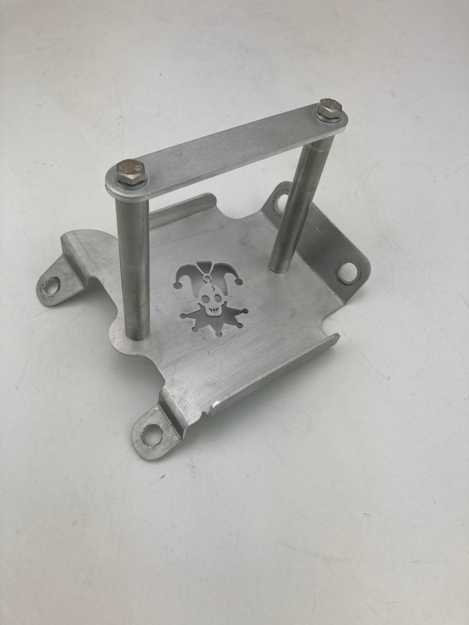

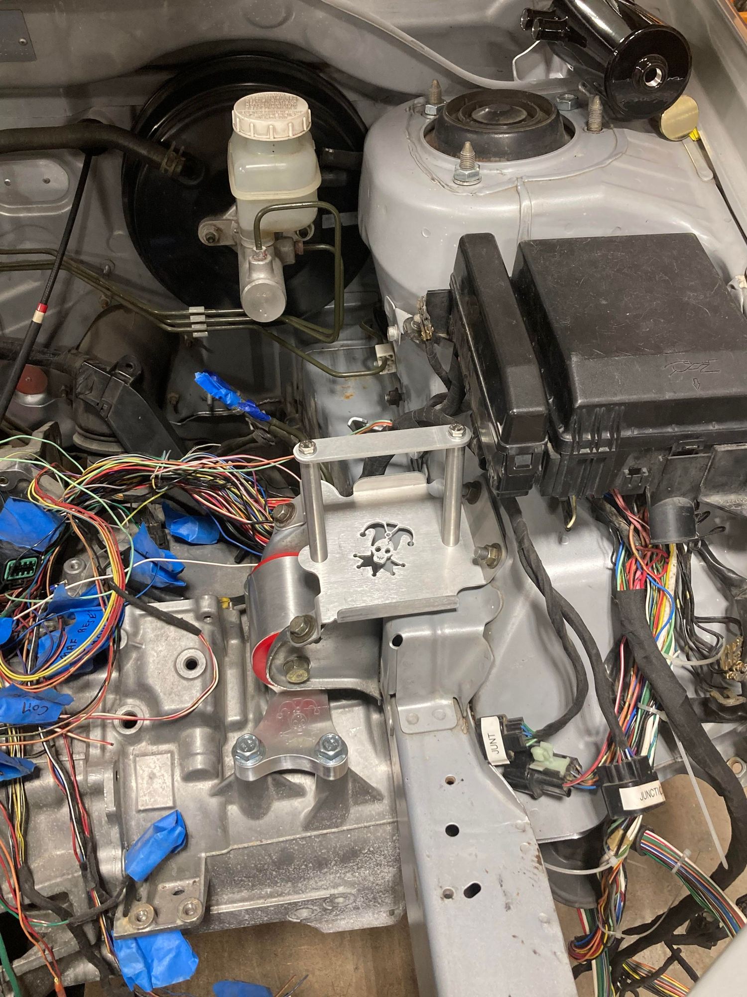

I wanted all of my pressure transducers to be mounted together in one spot and keep them off the engine where they'd be isolated better from vibrations so I redesigned the plate that bolts to the firewall that holds the resistors and relay for the fuel pump and injectors. Made it from aluminum to shave some weight and now it holds my transducer block (boost pressure, fuel pressure, oil pressure and coolant pressure) and the fuel pump resistor and relay.
