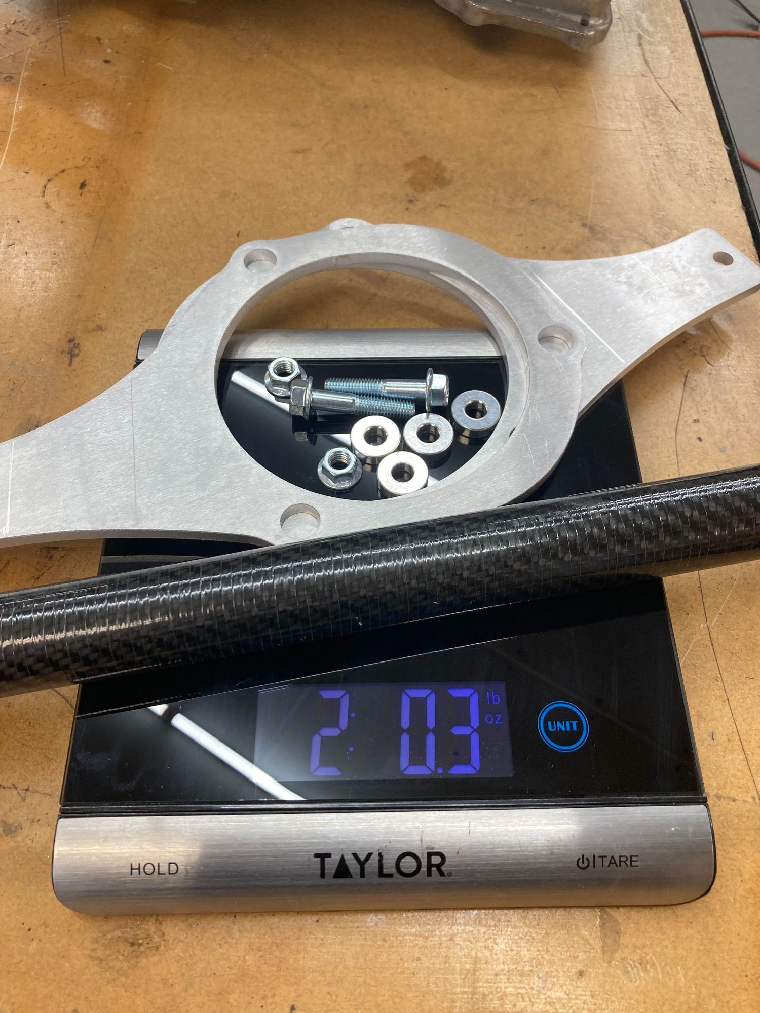

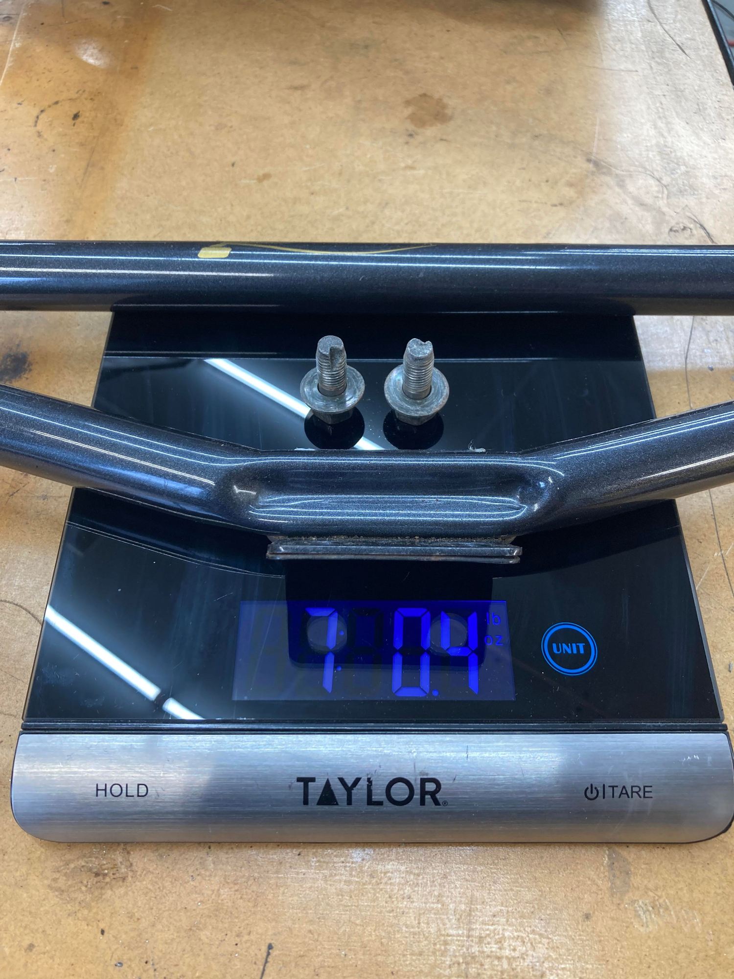

I picked up these old carbon bars from a Nascar auction recently and decided I could make strut bars out of them. Total assembly weight is 2lbs vs the stock bar's 7lbs and makes working on the rear of the engine bay way easier since it can be removed with just the two bolts. Pretty pleased with how it came out. If anyone is interested in one I have 5 to sell so shoot me a message.

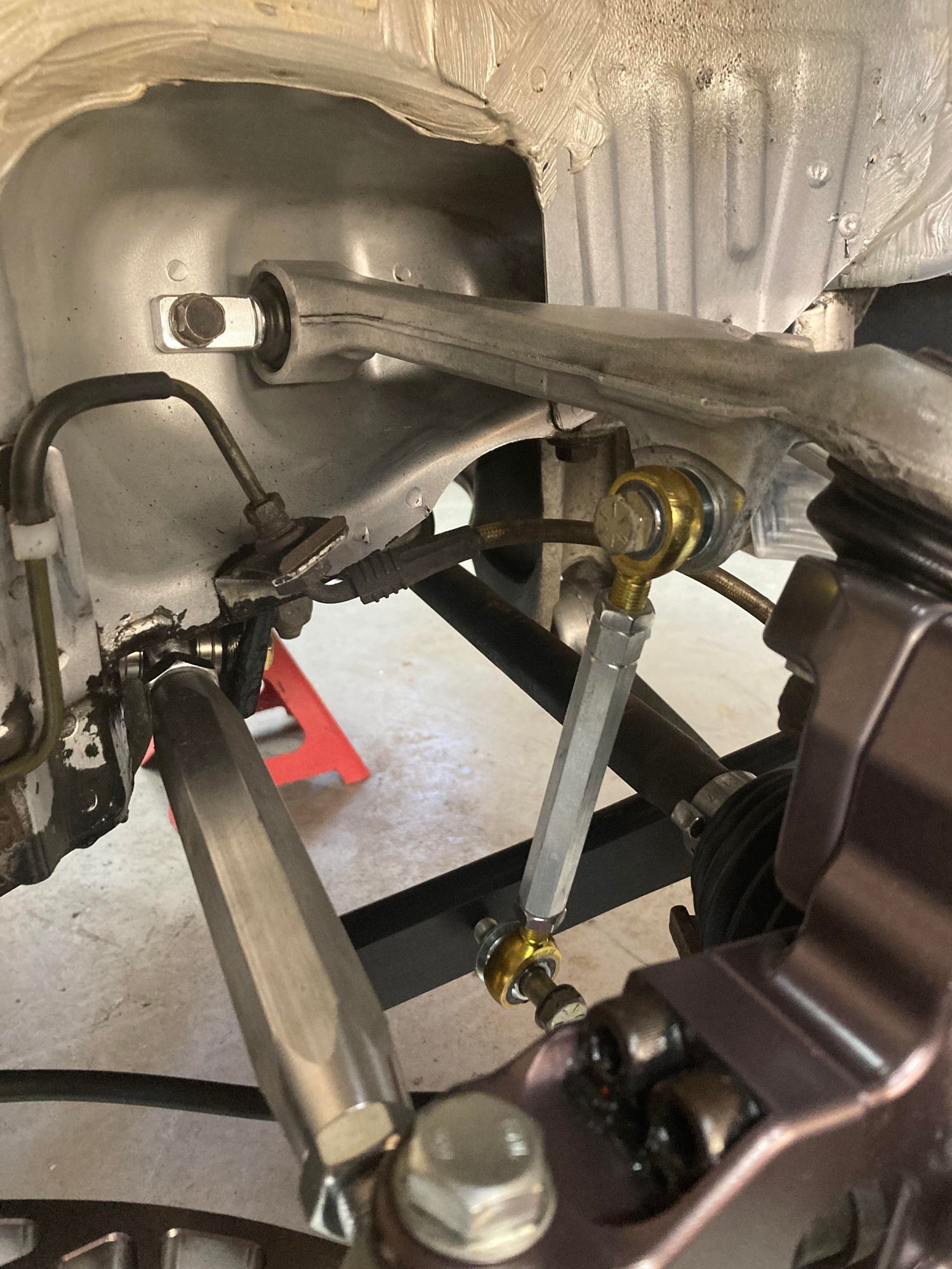

95% done with my custom rear sway bar. Designed some custom mounts that Dallas machined. Speedway bar and arms. Rough calculator math says spring rate adjustment range should be 300-500ish lbs/in. 1.25" bar with 0.25" wall thickness can go up or down in thickness if I need more or less rate. Just need to drill the holes in the arms for the endlinks and it'll be done. A bit porky at ~16lbs but it's about as low and rearward as can be so I don't mind. Still unsure if the two bolts in the subframe will be enough to handle the load but only one way to find out really.

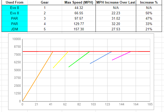

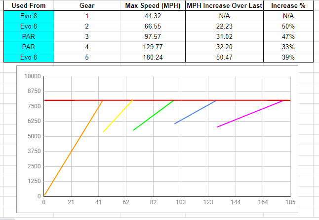

Been a minute since I've updated. Car is hiding in storage again, which kind of sucks but that's life. Biggest (expense) hurdle is getting the gearbox setup figured out. Going to chuck in the PAR 3rd and 4th straight cut gears so I don't have to worry about a trans failure, just trying to decide what I want to do for 5th. This may not seem straightforward but here we go.
At the moment I have the following variables to consider:
  • Tire diameter: Will either be a 285/30/18 (24.7") or a 255/35/18 (25")
  • Redline: Likely 8000 since I think the UHF SS Green won't have much to give past that
  • Track usage: Most of the tracks I frequent are smaller local tracks where there aren't massive straights, 120-140mph is pretty normal max speed. I don't go to a ton of GP esque tracks but will be going to Road America so I don't want to shoot myself in the foot with too short of gearing but the stock Evo 8 5th (0.725 ratio) I have is just too long for the majority of tracks.
My 5th gear choices being the following:
  1. Stock Evo 9 = 0.761 ratio
  2. JDM = 0.825 ratio (if I can find one)
  3. PAR = Custom ratio
I do like how the gear spacing with the Evo 9 5th looks. I think I'd only go with the PAR if I decide I want shorter than E9 and can't find a JDM gears. I haven't seen guys breaking stock 5th gears so I don't have strength concerns like 3rd and 4th.
And here's what all of these look like with the 8000RPM redline and 24.7" tire. in order of JDM, Evo 9, Evo 8 (too big of a jump from 4-5) Open to any input.

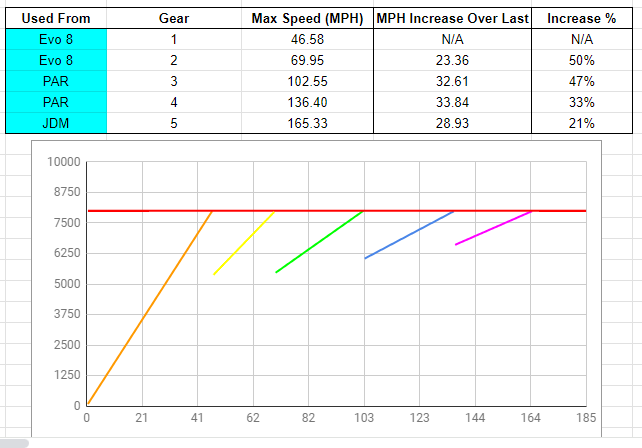

Would prefer to stick to stock final drive. Would only really consider changing it if the one in the trans needs to be replaced. Would go 4.31 for sure though as the JDM 5th seems just right with that combo but not sure I want to give up acceleration in 3rd and 4th. Who are the preferred options for FDs?
Here's what 4.31 and JDM 5th looks like:
