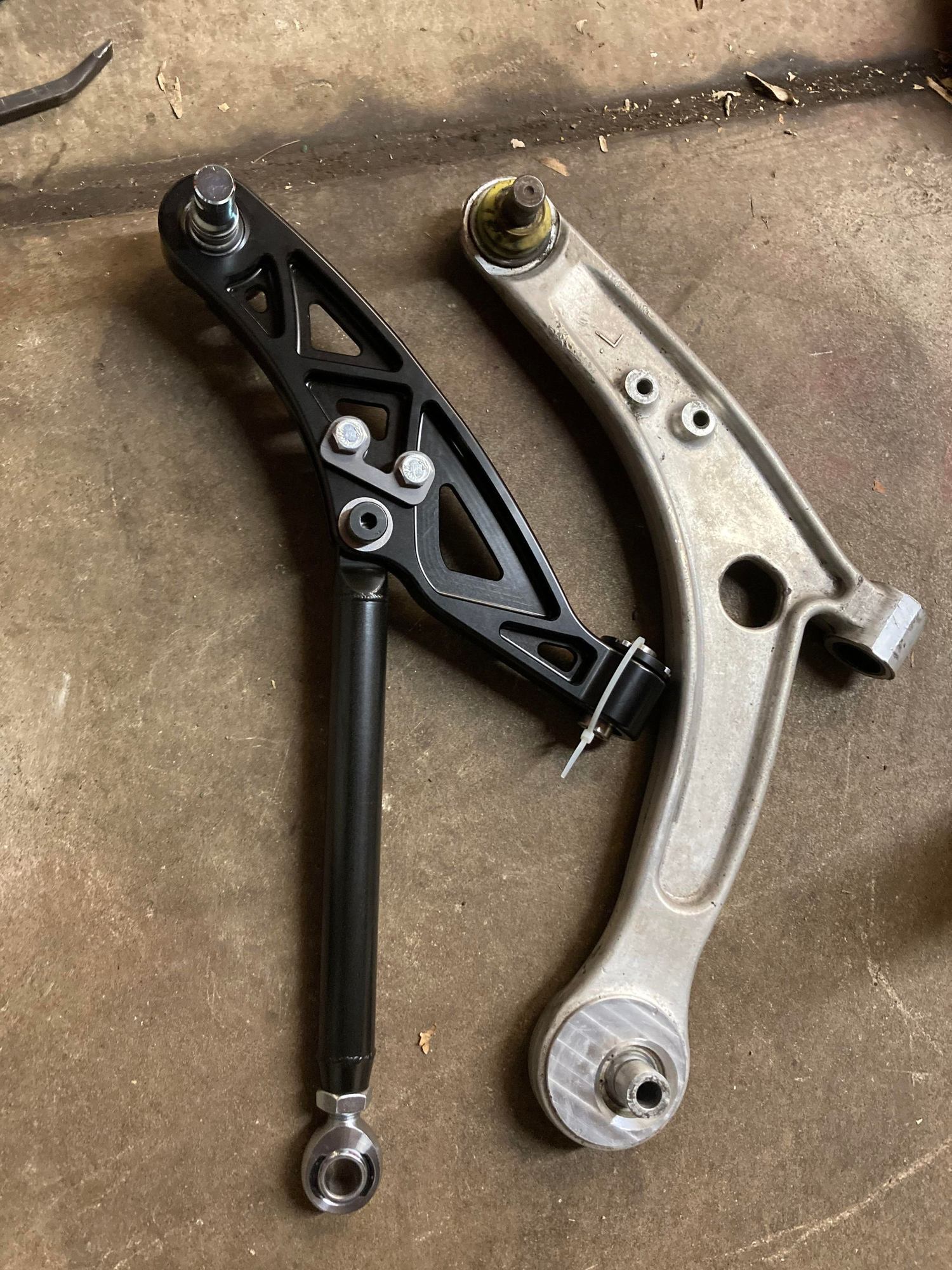

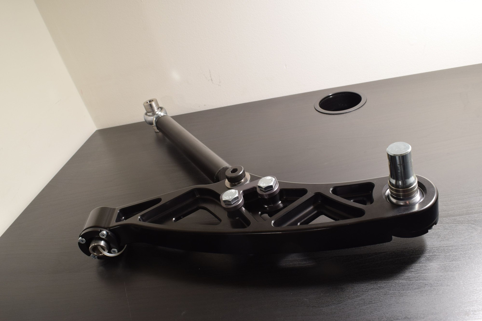

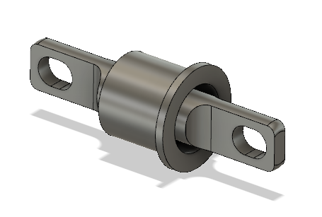

Picked up a set of SSB front LCAs for black Friday. Got them installed today. Got my design done for the rear upper control arm and shock mount spherical bearings. Need to get those made soon so i can throw them back on with the new rear uprights and finish up the splined swaybar I'm building. Steady as she goes.

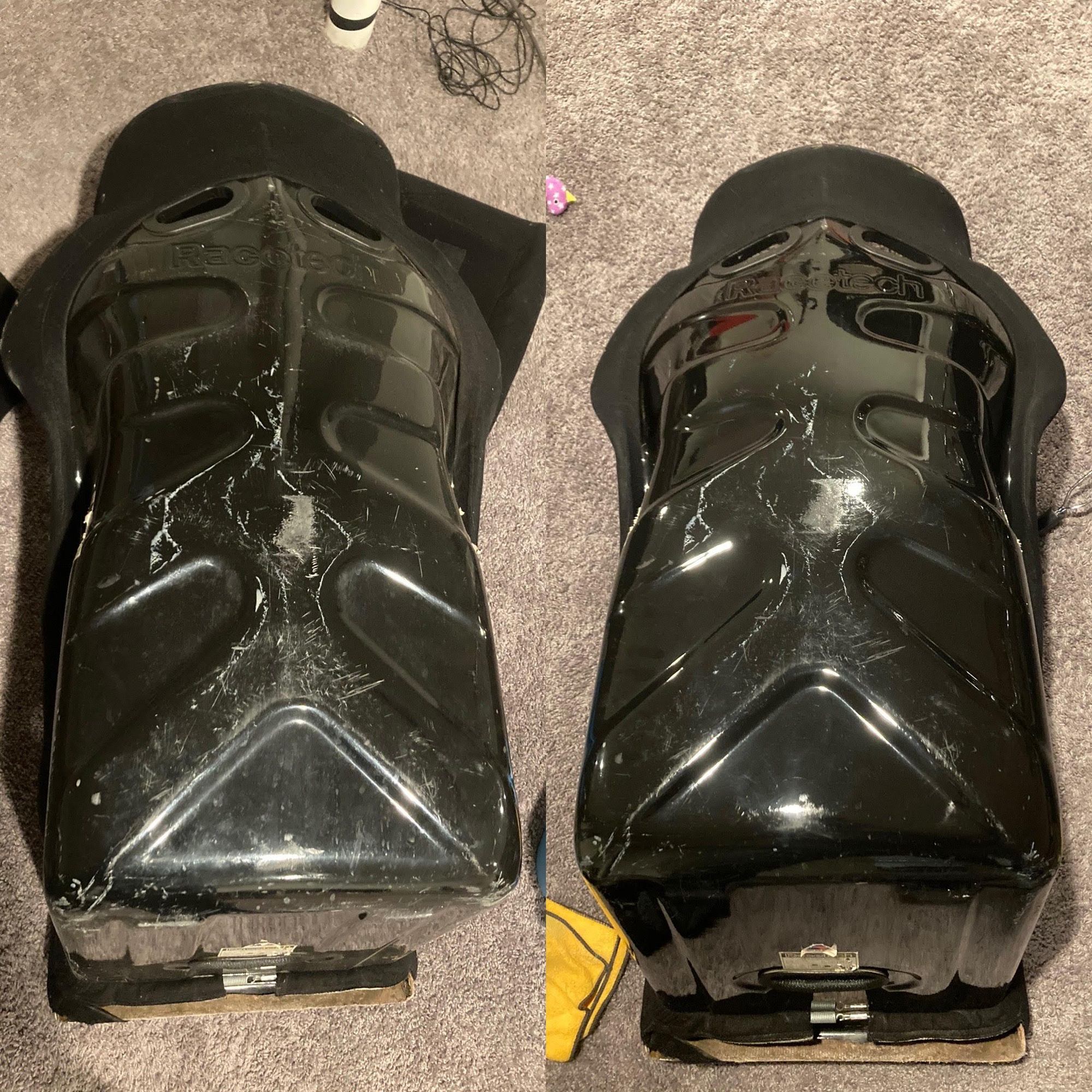

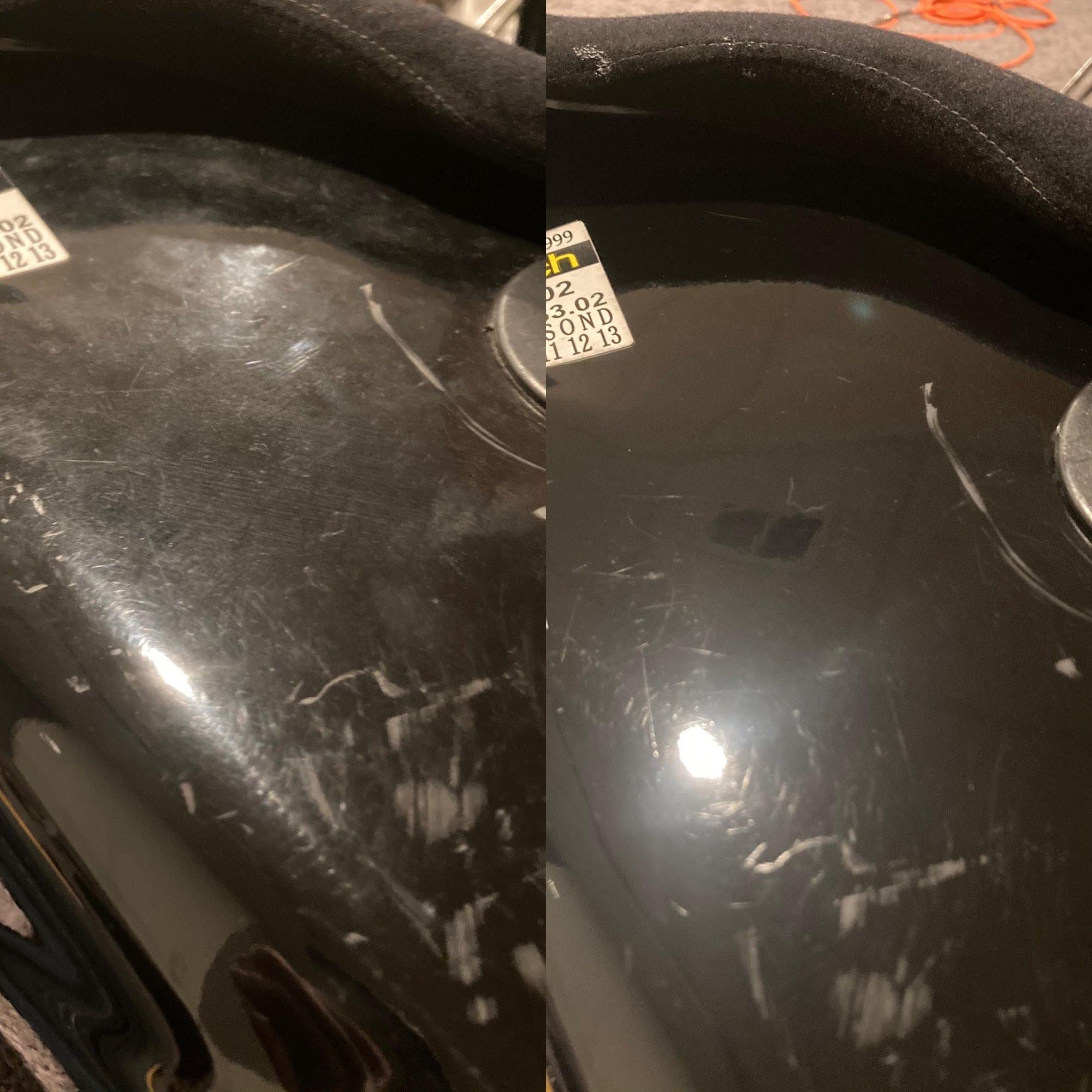

Speaking of saving money. I bought another seat hahaha. Stumbled across a deal on this Racetech 4009HR last week and couldn't pass it up. Was eyeballing a new one of these last year to replace my current 4009 (non halo) but I wasn't keen on spending $1400 for it. Seller had it listed at $250 plus shipping which was another $100 but I couldn't be happier. A bit rough around the edges and the cover has seen better days but a thorough cleaning and some buff n polish on the backside went a long way and it looks way better now.

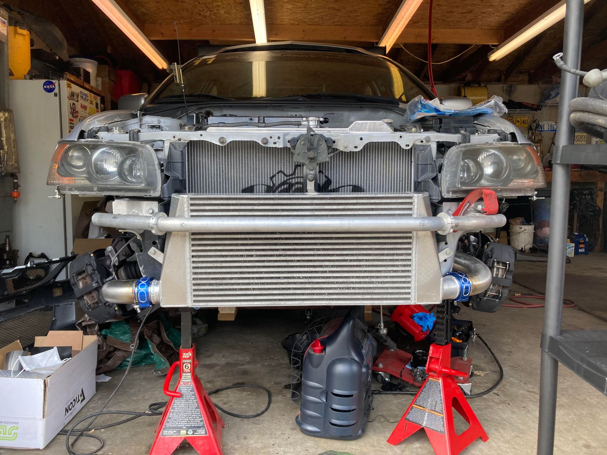

Few more updates.

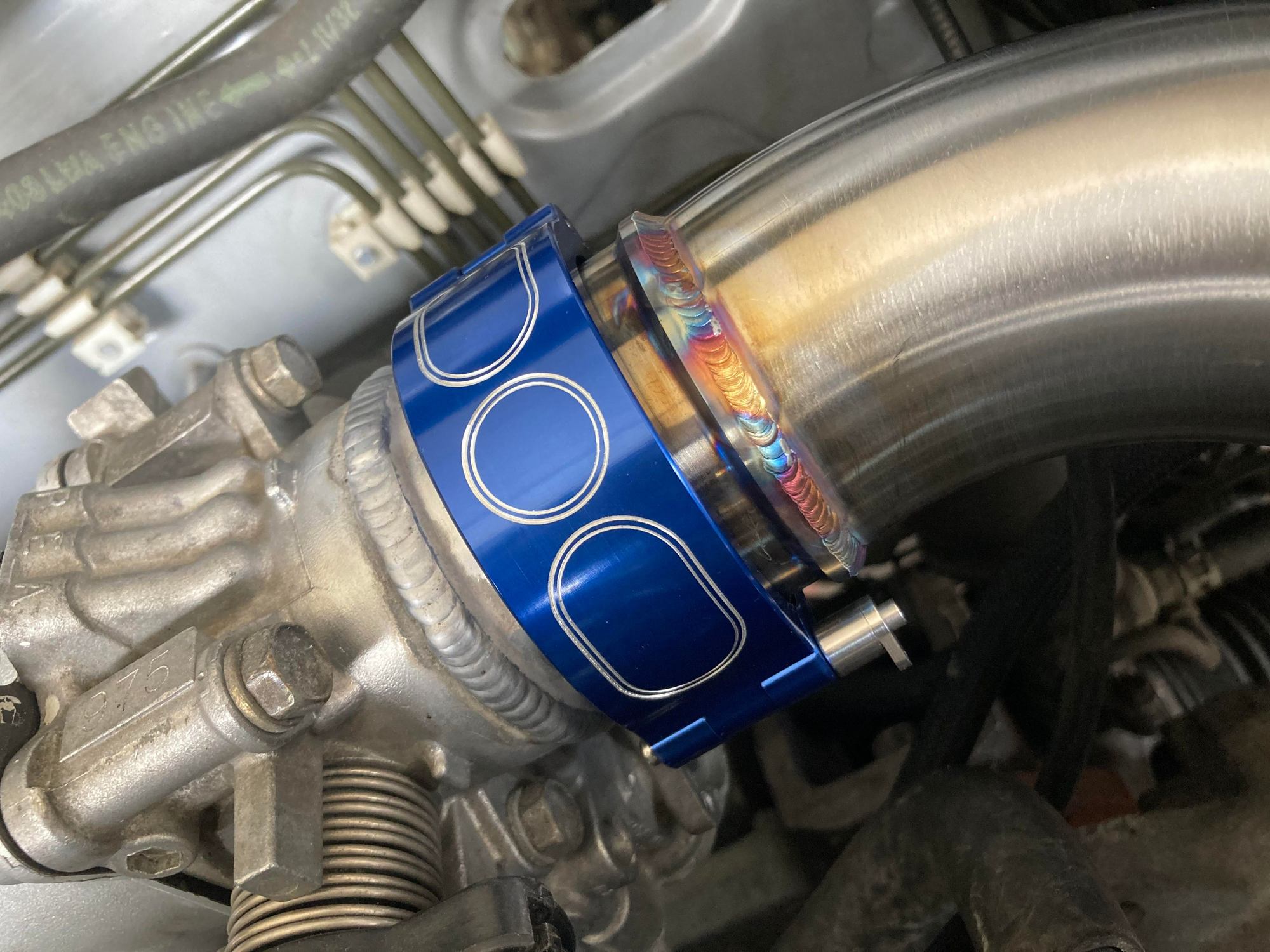

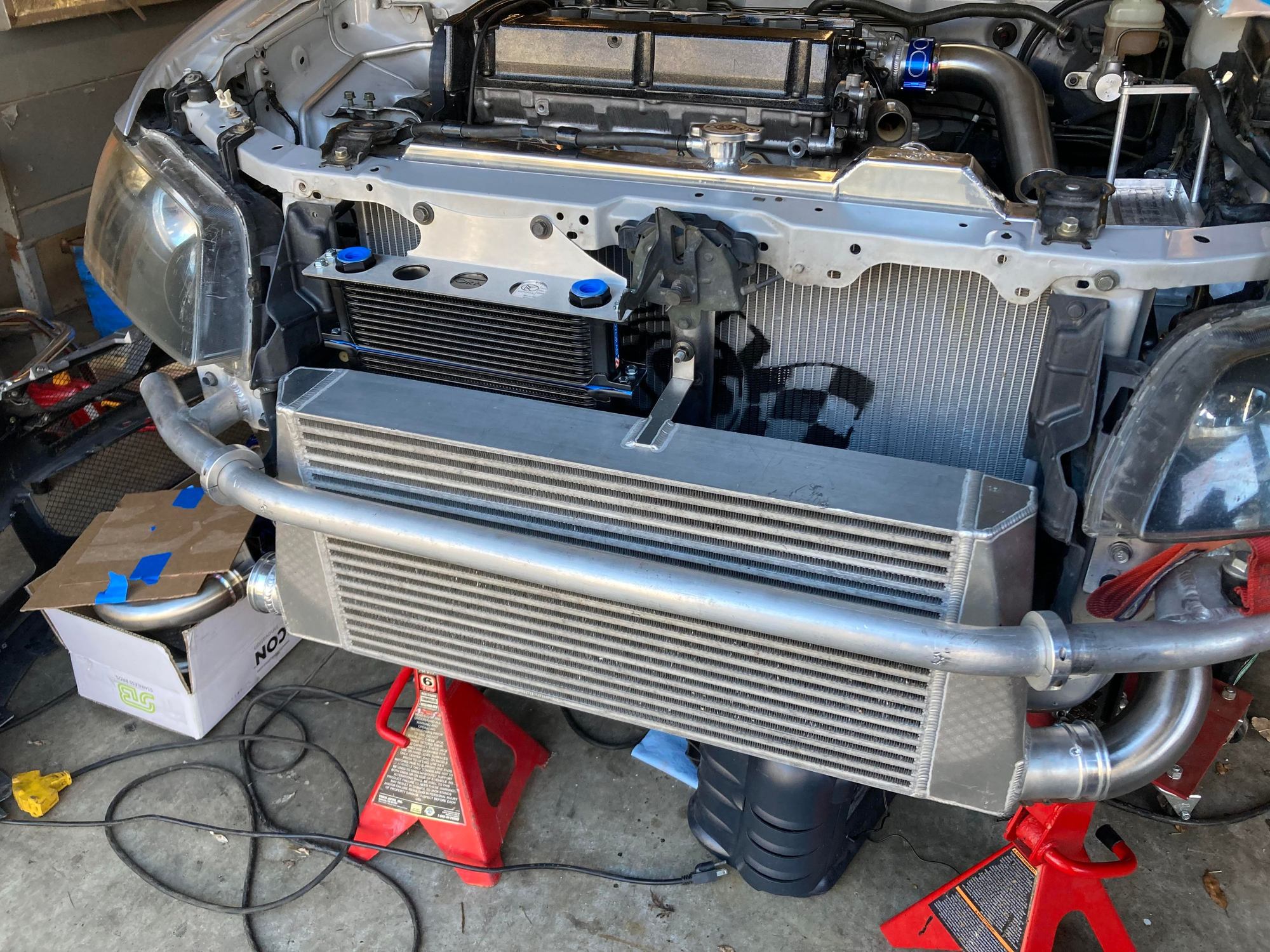

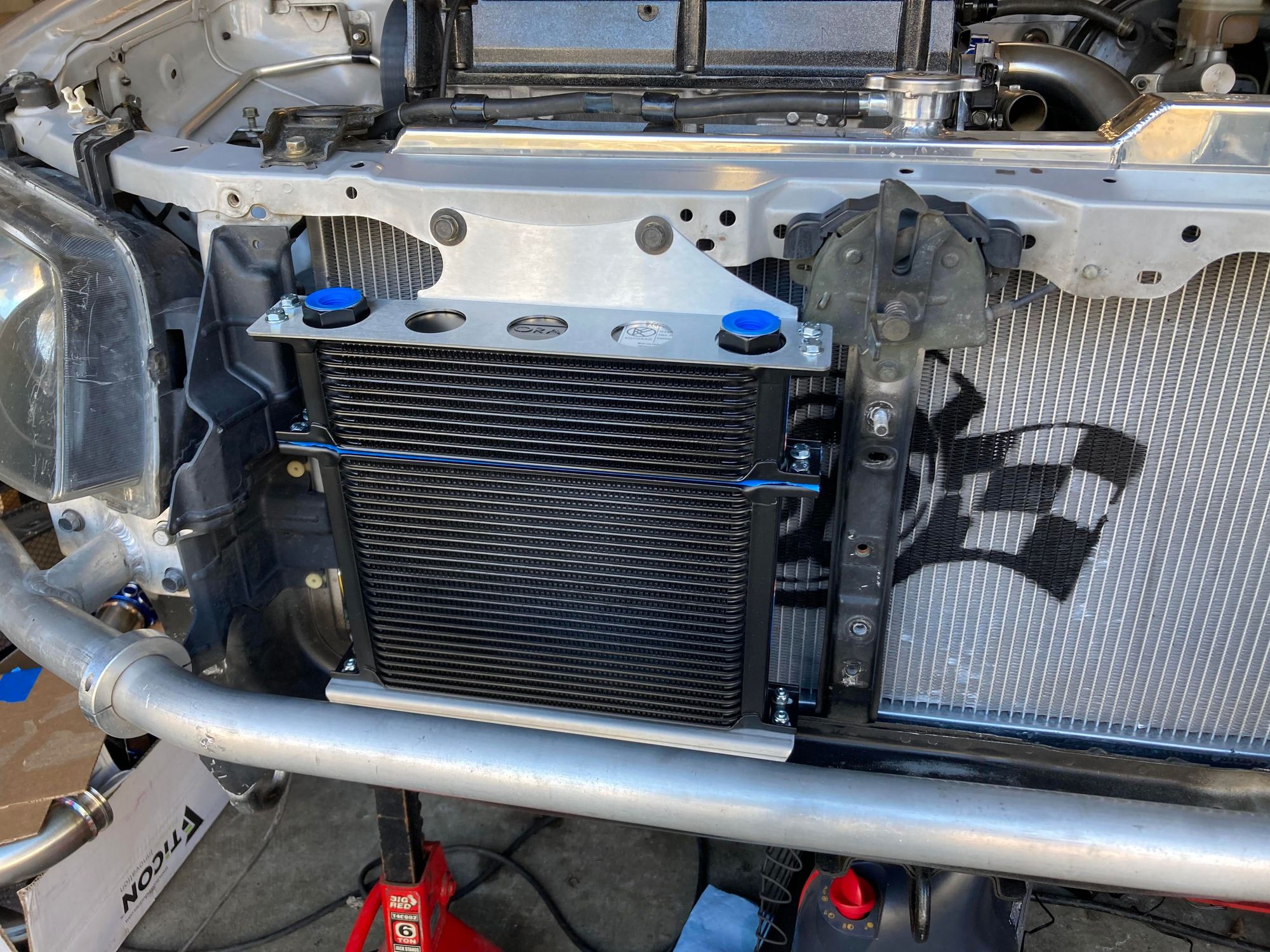

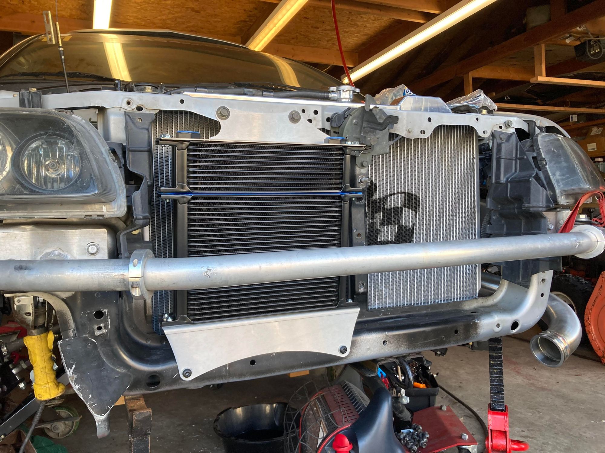

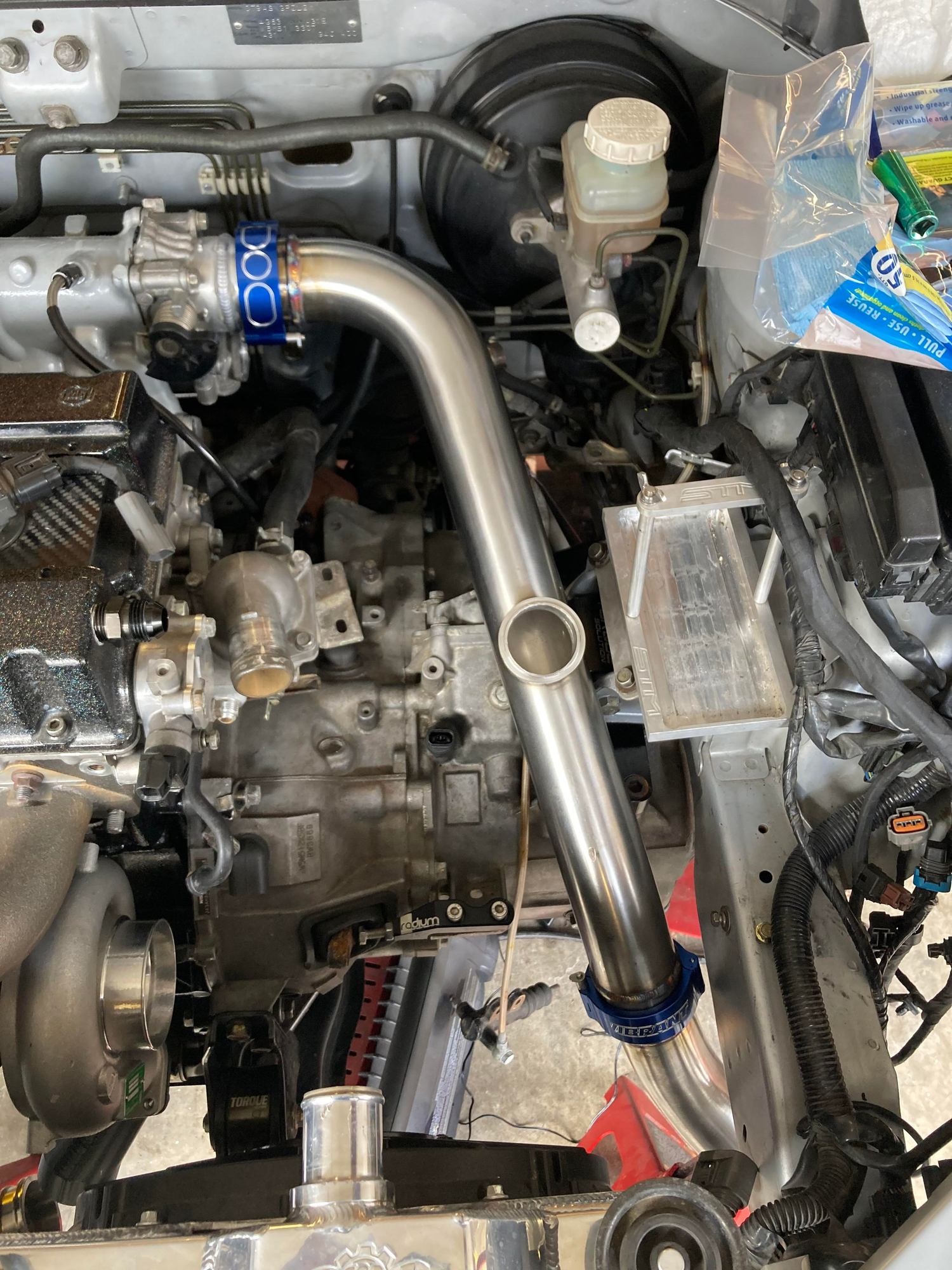

Almost done converting all my charge pipes to Vibrant HD clamps so I no longer have to worry about losing charge pipe couplers on track and taking apart the pipes won't require tools anymore. Pretty happy with how well it's gone thus far. Only have to make my compressor outlet pipe and that's all done.

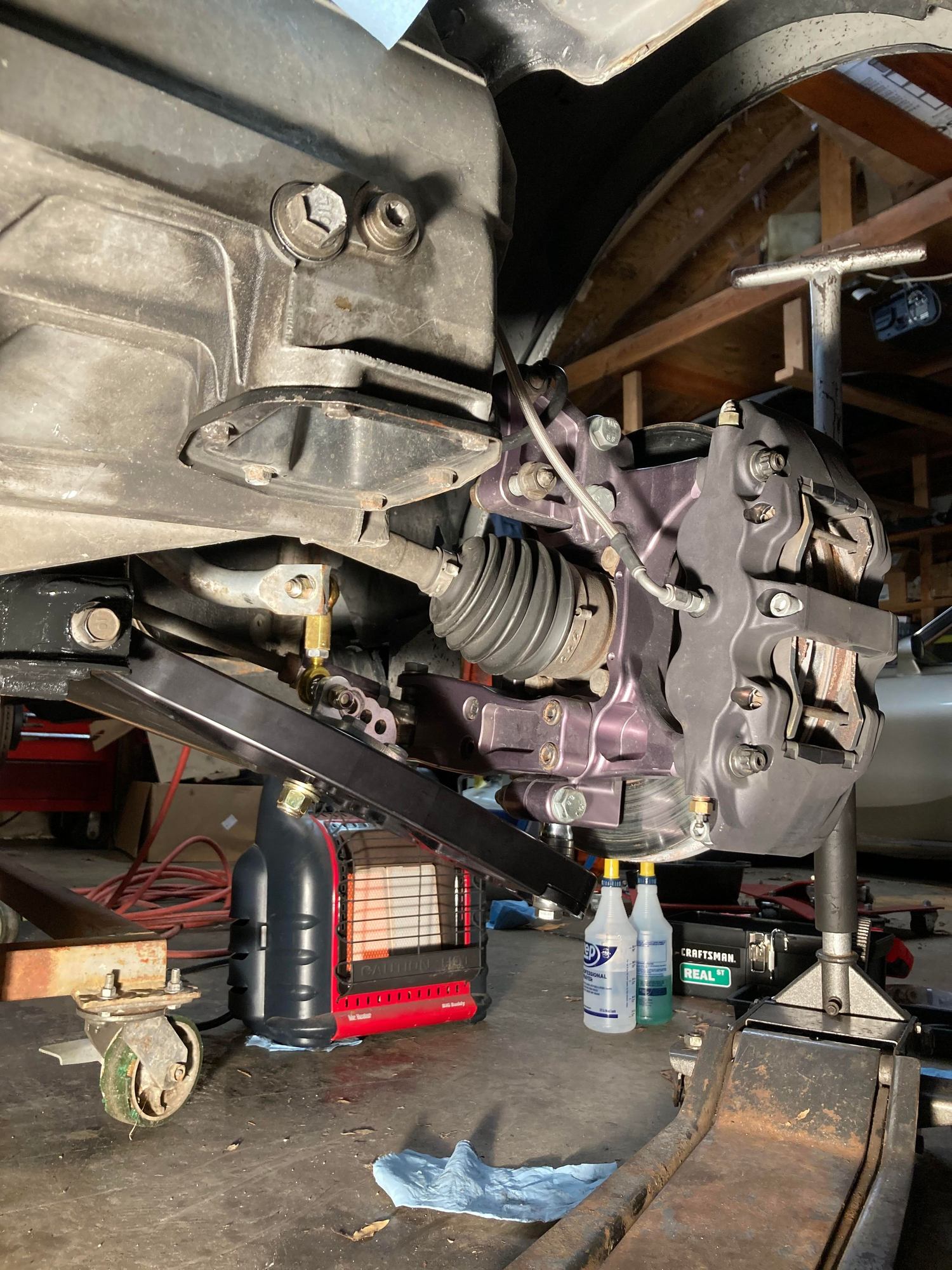

I also got my SSB rear knuckles all installed. Still waiting on my coils to get back from being rebuilt to toss those back on and have to make a bushing for the shock mount still. I also finally finished test fitting my new oil cooler setup. Super pleased with how it's turning out. This setup is exactly what I outlined above, 10 row power steering cooler on top, 25 row oil cooler on bottom. Center mounted behind the intercooler and mounts up to existing threaded holes in the core support. Still waiting on some fittings to arrive to start running lines but it's looking very promising at the moment.

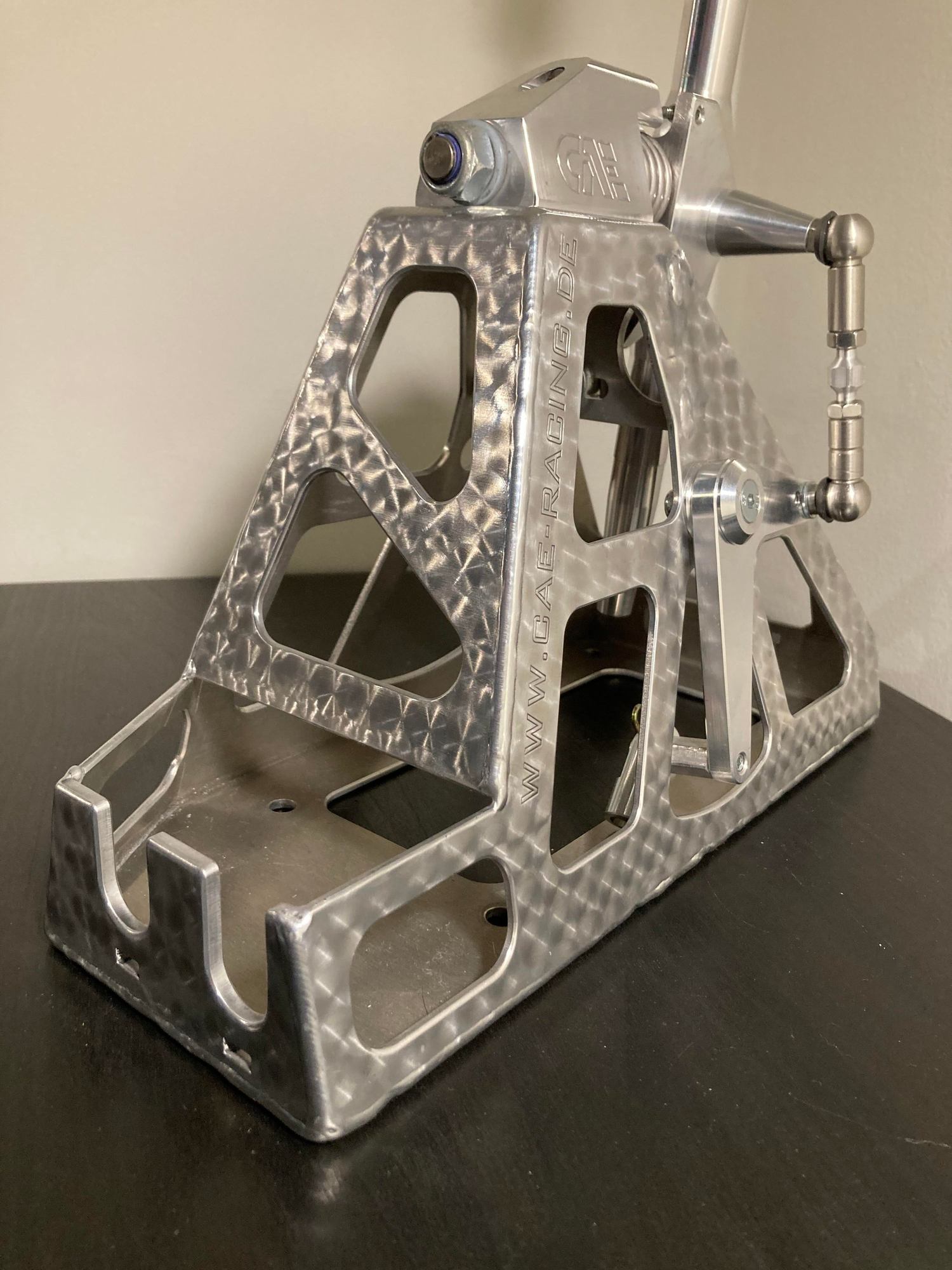

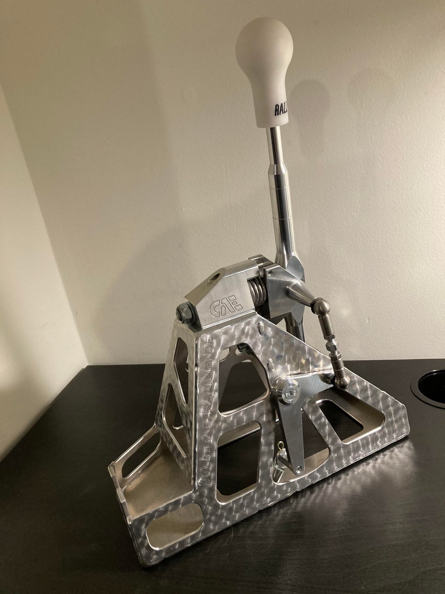

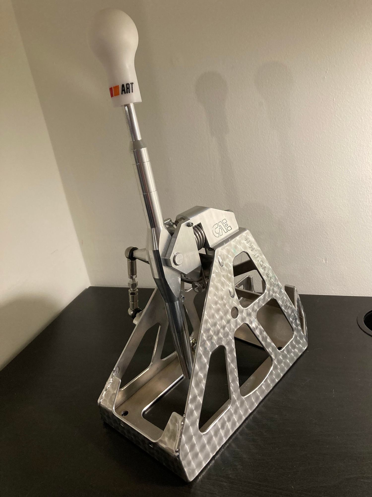

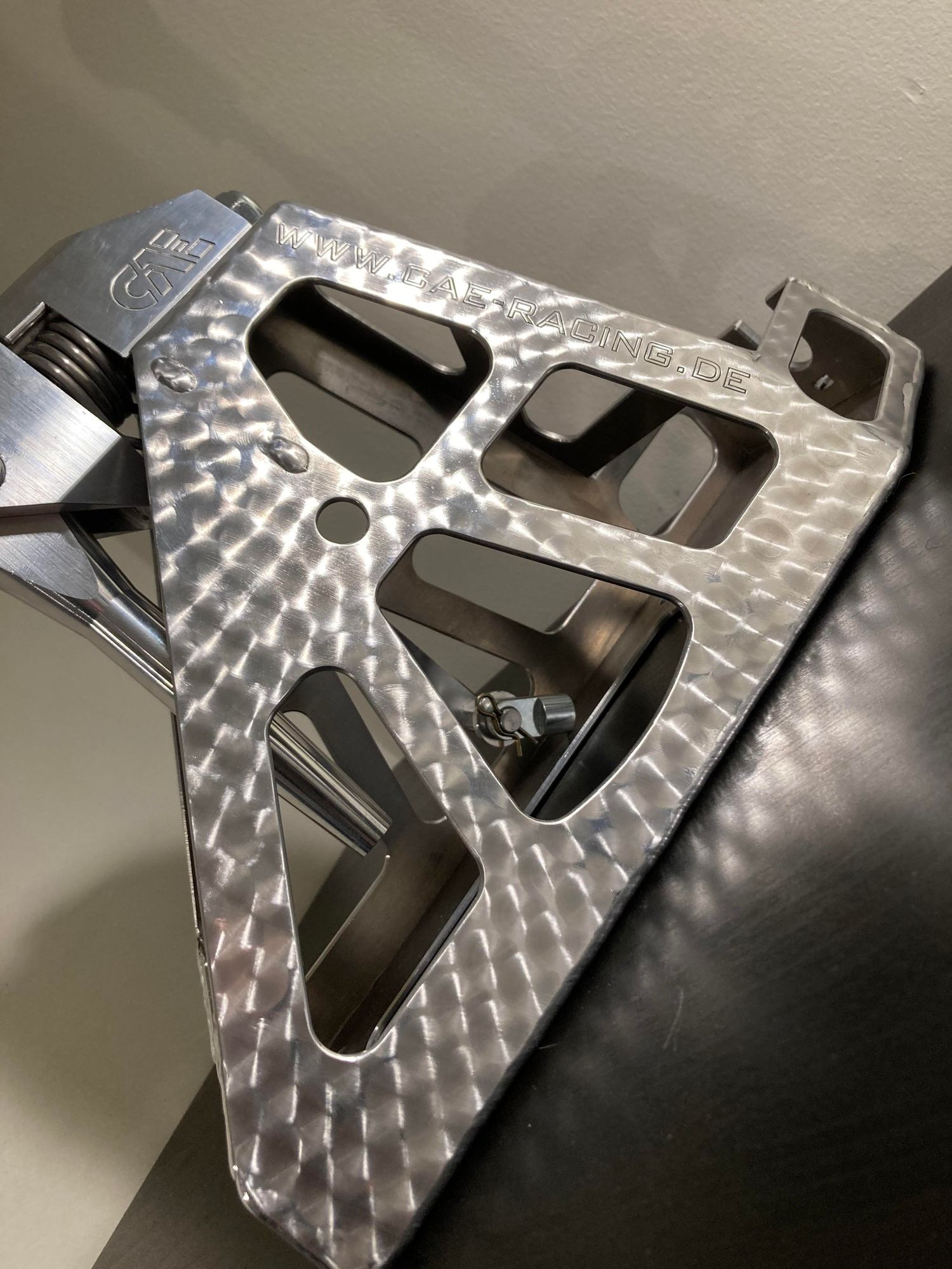

Took some time to fancy up my CAE shifter with a coined finished. Topped it off with a knock off Ralliart knob which I'm liking a lot. Finishing up the new cable setup for it as well which is something I'll be looking to offer as a future product now that the OEM 5 speed cables are NLA.

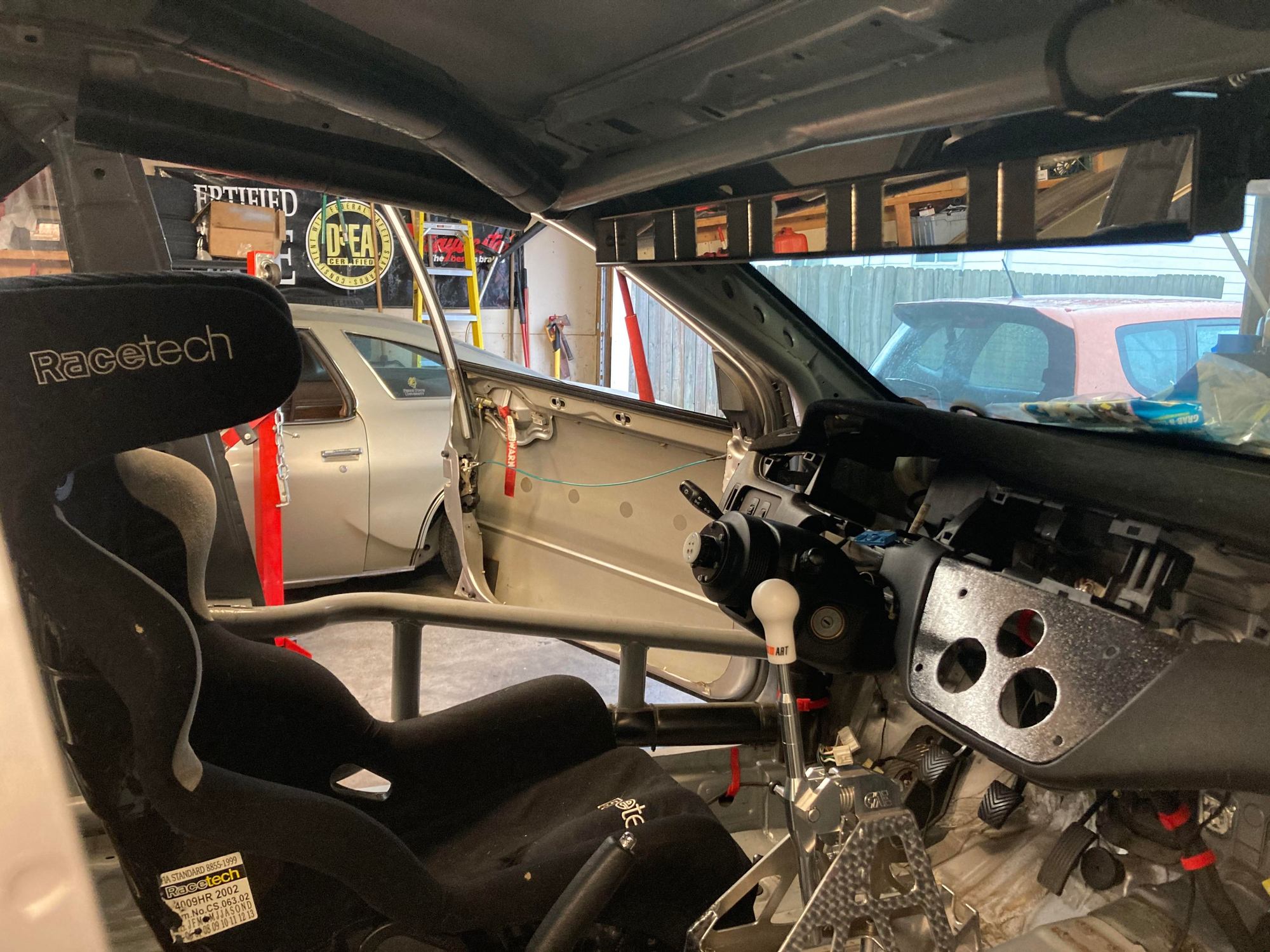

Finally mounted the wink mirror I've been sitting on for the past 4 months. I used to have a clip on wide lens mirror over the stock mirror but whenever I'd go over track curbing it'd flip down and be useless so I decided to ditch that all together and grab one of these wink mirrors. Solidly mounted to the cage so no chance of moving and leaves no blind spot, it's actually hilarious how much I can see out of it.
