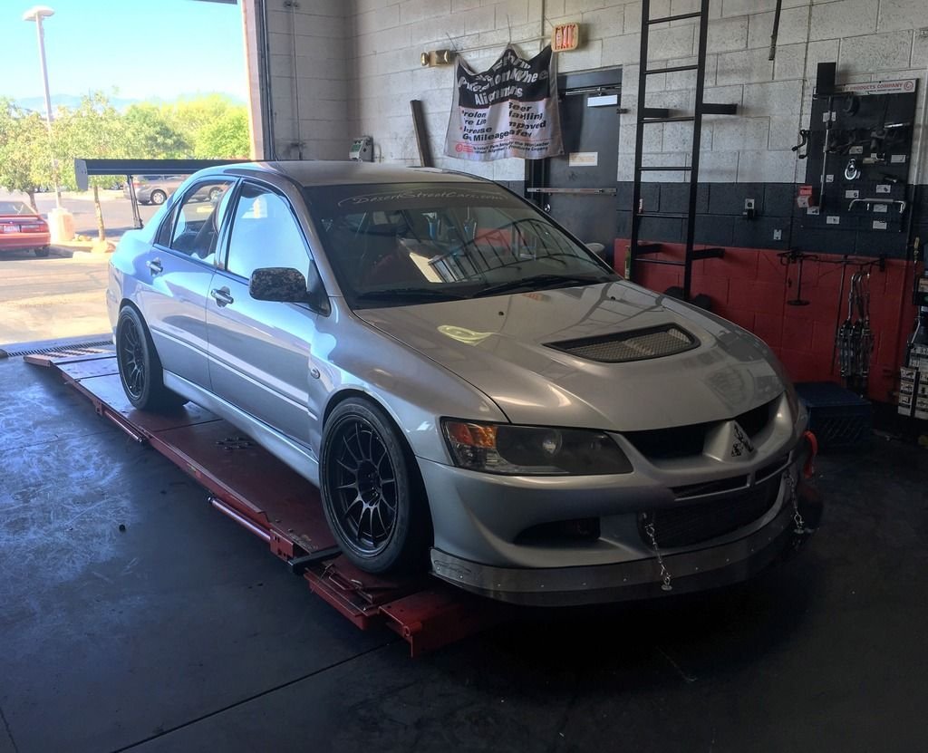

Hey guys, I'm new here. Just picked up an 04 evo 8 last week. Flew down to Tuscon AZ and drove it back home to Chicago IL. Some details about the car/mods:
- Stock longblock
- CBRD bbk-b ball bearing turbo
- ETS intercooler and piping
- ETS intake
- Omni 4 bar map sensor
- APS bypass valve
- Spoolinup coil on plug kit
- Manual boost controller
- Greddy rad cap
- Buschur turboback exhaust
- Ported ehxaust manifold
- Torque Solutions front engine mount
- Ebay special O2 dump
- FIC 1100cc injectors
- Wally 255 fuel pump
- Exedy stage 1 HD clutch
- 18x10.5 NT03 w/275/35 Victra RC1 slicks
- Ohlins flag series coilovers 10k/12k
- Technafit braided brake lines
- Binary brake ducts
- Whiteline front and rear sway bar
- Whiteline steering precision, roll center adjust, bump steer kits
- Whiteline rear upper control arm bushings
- Sheptrans stage 2 transfercase
- Wavetrac front lsd
- Sheptrans rear diff
- 10 point cage
- Racetech driver seat
- Corbeau passenger seat
- Schroth harnesses
- Sparco 383 steering wheel with quick release
- Lexan windows
- Custom front and rear crash bars
- Custom alumilite front splitter
- Kognition rear spoiler
- Defi boost and oil temp gauges, AEM wideband
I'll be using the car for pretty much everything I can. The 275 Victra RC1 slicks I'll be using for road courses, might try them for autox too but I don't think they'll heat up fast enough so I'll probably end up using the 17x9.5 w/255 Hankook RS3v2 NT03 wheels I have laying around for autox. Also have a set of RX7 FD wheels w/245/50 Nitto NT555R drag radials which I'll be using for the strip.
Right now the car has a dual tune for 91 and E85, it dynoed 330whp and 400whp respectively on a mustang dyno. I'm probably going to use this tune for tracks and autox. I'm planning on having a hotter tune made for the strip.
Speaking of the strip I went to US41 drag strip earlier this week just to see how I could do with the car as is. Only got 5 passes in before getting rained out. Managed a pretty mediocre 12.56 @117 with a 2.1 60'. The clutch is definitely a weak link as the car bogs pretty hard launching at 4k and the clutch can't handle 6k launches so getting out of the hole is definitely a balancing act. It also feels like I'm getting a high rpm lockout when trying to shift hard at 7500rpm which I'm thinking might be the clutch at fault.
My plans for the car are to try and get its' weight as close to 2700lbs while retaining factory body panels and gas tank. Currently the car sits a bit under 2900lbs. Some of the big places I've thought to shave weight are through a lighter driveshaft, tubular subframes, rear diff mustache delete mount and possibly a lighter exhaust. I still have one year of school left so I won't be dumping tons of money into it for a while but things I'm changing this season (or at least hope to be) are moving to a Comp Clutch twin disc, getting a hotter tune, CAE ultra shifter (already ordered but it'll be 3-5 weeks until I get it), possibly a tubular exhaust manifold, and maybe some GSC S2 cams and valve springs.
Anyway, enough of my jabbering. Here's some photos of the car!

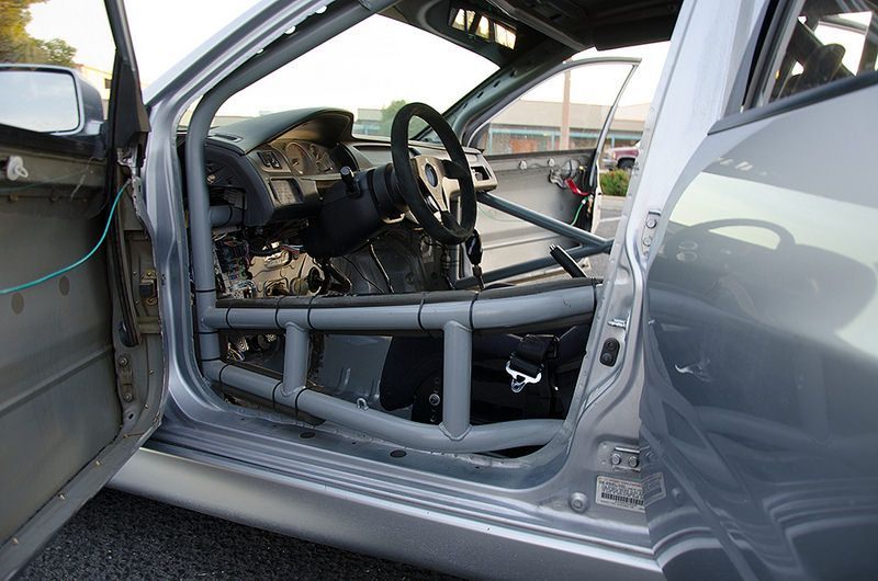

You are crazy to drive that with a full cage on the street. Please don't put anybody you care about in it.

Keep in mind, you should always wear a helmet in a caged car. Tubes and heads don't mix.

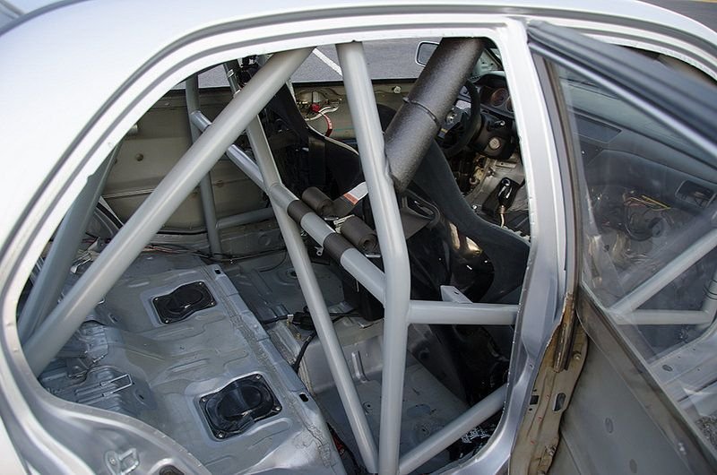

I appreciate you guys looking out for me. All tubes that are within striking distance of heads are padded. I am aware of the dangers of driving a caged car on the street.

That foam padding won't do anything to protect your bare head in an accident. The forces are immense.

Adding 1/2" of foam padding will only remove a very trivial amount of energy from the collision between your skull and the roll cage in the event of a crash. Padding the cage is only to prevent bumps while stationary and helmetless. Btw your pics are really nice, great backdrops.

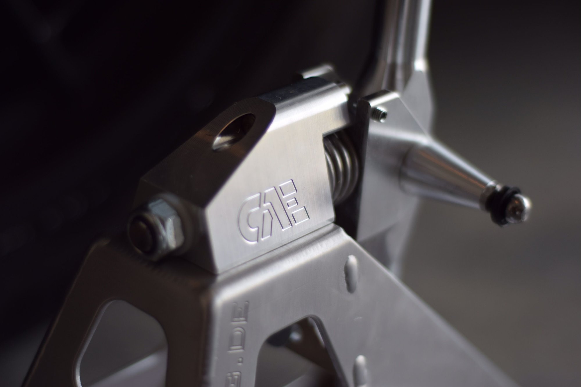

And lastly, some good news, yesterday I finally got my CAE shifter in the mail! This thing is seriously amazing. Shifting is extremely notchy and crisp. The throws are very short for how high the shifter is and there's zero vagueness about going into gear. I'm a big stickler about having a good feeling shifter and I have zero complaints about this thing, hands down one of my favorite parts I've ever put on a car.

That shifter is amazing. Post vid of it in action?

That shifter is a gorgeous piece.
