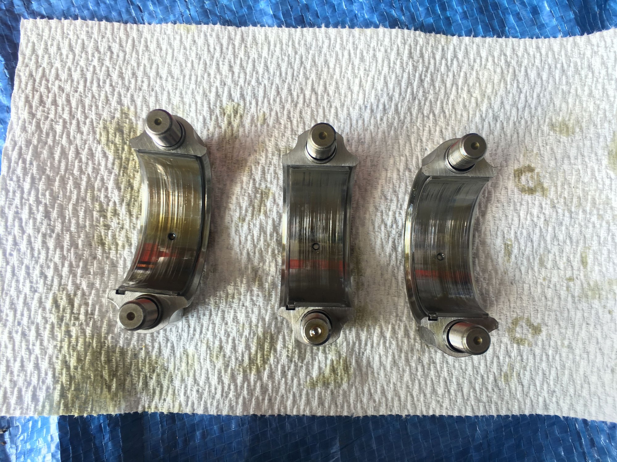

Dropped the first three rod caps off. Damage is minimal, only a bit of light scoring on the crank, none of it catches a nail so it might polish out.
Pulled the valve cover and everything is spotless still, no debris even made it up there.
Pulled the timing cover to check the balance shaft. Spins over just as effortlessly as when I put the engine together.
I was fairly sure it was the balance shaft as there are chunks of brass in the oil pan and that would indicate bearing material and the rod bearings aren't damaged enough for it to be from them. I can't imagine the mains are damaged as I never touched them and the crank has no play to it.
I'm pretty sure there isn't brass in the oil pump so I'm feeling a bit clueless right now. I'm sure I'll find the answer after I dig into it a bit more.
Update: Dropped the 4 cap. Bearing spun. Crank will need to be ground. Rod will need to get chopped and honed.
So now that I know 4 is damaged this badly the question comes down to the root cause. Right now there are three/four possibilities I can think of but I have my doubts about each one:
1- The rods weren't assembled correctly. I doubt this because I cleaned everything prior to assembly, both the bearing surface and crank were lubricated with assembly lube. Rod bolts were torqued using a stretch gauge and their torque was double checked.
2- The rods were starved of oil going through a corner. I doubt this because the corners weren't very long and there wasn't any damage in the head which usually gets oil after the rods. Also there's no damage I can see to the mains, balance shaft or anywhere else that receives oil pressure.
3- The oil pump failed. I doubt this because it was perfectly fine before and I never touched it or the front case. I think opening the pump up might tell me more hopefully.
4- The rod bearings were defective/manufactured wrong. I doubt this because it's just very very unlikely. Unless I'm really just that unlucky.
The one thing I'm most unsure of that would definitely help to find out is if all the bearings were going out simultaneously and 4 went first or if 4 was the only one going and the debris from it caused the damage to the rest.
