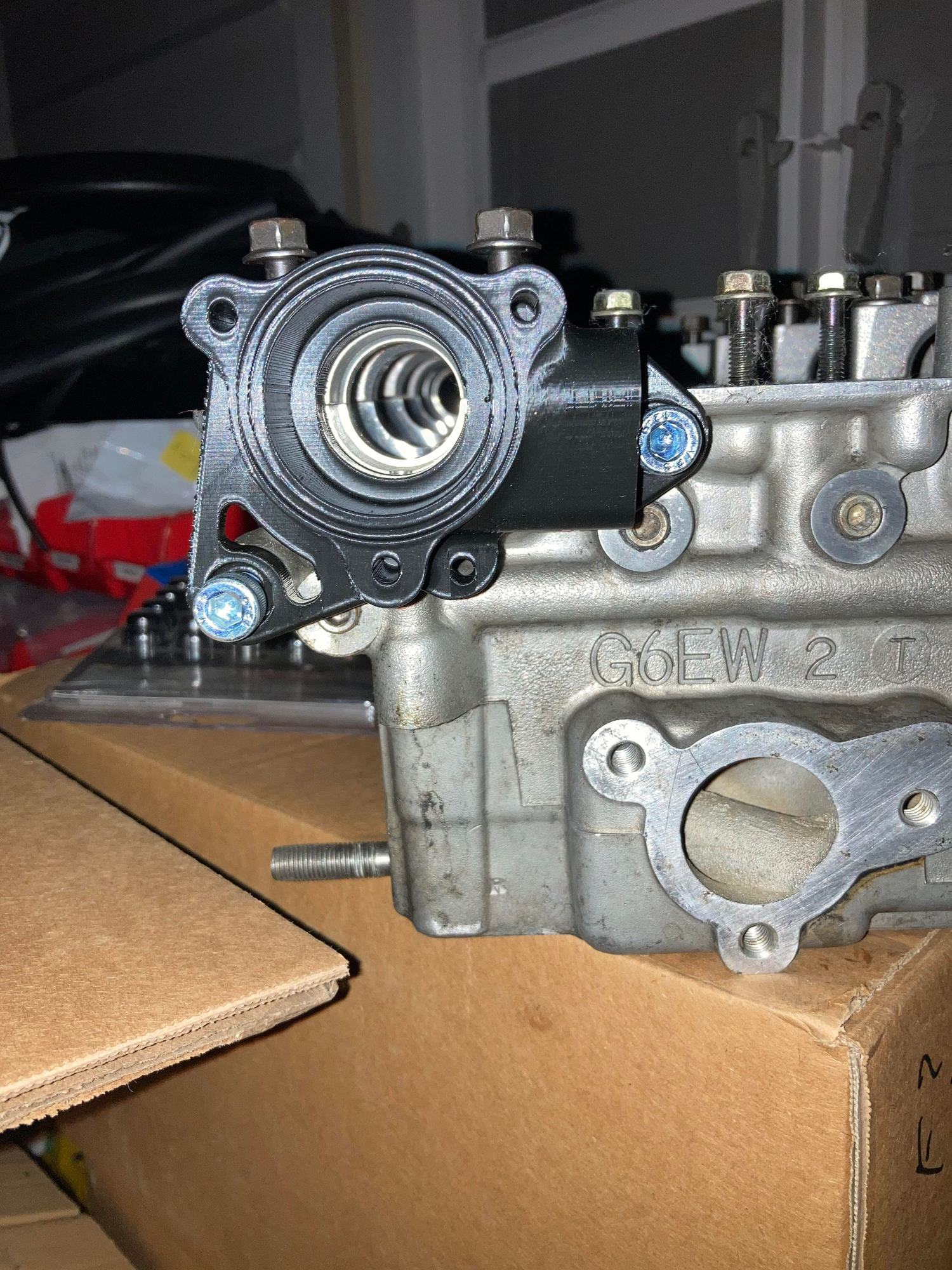

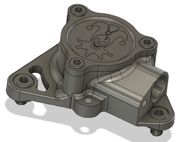

Updated and printed my cam housing design. I had some concerns about only 1 mounting bolt causing uneven compression on the o ring and leaking so I tweaked it to use both the mounting holes the stock housing uses. A slight challenge as the sensor is trying to occupy the same space but I made it work. Also added a threaded hole for the ground strap that bolts to the housing. Fits like a glove on the first shot when I test fit the print! Going to start designing a fixture for it soon.

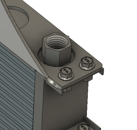

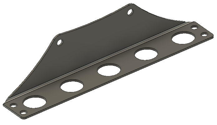

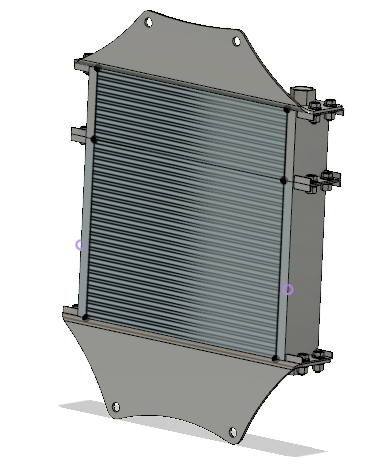

Burned some late night oil last night and hammered out the new design for my cooling setup. Buying a new oil cooler because the old one was filled with ****. Staying with the same size 25 row cooler I ran before but changing location. Also decided to add a 10 row power steering cooler as I noticed my fluid would boil on hotter days last year. So I came up with a design that bolts the coolers together and then uses brackets on the top and bottom to bolt them onto the core support using preexisting threaded holes where the condenser fan used to be.
Oil cooler on bottom and power steering on top should keep the lines short and easy to run. Coolers are on order and once I have them I can mock them up on the car and print off some brackets to rough in the last couple unknown dimensions so some of the holes will probably move around a bit and the brackets may grow or shrink a bit and I may make them wider to seal off gaps but won't know for sure until I can start putting things together with my hands, either way I'm excited for something simple and clean to come from it.
Decided to go with Koyo oil coolers. They're priced well below the likes of a Setrab or CSF but carry similar performance from what I've seen.

Is that 2 coolers then, Oil and PS? If So, I wants! I have a buddy that can get good and quick jobs done cheap for water jet and he can bend them also (I think he can bend that long). One other thing to consider and that I found on my relocated oil cooler, it needs ducting really bad. My current cooler I have a design to make but need to move first to have the space to make the mold for a carbon duct.
Yes, 2 coolers. Where the bolts are kind of in the middle are is where they meet. They're the same length, just different heights (10 vs 25 rows). I measured my car yesterday afternoon and these two will just barely squeeze into this area with a couple inches to spare for hose ends and fittings. Once I get the coolers I'll be able to check if I can get away with normal hose ends or have to get banjos to save height.
I'll definitely be in touch with you about it. My jet shop has gotten more expensive over the past year. If he can't bend it I can. I'll double check my brake but it should be just long enough to do the job, bracket is right at 13" wide. Right now I've spec'd the material as 1/8" stainless but am contemplating a thicker aluminum although bending would be more annoying if I went that route.
Ducting the power steering should be somewhat easy, maybe. Another nice thing about putting the power steering up top is it'd be easy tot make a duct for it in the upper grille. With the oil cooler between the intercooler and rad I'm not sure it'd be able to get ducted super easily but that's kind of the case for anyone who relocates to the center of the car.
