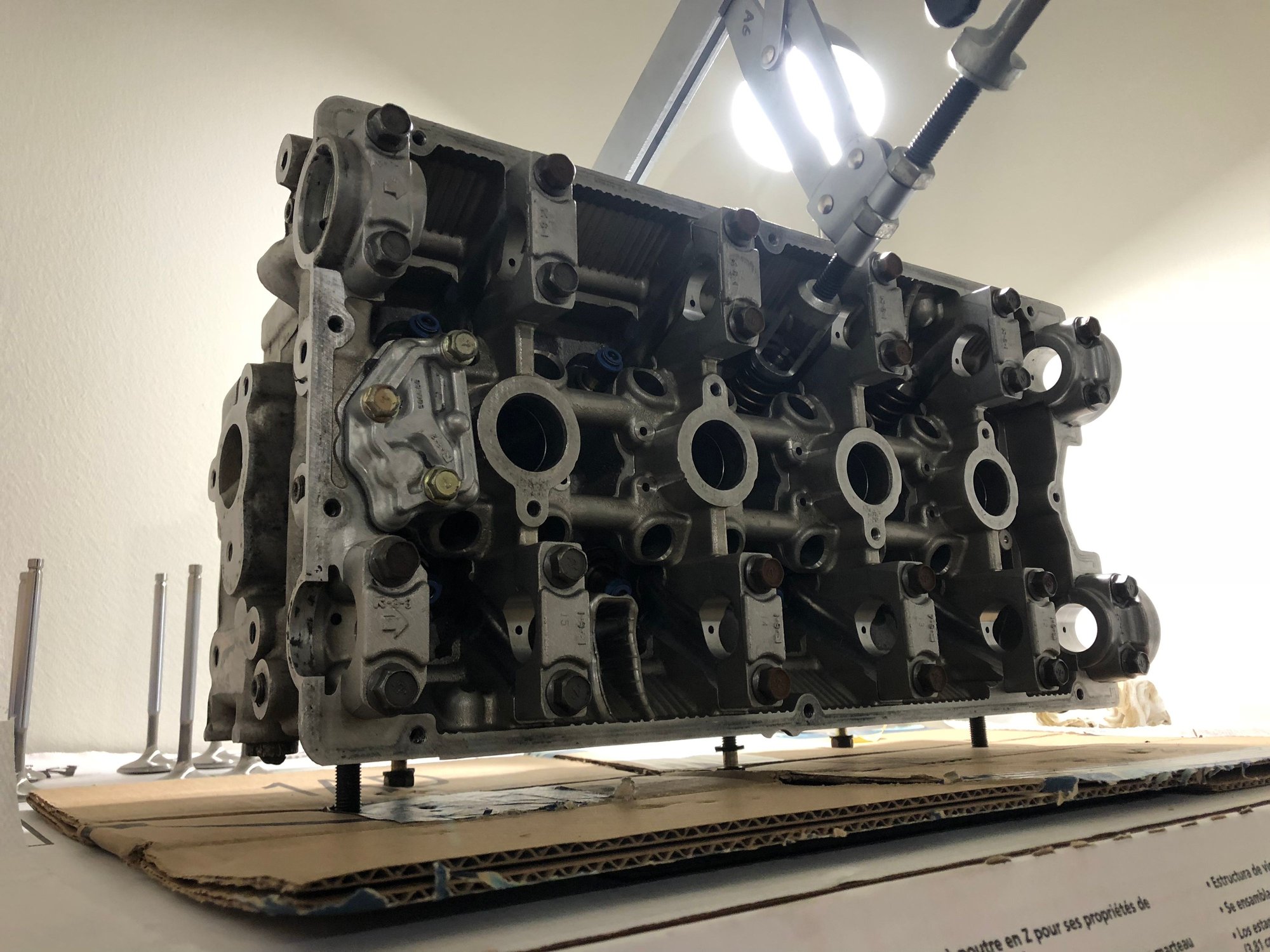

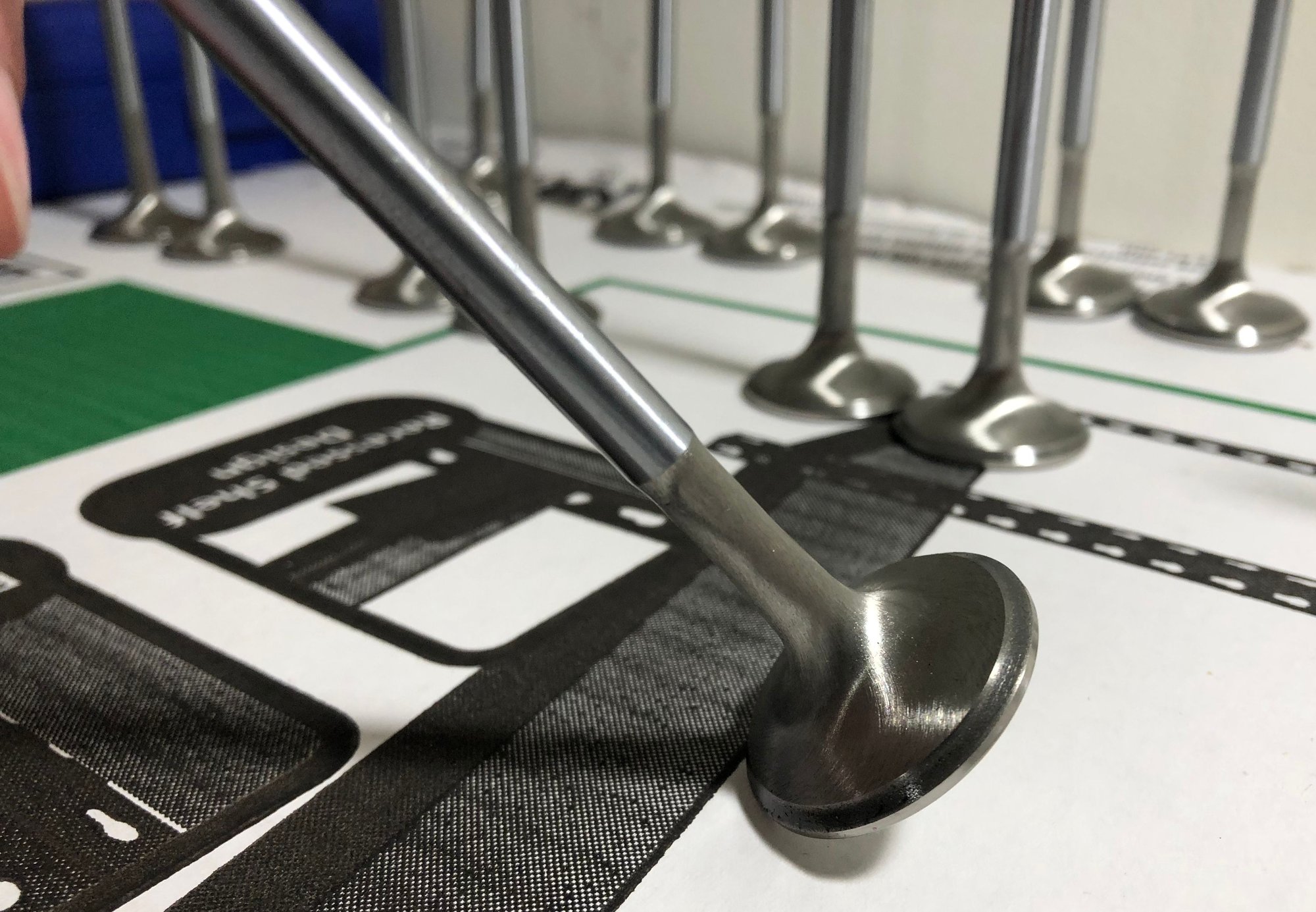

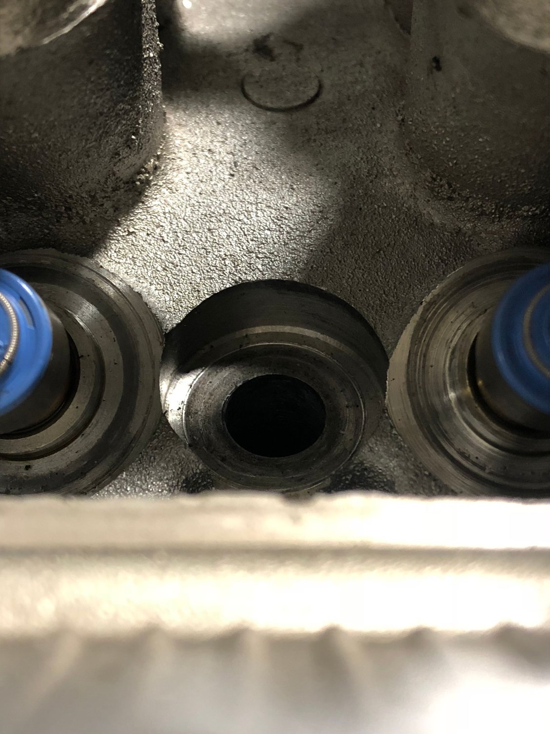

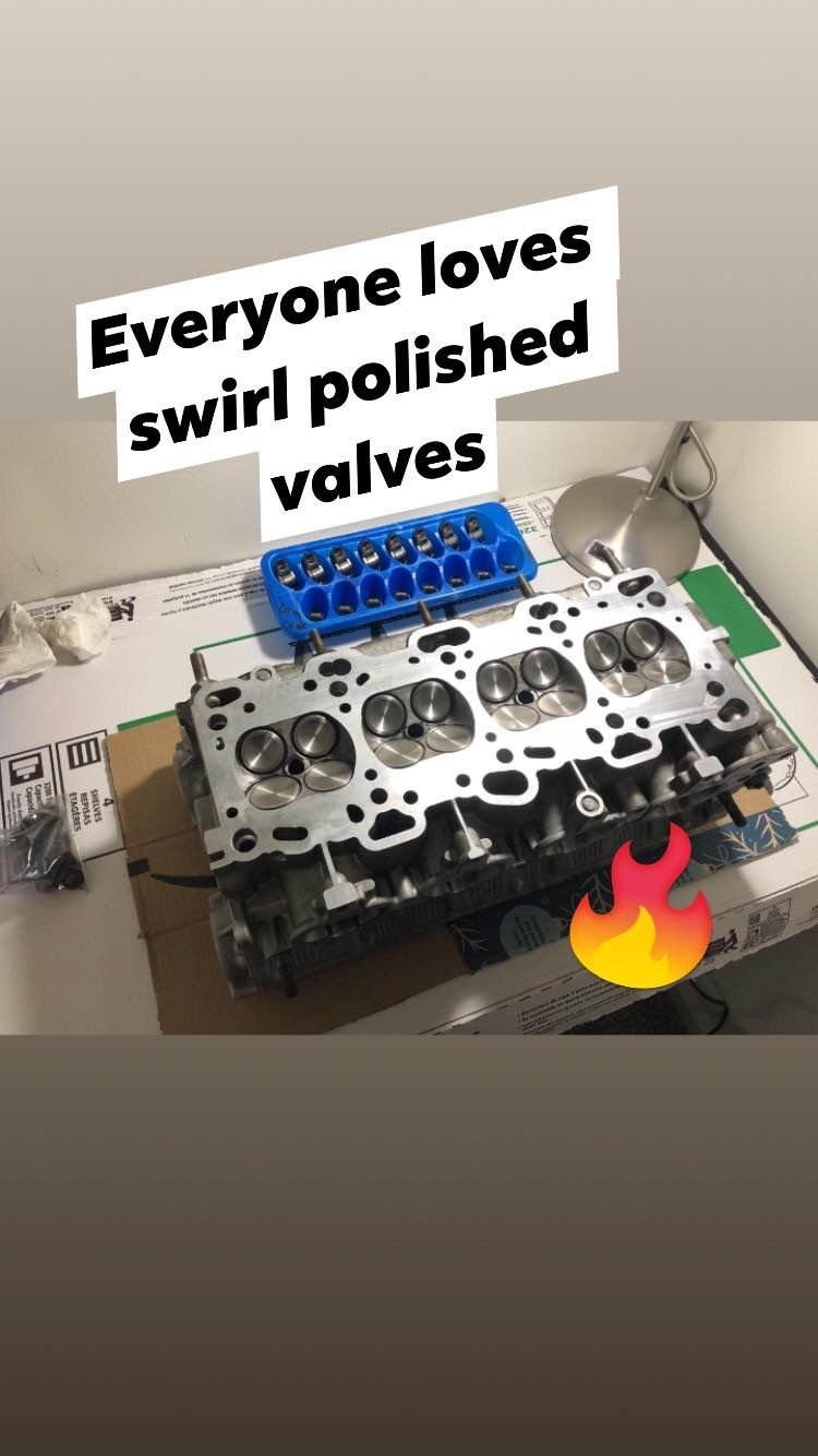

Speaking of machine work I got the head torn apart. Still cleaning it up but I'm mostly happy with what I've seen so far.
The valvetrain is in great shape. The GSC valves are barely dirty, especially compared to how dirty the ports are. The faces on the valves have nearly perfect contact with the seats. Stem to guide clearance checks out good. Spring seats all look good. Oil drainbacks cleaned up quickly.
The only issue is the head stud washers have sunk into the head about .010" so I'm going to have those bosses machined flat again and put some ARP inserts in to keep that from happening again.

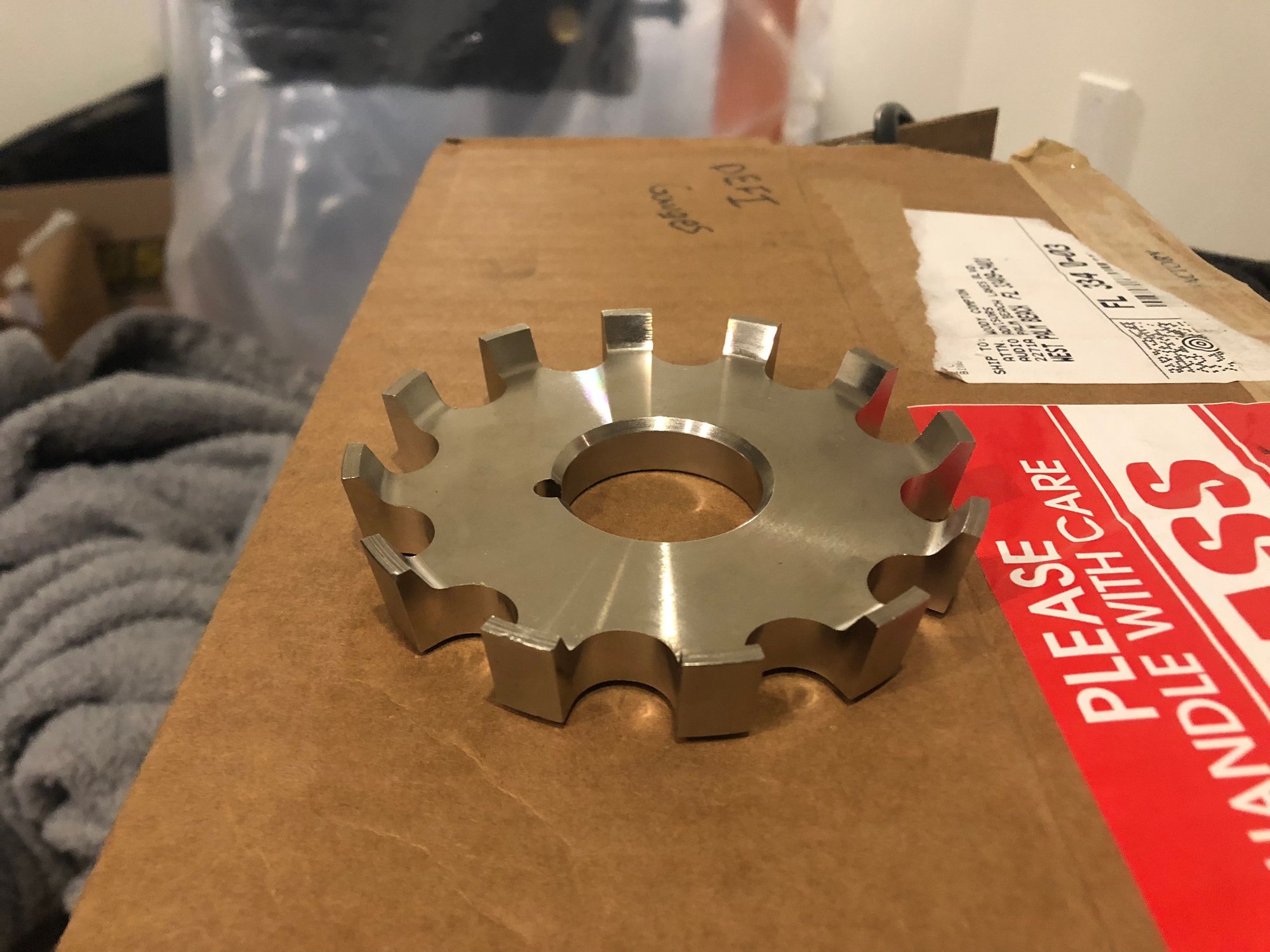

This reluctor is beefy. Big things on the horizon.

Nice, his kit looks pretty sweet. I may just pull off my crank pulley while things are apart and see if I can make my own option for crank trigger since I know I'll need it soon. You're other comments makes me wonder if I can get more resolution though I need to also research if its even useful with our ECU options.
It's nice for sure. Also on sale for $160 at MAP through tomorrow.
I like that this also replaces the balance shaft sprocket so no longer have to run that or the spacer ring. It's also looking like if I ever have a crank sensor crap out on me that I won't have to untime the motor or mess around with the timing belt to replace the sensor. I love mods that make things easier to service
And if the ECU can log at anything higher than 20hz you could probably notice a small difference in log resolution. It's kind of one of those things that's not going to be night and day but it makes a difference in the background.

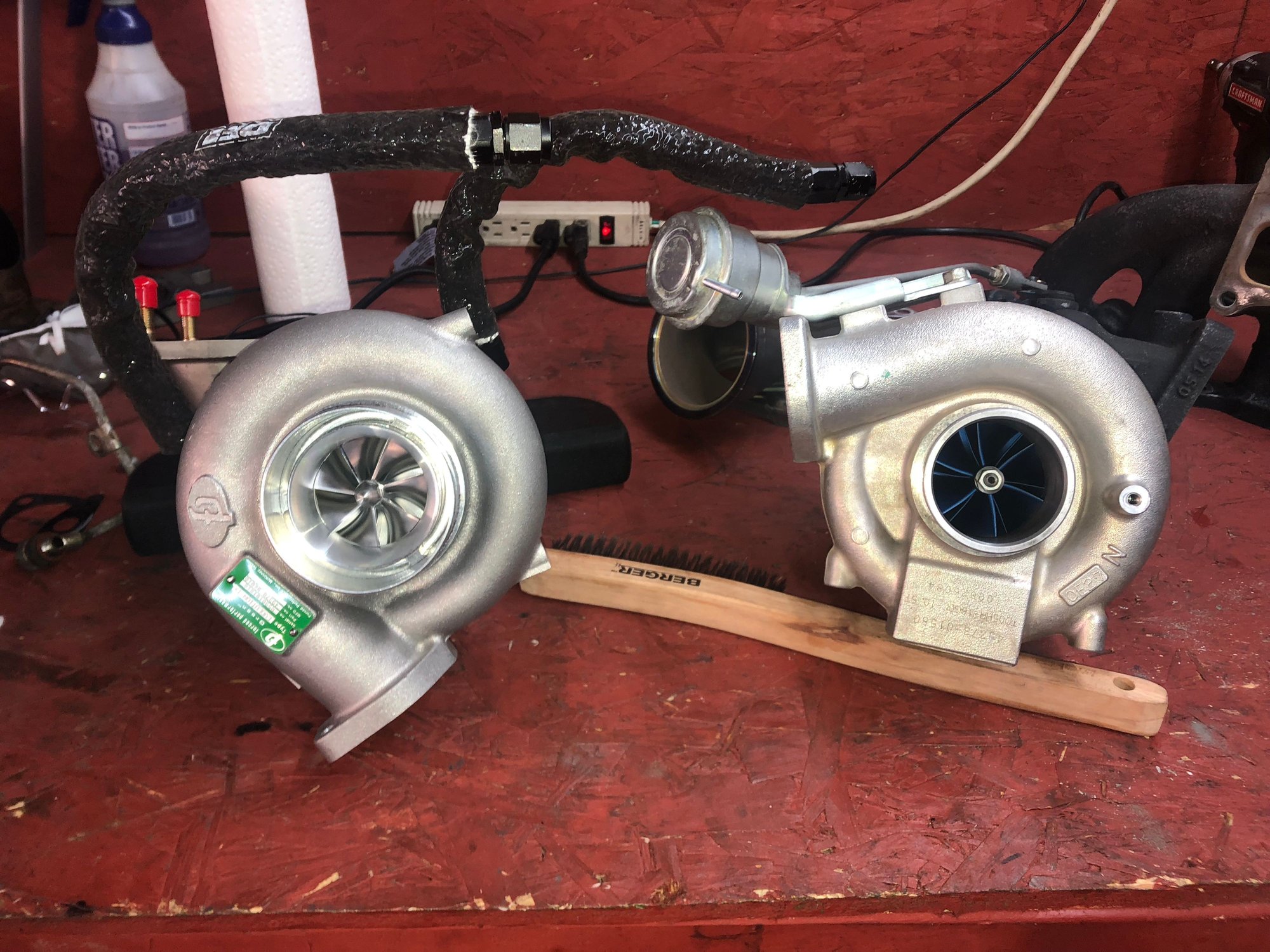

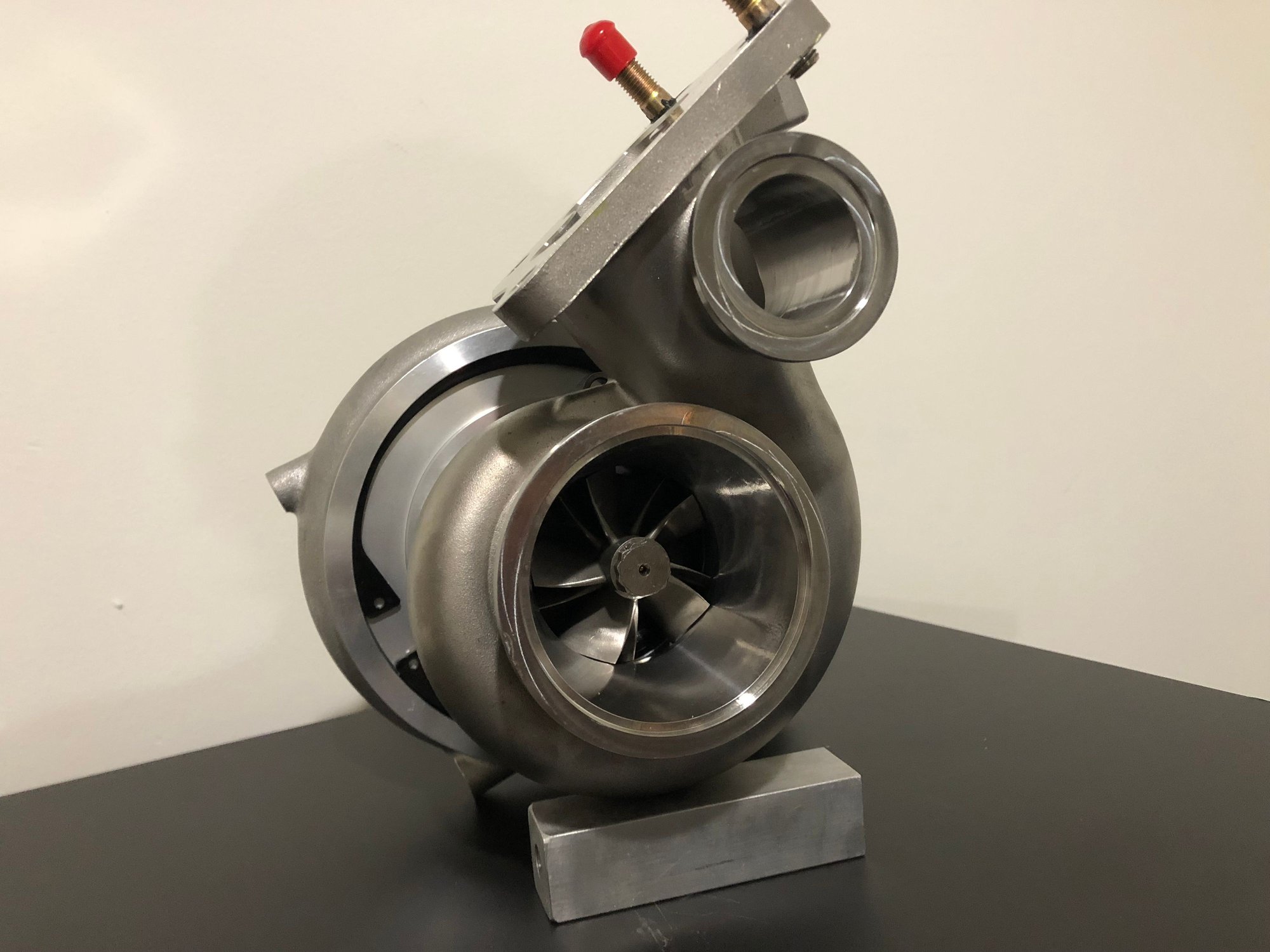

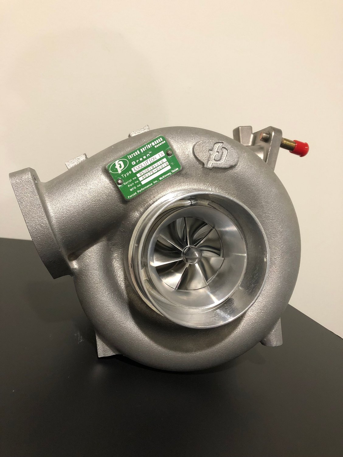

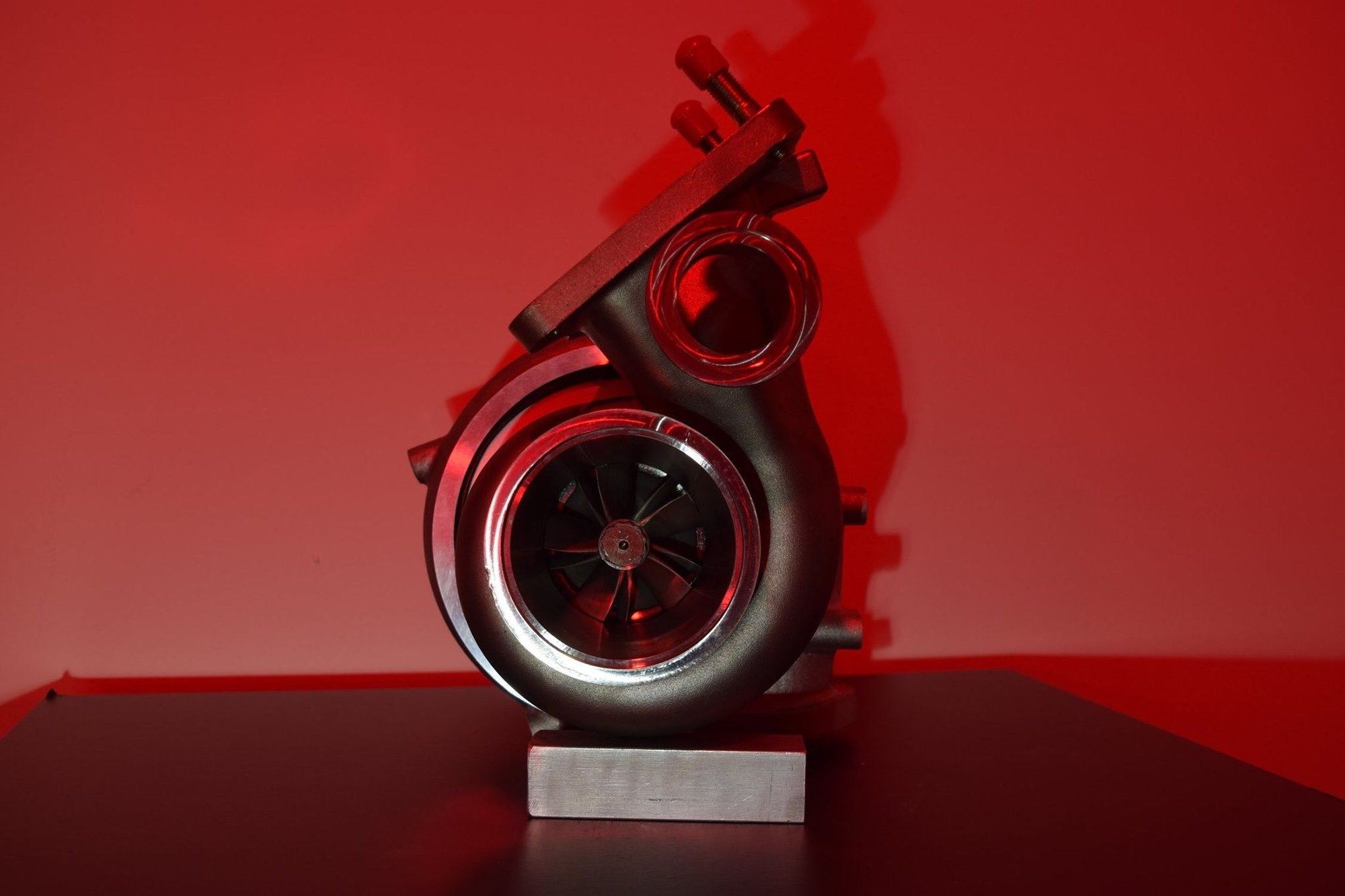

Realized I never posted about my new turbo setup. I picked up one of FP's new UHF green turbos for black Friday. Going to be mated to a self ported FP manifold and a custom 3" exhaust. Should get me an easy breezy 500whp, just hoping to not lose too much transient response.

The new UHF wheel looks great. Should be interesting to see what you think. Not apples to apples but I lost 600rpm to 20 psi on my 2.2 mivec red setup on the street going from the mhi to ss in 2nd/3rd. 3800rpm to 4400rpm Transient response/low end torque was much different. Now, the SS housing makes easier power out the top so for the road course it should be fine over 4000. The SS housing moved my powerband from 3800-7600 to 4600-8100.
I was pretty hesistant to move to the ss housing. If I have steam at 4500 then I won't mind as I don't really spend much time below that point anyway. IIRC the UHF wheel is 3mm smaller on the inducer and excuder vs the standard wheel so I'm hoping that will get back a couple hundred RPM response lost from the ss housing.
Oh dang, that's a big loss in response time. Would be ok on track but 4400rpm in AX would kill it out of at least 1-2 corners in any course.

It changed the car's character alot.
