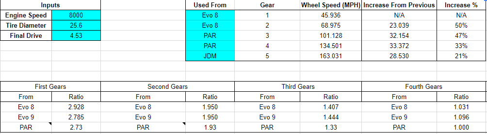

Got bored on lunch and made a spreadsheet. For anyone interested in a simple gear speed calculator that's specific to evos here you go. Just put in which gear is being used, tire diameter, engine speed and final drive (fill out the cyan colored cells) and it will populate speed. I know there's a million calculators like this on the internet I just wanted to make a dummy one where you don't need to remember each gear from what trans is which ratio. It's a calculator for lazy people like me.
https://docs.google.com/spreadsheets...it?usp=sharing
edit: don't know what's going on but it doesn't want to populate for other people, download it as an excel file and it'll work fine.
edit: read post 322 if you have issues downloading it.
Thank you for doing that Sir. I'm moving to a 4.31 from a 4.11 and its interesting to quickly adjust it.
FWIW , I ran the numbers a while back just for the difference in first gear. Feel free to add it if you would like to
Here are some examples of first gear
evo 8 first 2.928 x 4.53 = 13.263 STOCK
evo 8 first 2.928 x 4.31 =12.619
evo 8 first 2.928 x 4.11 =12.03 (this is what I have now)
evo 9 2.785 x 4.53 =12.616 STOCK
evo 9 2.785 x 4.31 =12.00
evo 9 2.785 x 4.11 =11.44

No problem, glad you found it useful. I'm still updating it, added speed spreads and percentages to give a better visual on how different ratios affect spacing, common tires sizes used on track cars, and still working on adding OE part numbers for all the guts in the trans.

I really like how things look with 1st and 2nd from an 8, 3rd and 4th from PAR and a JDM 5th. Don't think I want to fork out another $800 or so for the 3rd gear though. But being able to do 100 in 3rd would definitely be a game changer for me at a lot of the tracks around here.
Still flipping back and forth between the JDM 5th or using them from a 9, they're about the same price. The 9 is good for 176mph which I don't have enough power to get up to anyway, nor do I see myself hitting a track large enough that I'd need tall gearing. Been using the calculator to try and see about engine speed drops to help. With the JDM, shifting at 8000 in 4th (PAR gear) would bring me back to about 6500 in 5th which I think might be a tad high for my power band, whereas with the 9 5th shifting at 8000 in 4th (PAR gear) would bring me back to a lick over 6000 which I think is still pretty good. But doing the same math with the 8 5th gear would drop it down to 5700 and I know my 5th now is an absolute dog so maybe the 9th isn't that much of an improvement of what I'm looking for...

Couple things here...do you always plan to run a 275/35-18? Bc its kinda tall which will give you some speed, which I know is stating the obvious but if you build it around expectation that you will see a certain speed a simple tire swap could easily skew things.
Also, what are your thoughts on raising the limiter? When I went through the math the difference between 8 grand to 9 grand is huge! Personally that is what Im most excited about with my new motor so just throwing the idea out there to get some juices flowing on your end.
