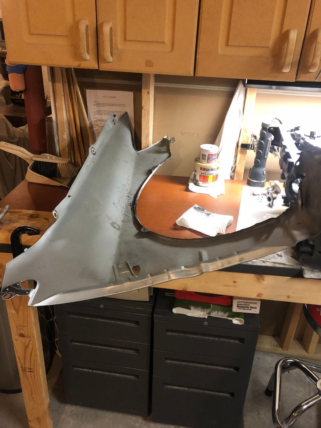

Started trimming the back of my front fenders to help vent the wheel well a bit better to decrease drag. Also going to get the lip a bit flatter which should give me a few precious mm of more tire clearance. Progress is probably going to be pretty slow until I get the engine back together.
Before
After

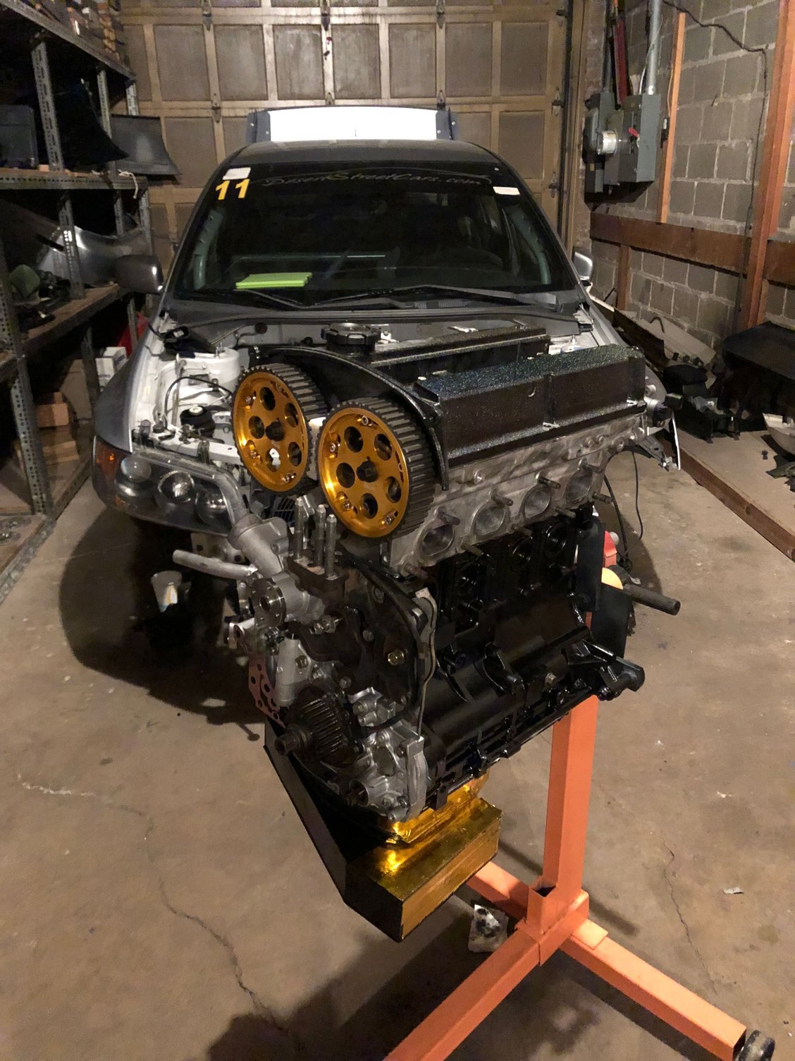

Some photos of the engine rebuild. I resprayed the block because it was looking tired. The head and block were both decked, crank was ground and the head got a valve job. It's now got Comp 272 cams, MAP beehive springs, and Blox cam gears, other than that it's all mechanically the same as before.

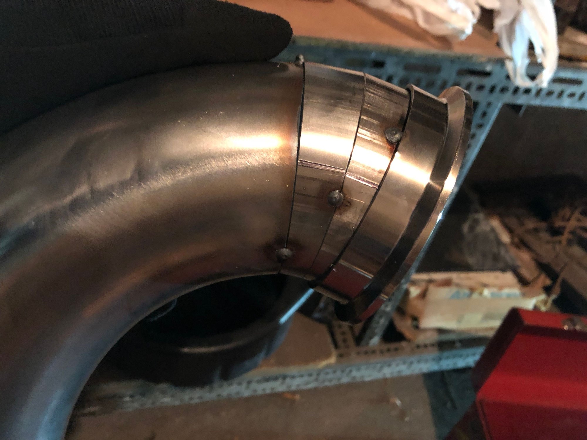

The exhaust is a custom 3.5" side exit that I made. The O2 housing is made by an Australian company called Artec. It's cast stainless, has bungs for 2 O2 sensors, and a 3.5" vband discharge. The main reason I chose to do this is to free up space underneath the engine so I can make a wet sump oil pan that will solve any starvation issue. Went with the teardrop tip to try and help point flames away from the car, I already melted one rear bumper, trying to avoid repeating that on the front, plus who doesn't like a little flair?
