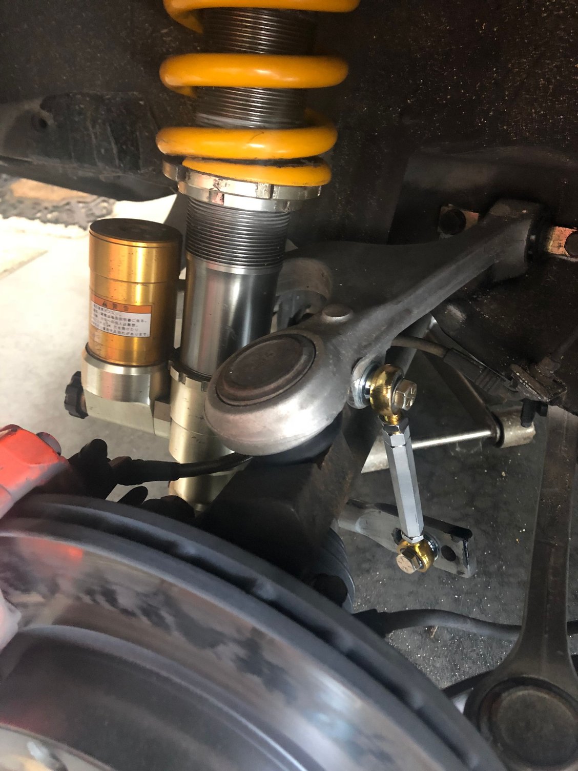

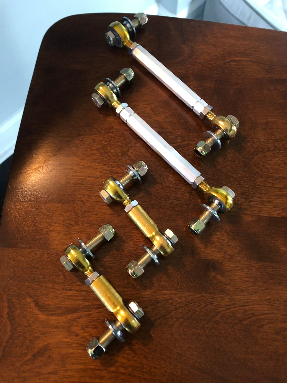

Well I got a bit more work done on the car to try and help with the understeer and the wheelhop but unfortunately I won't be able to test it out before Colorado at the end of the month.
Built some endlinks with materials sourced from McMaster Carr. With them I was able to pull all the preload out of the swaybar and set it one setting stiffer (went from soft to mid). I also pulled almost all of the preload out of the springs which gained me like another half inch of droop travel. And I finally remembered to pull my rear spacers out so the rear track is narrowed by 6mm.
Just waiting on some Cusco brackets to come in the mail so I can throw on the front endlinks and soften up the front bar a tad.

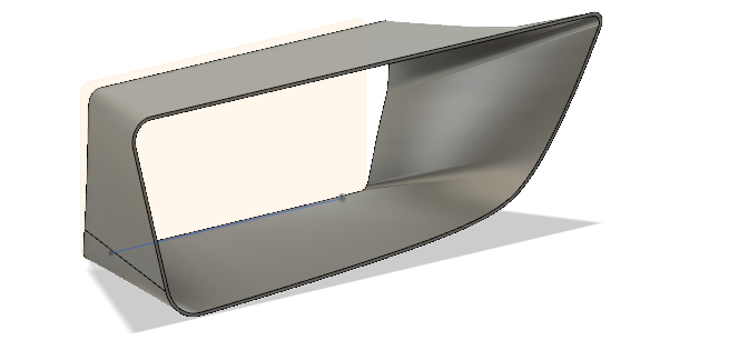

Have a small check list of things to do before Colorado but none of it is big stuff. The only project-ish thing being to make a cooling duct for the oil cooler behind my front bumper which I've already started on. Hoping to get the shape finished this week and get it printed sometime next week.

For the oil cooler duct: Are you going to print that yourself? ABS, or some other material?
