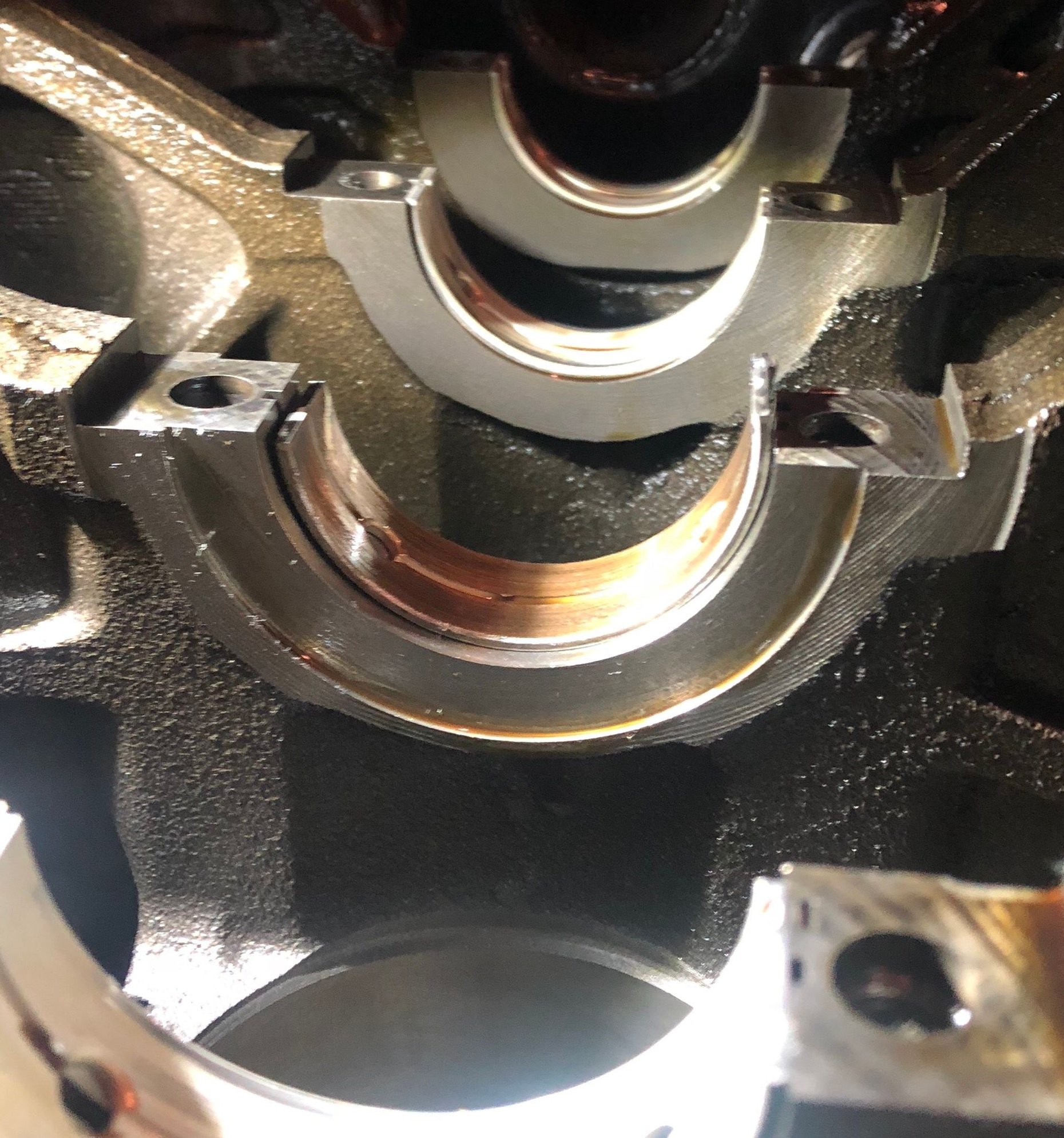

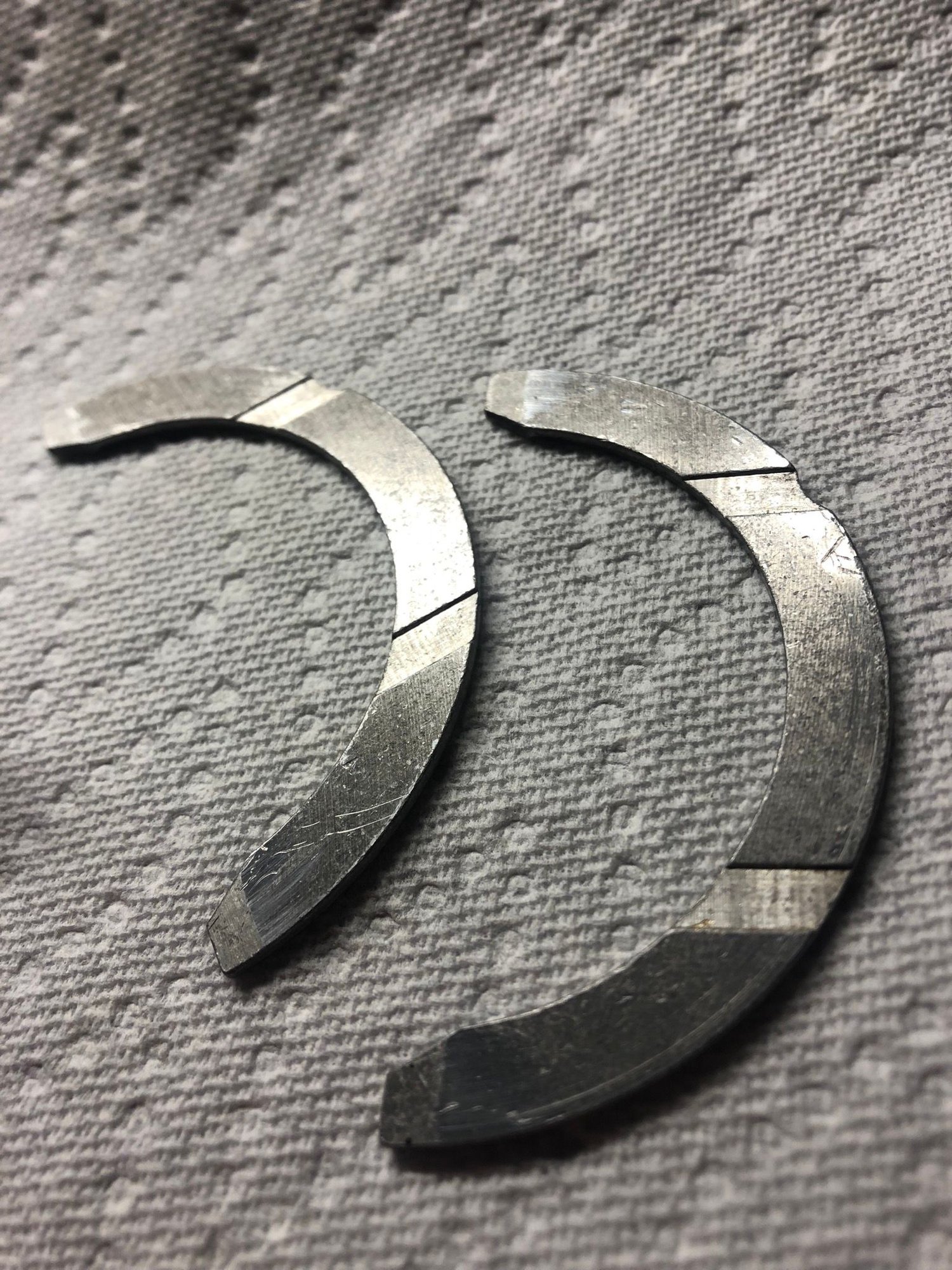

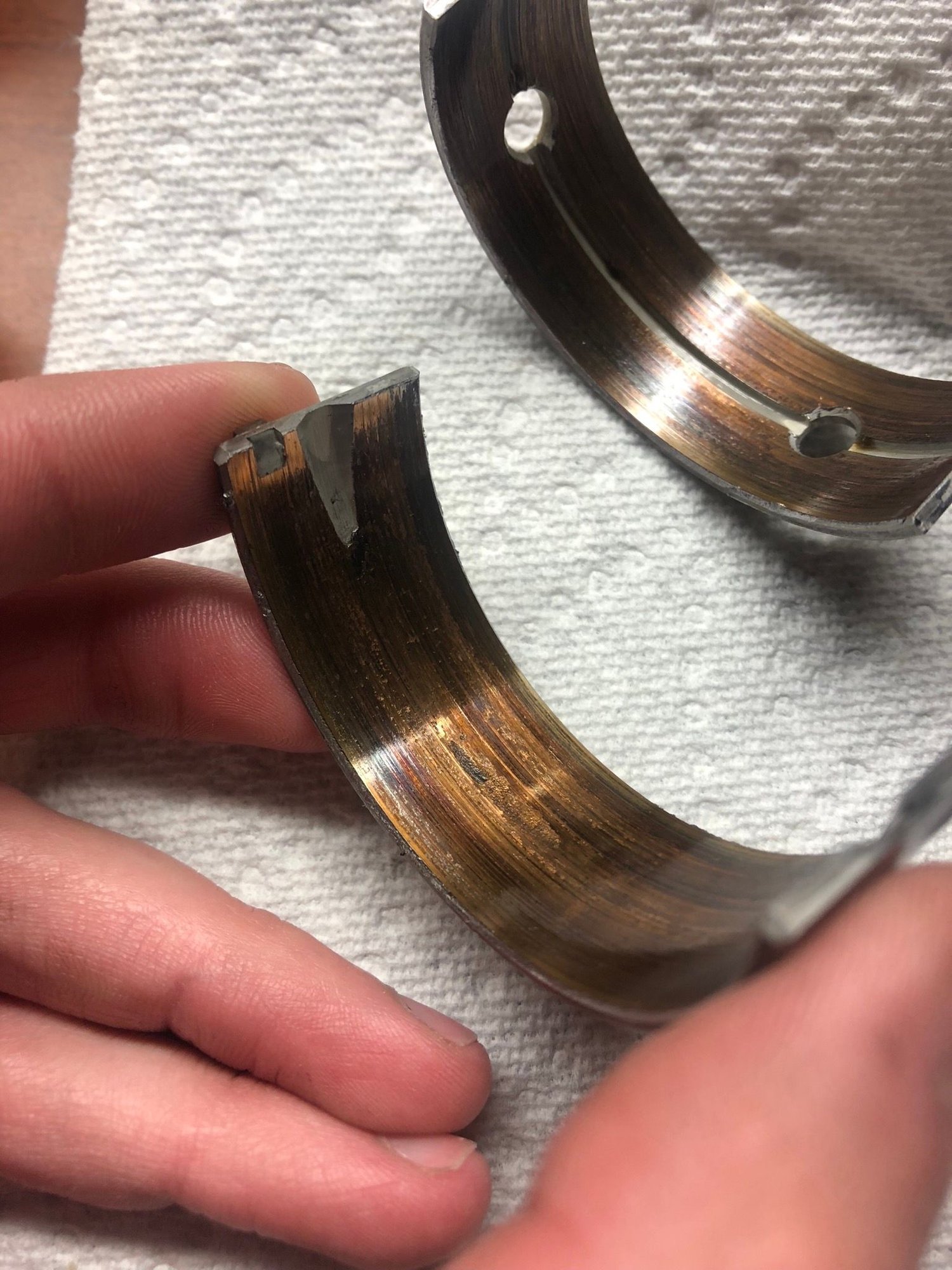

Unfortunately I have some disheartening news. I got the short block torn down Tues night to find my pickup tube making contact with the bottom of the oil pan so I'll need to hammer that out to make some more clearance but the bigger issue is some pretty extreme damage on main bearing #3. Pulled the girdle out and the bearing literally fell out from having no self retention in it and being worn all the way into the copper.
The crank has some light scoring that would clean up without issue but the thrust face also looks light it might be worn a bit and if that's the case then I'm scrapping the crank.
Most surprisingly is that the bearing never spun so the block and girdle are completely undamaged which is super relieving but I'm still scratching my head trying to figure out the root cause for this failure. The car never had excessive metal in the oil, never made any abnormal noises, never dropped pressure so it's confusing.
As it stands the only two possibilities that make sense are either the crank being bent a bit, or the mains being a bit out of line. I'm more inclined to think it's the crank and that something happened to it when it was getting machined as I never touched the block and didn't have any weird wear the last time it was apart.
So now I'm at the point I may just sell everything from the shortblock and build a 64 block since the machine work wouldn't be any different from what I'm putting into the current block.
Tonight I'm going to do some better analysis since I brought everything home and have better light to look at it under.

I thought this was diag'ed on FB, you installed the thrust bearings backwards....?
No, later that night I went home and read the FSM. I spun myself around and rushed to a wrong conclusion. They were installed right.

They were installed right, as in you took the pic/video wrong? lol
I know you said you didn't have a dial indicator setup to measure thrust, but did you at least eyeball it and make sure the crank had notable end play?
Its weird how the other 3 mains basically look awesome and 3 is fubar.

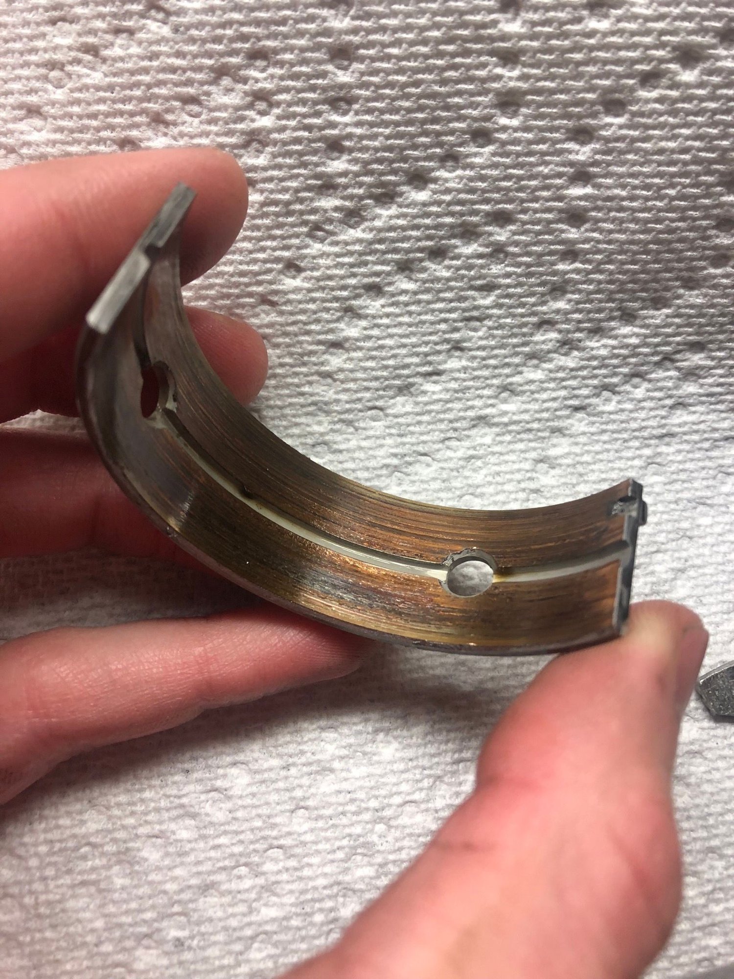

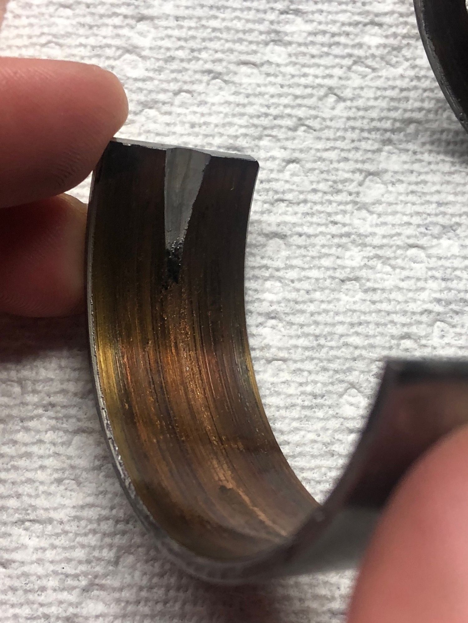

What do the actual thrust bearings look like?
Yes I have no clue what the hell was going through my head.
I did not check thrust at all. I bought everything home last night along with the main bolts so I'm going to pickup a cheap dial indicator and slap it back to measure.
I seriously don't understand this wear.

Sorry I should have clarified. I know what they look like. What did actual ones that came out of the engine look like? Did one side have wear and the other side look new?
My bad sorry dude haha. I'll post up photos tonight after I've looked at everything under a good light.

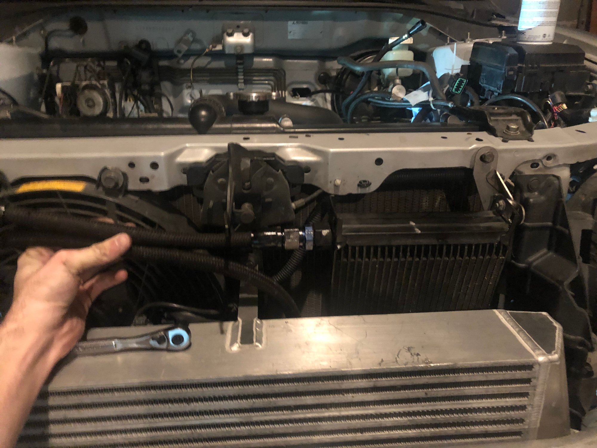

Okay so better late than never. Before i go onto the engine stuff I've got some other news. GTA released their 2019 rules yesterday and to my dismay they are allowing sequential transmissions in the limited class. So instead of building the car to fit in both GTA limited and Gridlife trackmod I'm just going to focus on building to trackmod rules. This isn't huge changes but it does mean I can remove some more weight and I can use a bumper exit exhaust which is important because it gives me free reign on oil pan design to make a wet sump that doesn't have starvation issues.
So since I'll be running a bumper dumper, I need to get the oil cooler out of the wheel well. After some thinking and fitting I was able to get it between the radiator and the intercooler next to the AC fan. Using some of the brackets from the AMS kit makes it almost completely bolt on too which is awesome. Just need to make one small additional bracket and longer hoses but I'm happy with the results. Gonna see how it does and if it's running hotter than it was before I'll rig up some sort of guide similar to what's in the stock location.
Cooler placement and hose routing:
Where it sits in the bumper:
Close bumper clearance
So back to the engine stuff. The crank isn't bent after measuring it. There's no abnormal wear on the thrust bearings. Here's some photos:

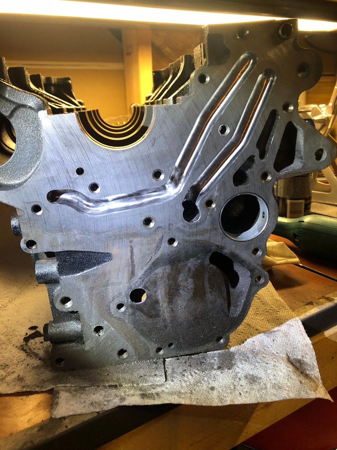

Tomorrow I'm going to spend some time smoothing out the oil drainbacks in the head as well as the oil galleys in the block. I'm also going to touch the intake and exhaust ports a bit, I think the evo head in stock trim is pretty capable so it's better to not overdo it. Once all that is done I'll get the block and head to my machinist to get worked over.

I also forgot to mention I got the oil galleys in the block polished and deburred today. Need to get a small set of needle files to finish up the head drainbacks and later this week I'll finish cleaning up the head. Here's a little before after of the block:
