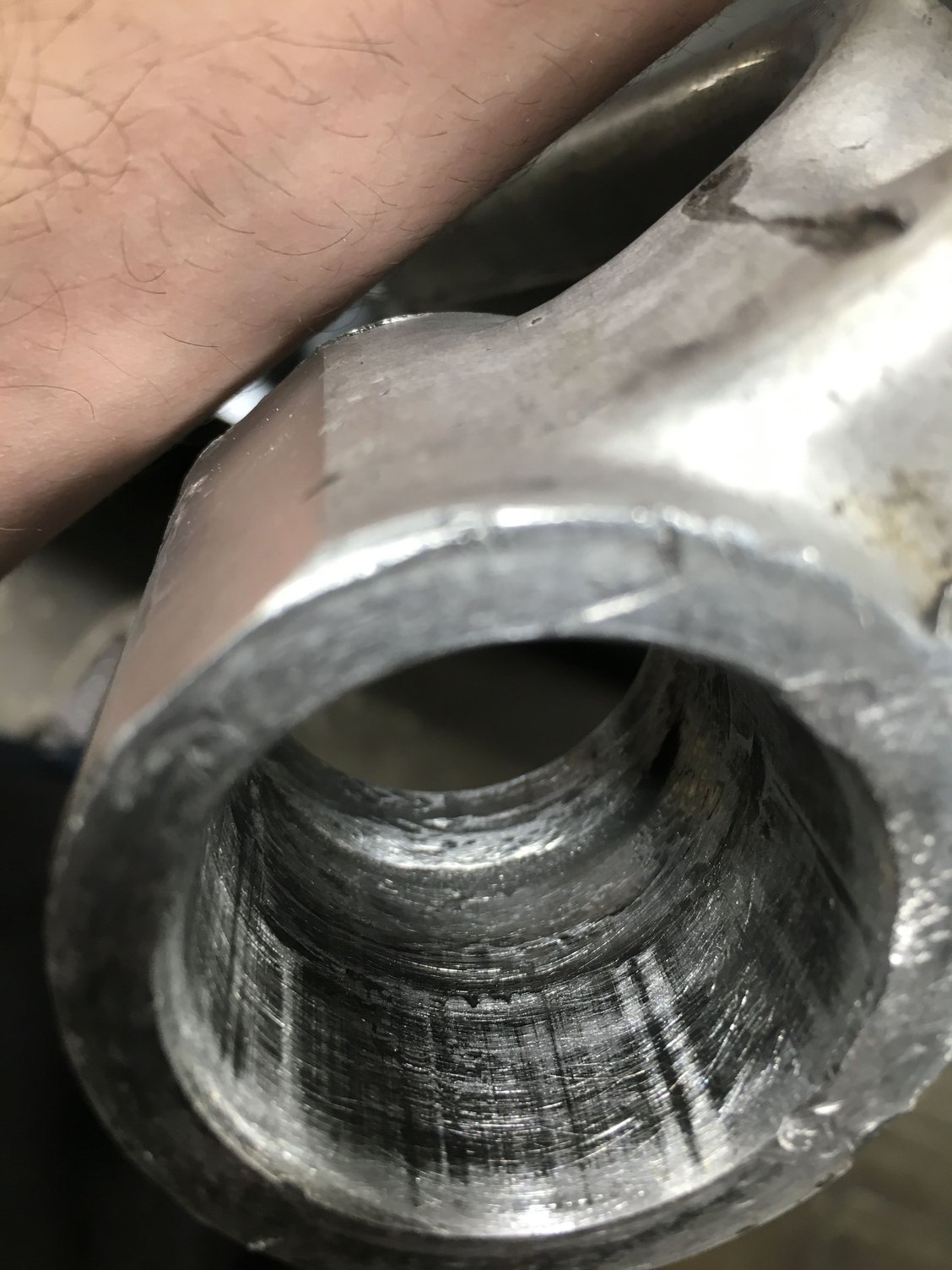

Unfortunately no. I got the rear offset bushings installed yesterday, but was greeted with some bad news when I pulled the poly front bushing out of the driver's side arm. Whoever pressed out the front factory bushing did a number on the bore. Something was drug through the bore that pulled a ton of material down and left a pretty large ridge (its the shinier area towards the bottom in the pic). So now I'm trying to smooth out that ridge so the new bushing doesn't get hung up on it. I bought some Loctite 660 retaining compound so I'll coat the bore and the bushing in that and get it pressed in tomorrow.

Smoothed out the ridge in the bore today, coated the bore and the bearing shell in Loctite 660 and sent it with the press. Took about as much force as the good bore required so I'm pretty content that it should stay where it needs to.

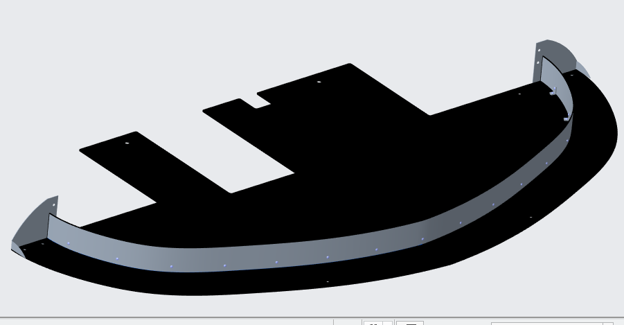

Got the design finalized for the splitter. Just have a few dimensions to double check and then it's getting cut out this Thursday. I ended up actually starting all over because I wasn't happy with how the curve I was using for the air dam fit up to the car so I measured off my current splitter to get the curve dialed in better. Still at a 5" extension, I might have a spare cut out at 6" or 7" in case 5 doesn't do enough.

I got one cut out of the 1/8" material but I'm not totally happy with how easily it bends. I'm probably going to remake it out of 1/4" material instead. When I go back to cut that I can cut you one out, just pay for material.

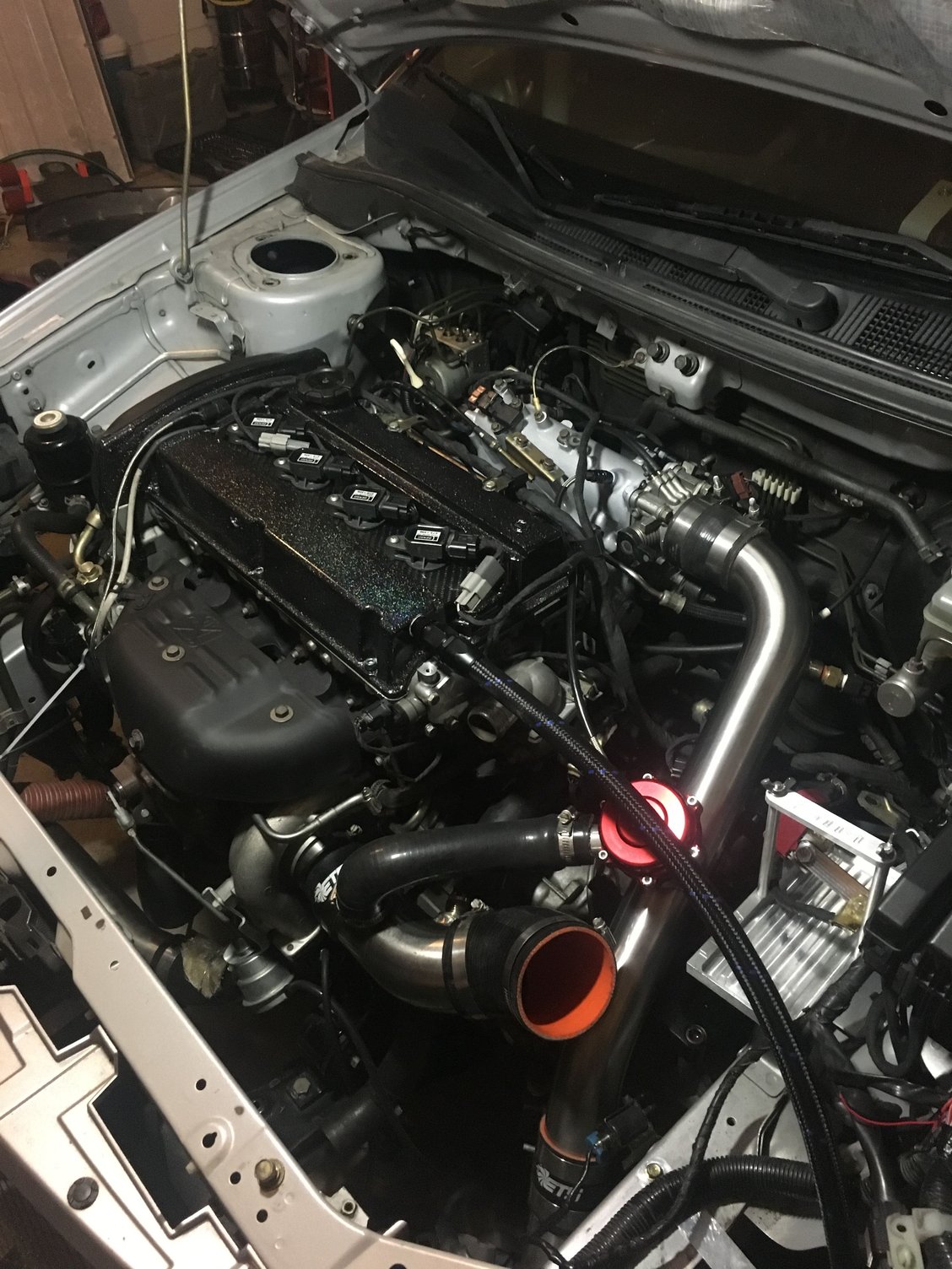

Progress hasn't been staggering and the car needs to be together by the end of this week so it's crunch time. Over this weekend I got the wiring in the engine bay done (mostly), and got everything back together mechanically except for throwing the radiator back in and making one catch can line.
The front struts have been pulled out, cleaned up and had the SSB camber plates put on.
I reloomed my wideband harness since it was covered in some tired, cracked plastic tubing. God I love woven looms.
This week I'll need to get the interior back together, get the offset spacers made for the LCA bushings, reassemble the front suspension, get an alignment, put fluids in the car, radiator, catch can line, get my tires mounted and make two more center caps for my wheels and tie up a couple loose wires. After I'm back from my spring break in two weeks the two big fish left for me to kill are getting the new oil pan made as well as the new splitter, and finishing the wiring on the inside of the car.
