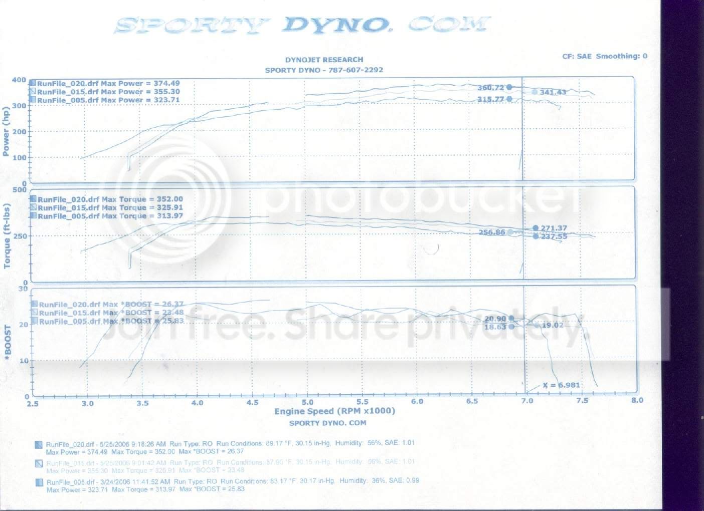

Originally Posted by MarkusEVO9
well, my mechanic and my tuner both agree that there was no valve float present. And I think the dynochart show convincing evidence that the 280 made a substantial change. In the dynochart you see 3 tunes. Bottom one was by TurboTrix. Middle one was with 280's with 93 oct and top one was 280's with 93 oct with about 2 gallons of C-12
there we go a before and after!! wow seems with the 280 cam you can rev way further and h0lding the power a lot better!!
did you dyno in a different gear from stock to the 280 cam?

From: Puerto Rico
All dyno pulls were done in 3rd gear
