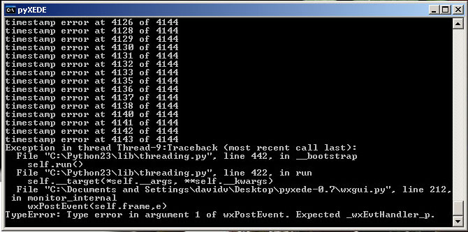

Ok well with the new release I was finally able to run a dyno run. I have included my runs, is this what I should be seeing from a stock evo 8 with XEDE?
Also I am getting timestamp errors when running my dyno runs. I also got this error after datalogging (which I finally got working) then I tried closing pyXEDE and got this.
Sort of. That curve is pretty whacky though. It's almost as if...
Hrm. yeah. Well this happens when the timestamps for two rpm samples are the same -- definitely a bad thing as samplerate is pretty slow. My timing isn't anything magic. I'm just calling time.time(). Two calls to that function should NEVER be the same. In lieu of sensical reasoning, I blame the python time module. I'll see if it works differently on windows than on unix.
EDIT: oh lord, if I'm reading the python docs correctly time.time() isn't guaranteed precision higher than the second level on non-unix systems. Let me replace it with something more accurate.
EDIT2: yep, on windows time.time() has only 1/60th second granularity. I have a patch that uses time.clock() on windows which is accurate to the usec. Although on unix time.time() will stil be used as it is much more accurate.
Ick, unhandled exception. I'll have to dig into that one. You say you _only_ got it on program exit?
EDIT3: looking closely, i think that the engine monitor thread is still sending updates after the GUI exits, thus causing the event exception. Strange...
I'm about to feature freeze the work I've done. I'll try to get the bugs out of the program and mark a 1.0 release. For the 2.0 series I'll add the networking support you were asking about.
d
Only on exit, but I did run a log before exit if that helps. Why is my plot like that? Are you saying because of the timestamp? Glad to help with any bugs and the networking thing could be somewhat useful.
Good news: I'm pretty sure i know what's causing that exception and why it only happens at exit.
Bad news: i don't know a way to easily fix it in the short term.
For now, I wouldn't worry about it too much.
I believe so. You'll notice that the basic shape of the curve resembles dyno plots posted all over evom. However, it's only vaguely similiar. I contented that there simply isn't enough information to see the features in any detail. The runs you sent me only have about 100 samples. All the screenshots I've posted are of a run on dustin's car which has about 1000 samples. Big difference eh?
So, why do you have so few samples. Well, pyXede throws away samples with identical timestamps because, by definition, they have no meaning. When you see "timestamp error", that's pyXede throwing away samples. You probably noticed that it threw away a LOT of samples. That's windows at work. I discovered that time.time() has a pretty low resolution on windows. I've replaced it with the much more accurate time.clock() (note: I only replaced the function used on windows. On everything else time.time() is far better).
