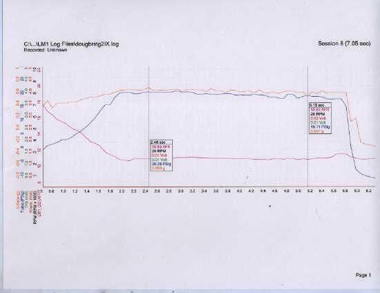

BTW - here is the data log of how the car was tuned when I tuned it
The boost was hiting 20.5 psi and tapering to just under 19 psi
As shown the a/f is a razor smooth 10.89 across the board and the G force shows the car pulling smoothly and rather smartly.
When I drove the car it was without a doubt the fastest Evo I have driven on stock cams with 91 octane.
I am 100% sure a boost leak developed after I tuned the car

Here is the data log showing that wehen the car was in my hands it was holding excelent boost
I have to teach you how to diagnose and correct boost leaks when I am back out your way
