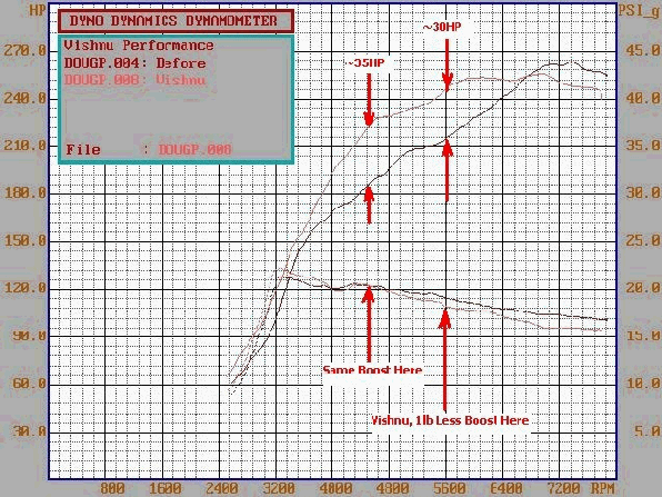

Lets look at one thing here, and nothing else, the VERY FIRST DYNO PLOT.
That's what needs to be addressed. Regardless of anything else.....
Now Al & Dave, if the car had a boost leak, would it cause this kind of power loss in the midrange? I honestly don't know, I've never dynoed a car with a boost leak before. And as a follow-on question to this. Would a car that is boosting 17lbs with a leak make that much less power than the same car at the same boost, without a leak? (the reason being the turbo has to work harder with a leak to achieve the same boost level increasing intake temps and killing power)
Can we please ignore all the hating and flaming prior to this and just answer that question objectively for me? Please?

Is it just me or does the very first dyno graph show that the car actually boosted higher the majority of the pull before it was touched/fixed/whatever you wanna call it and it made less usable/enjoyable power? How do you explain that? If the car was originally tuned at a higher boost level and then lost a few maybe 3-4 psi because of leak but still maintained a higher boost level than the after vishnu tune, it would make that much less hp and tq even with more psi? Could this be due to the fact that the car wasnt operating at the original target boost range like DB said throwing off the tune? Seems kind of wierd but i'm no tuner and notice that those are all questions as i am looking for answers. And I'm refering to the very first dyno graph. I'm also noticing that a lot of direct questions are being danced around and are not being aswered. And whats up with all the name calling?

There are several resaons for this
#1 The car with the boost leak must close the wastgate actuator tighter to generate the same boost level - thus creating more back pressure
#2 The car with a boost leak has metered air exacaping out of the turbo system which means injector duty is being added for air that is not there - -= ergo rich
#3 The car with a boost leak will not run in the proper mapping cells that it was tuned to run in and the tune is thrown off
Simply put - a Stage II car falling to 16 psi has a fairly significant boost leak and is not running properly
Only a total jerk off like Shiv would stoop to the level of trying to draw a tuning comparision under such circumstances
Furthermore, the bottom line is that with his moon dyno all the settings and corrections can be altered and adjusted to effect the results of any pull.
I was not there to observe the honestly and accuracy of the dyno testing.
The only thing I have heard about Shiv's dyno veracity is what was posted by the Preseident of Sparco USA who posted that Shiv had intentionally manipulated his air temp sensor input by placing the intake temp probe near the exhuast in an attampt to gain a hugely high ambeint temp reading of 160 plus degrees which adds heaps of power to the car.
It remains pure conjecture as to how much power would have of could have been picked up by correcting the boost leak as obviosuly no one at Vishnu was trying to help this customer resolve his problem - Shiv was trying to manipulate the situation as a marketing ploy to show how great his tuning and ideas are
I can not say I blame him - becuase evetrytime I get a car in here with an Exede on it I flat out tell the customers that its time to remove the exede and get a good reflash. The reality is that I have taken so many exede's off of customer's cars that I have lost count and there is no need to chronicle it with a giant thread every time. After, the customer from the "Tuner Transformation" show basically gave me his Exede he was so haoppy to be rid of it in Chicago I kind of lost interest in playing dyno tester with those devices.
It seems that even shiv himself has now seen the light with his recent promotion of good old reflash technology - GOOD WORK SHIV !
I hear that Shiv has broken out a fresh lab coat for his next scientific comparsion where in he will attampt to compare a Dyno Flash tuned evo with BR stage 4 minus one spark plug vs a Vishnu Stage 1A+++-+- beta . This test should be most useful.

Alright. Good observation on the boost. I looked at the end results only. BUT, if the car was tuned for 21 psi as Al said it was and then the car either had a leak OR the boost got turned down, then this would throw the tune off by a very large margin. The car would not run the correct AFR's and it would also not be running where the timing was optimized either.
Now, if you also look at those sheets the last run from Al's base tune was run #4. The "first" run that Shiv did was run #8. Hmmmm. That's 4 dyno pulls in between. Shiv is a good enough tuner, and he said he tuned it, to gain that much power in the mid range from a tune that was off from being out of it's prior tuned range.
That's my opinion.

Seriously though - I am being serious - Shiv - did you remember to pull the handbreak on that first dyno pull or was the car really making 45 less TQ than WHP???
Guys - you all have seen hundreds of dyno sheets posted of my tunes by myself , my customers and other shops
When have my tunes ever had such weat TQ in comparsion to whp?
There was something really wrong going on with that car

All things being equal, wouldn't a car with a boost leak run at the same AFR or richer in the high end? Something else going on here.
